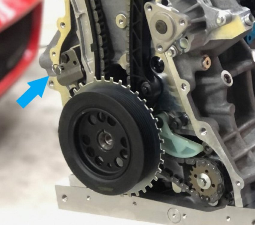

JohnCh Posted April 12, 2022 Author Posted April 12, 2022 Looks like it and it even appears to have the port for the timing chain tensioner pin. And it's cheap! I paid a lot more than that for the used one and the best price I found at the time for the Mazda version was over $200 new. -John

JohnCh Posted April 13, 2022 Author Posted April 13, 2022 Andy, I wasn't referring to the alignment pins that locate the cover to the block and head. Rather, I meant the port over the timing chain tensioner that allows you to insert the pin that holds the plunger in place (see blue arrow). Every cover I've seen has this port with threaded plug, but Esslinger made a comment that they like that Mazda cover because it has this feature. I interpreted that to mean not all covers include it, but that could be wrong. It seems odd that would not be universal. -John
wemtd Posted April 13, 2022 Posted April 13, 2022 I have 2.0 timing covers with & without the tensioner access ports.
JohnCh Posted April 14, 2022 Author Posted April 14, 2022 Interesting. That confirms Ford either made a running change at some point or decided certain Duratec installations didn't require the port. -John
papak Posted April 17, 2022 Posted April 17, 2022 (edited) I have one with the port on my 2.3. I bought it from a disassembler online. The invoice shows it to be from a 2015. I had screwed up the threads for the alignment screw below the crankshaft. I'm not sure of the point of it if the cam timing is resolved before then cover is installed. Edited April 17, 2022 by papak
