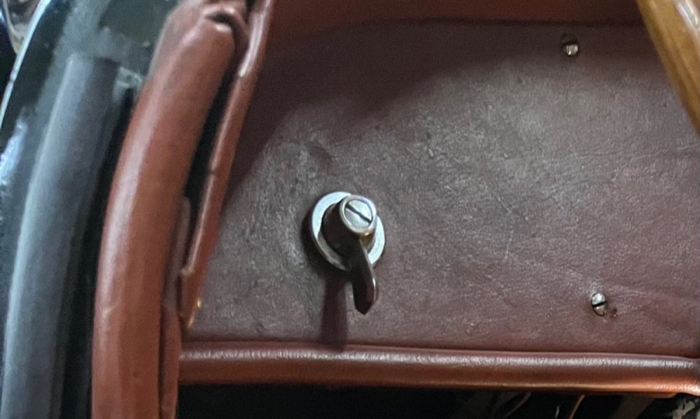

IamScotticus Posted January 26, 2022 Share Posted January 26, 2022 (edited) Yes I said it. Trafficator. Traffic + Indicator = Trafficator. They are those mechanical flags on the 50's European cars used to indicate your intention to divert your current directional course. They're a hit at auto shows. Although the Seven never got Trafficators, the early 60s cars often got the switches, along with various other Morris & Triumph parts. Indeed, the prince of darkness ruled the world in those days. So why am I bringing these up? Well for one thing, Caterham was still using Morris parts as late as my build, 1996. I'm still trying to find the origins of the hand brake...So why not add another charming Morris part? This led me to investigating why this particular indicator switch was used. I found out it has a built in timer! Vacuum operation and adjustable! Typical English, over engineering things! A red Lamiplate instrument panel is required, of course. So is this self-canceling switch better than the toggle lever switch that we invariably neglect to cancel? Edited January 26, 2022 by IamScotticus Link to comment Share on other sites More sharing options...
John B Posted January 29, 2022 Share Posted January 29, 2022 My XK140 has one and it works great. It's an odd little device though, it's vacuum operated with a leather diaphragm inside. Link to comment Share on other sites More sharing options...
