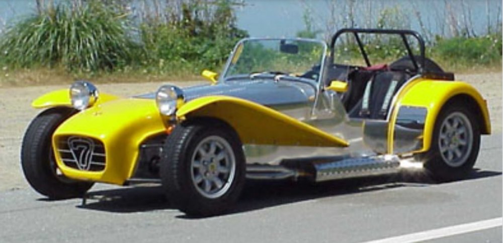

One thing I really don't like about the FIA roll bar, is the FIA roll bar.
I mean, for a road car, its a bit bit much, the angle and all.
I don't intend to race, and I understand its a valuable thing, with Petty strut and all, but, I would prefer more of a DeDion style.  There never were many options for live axles, the dune buggy and the FIA.  Its when the metric chassis came that the roll bar options opened up.
So what I wish to propose to the forum is 1, a trade for something else, or 2, have welder chop and fab from the FIA?
The option I really like is have a jig made and fab up a new bar from scratch.  I would have to farm that out to someone I can trust.
Any ideas?

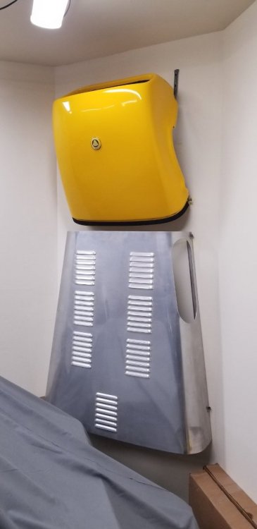

The only 7 progress is making hanging storage for the nose and bonnet, a huge improvement.  Since my garage faces the street, everyone gets to ogle.

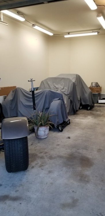

Gentlemen,  I present a Seven in a garage....Where I live.
No, Im not going to show it off now, its a basket case!  All the wings are off.
All built up she is this spec:
But with an FIA bar, which I detest.

Hear hear. I ended up with finding my 7 at the right time in my life but it was certainly more of a financial stretch than a lot of others. Not a big deal as it's not a competition but it's easy to feel out of your element at something like a track day. At the end of the day we are all united in the fact that we love a dangerous, visceral, basic old roadster.
Why the hate for the FIA bar?

I an primarily a road blatter, living the romantic fantasy that this is somehow a sensible road car, if a road car at all.  So, tracking is not my goal.  Making a better absurd grocery getter, is.
Therefore,  I aim for two goals, authenticity to the road spec,  and good looks.  I think the fact that the Seven is a pretty little thing is most of its charm, as evidenced by the drooling and gushing you get from the admirers, everywhere.  You know someone did something right.  Every little detail of my car needs to live up to that standard.  A hard thing to keep up with, know.
Then there's my issue with the FIA.  Its functional,  but not minimalist.   The form dominates too much of the car.  And a full roll cage even more so.  This is where the purists and the engineers part, form or function.  Ive seen several ways the engineer will butcher a Seven's good looks with his idea of an improvement.  To him, the seven is just a race weapon to get him another trophy.  There's nothing wrong with that. Nearn required his employees to have track time.
The FIA bar isn't the worst example of bad taste,  but its very clear it is a racing item and you're going to ring your bell on it if you're not careful or not wearing a helmet.
For the pretty road car, the Dedion roll bar is what Im after.  Cat never bothered to make it for the live axle cars.
Cat made it for the 160, but it won't fit my 96 LA.

I didn't like the FIA bar but for different reasons. I didn't like the asymmetry or the fact the side bars were vertical and not sloped inward towards the center  so I got the double diagonal instead.
If removing it is your crux and replacement is not available seems simple enough to a metal fabricators to delete it and to get it repower coated.
Edited by Vovchandr
I can remove it, I can run without it...
I can have a fab man weld up a new one built on a jig based on the FIA.
Black is the spec.
I dislike powder coating too, for these applications.  POR15 or equivalent.

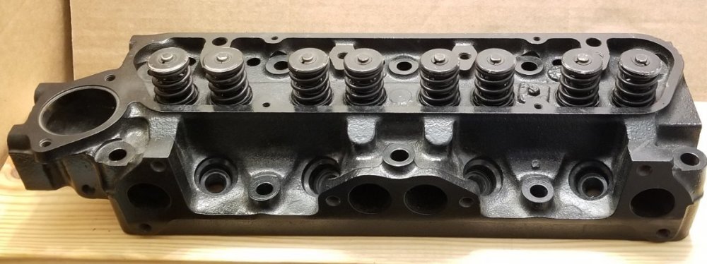

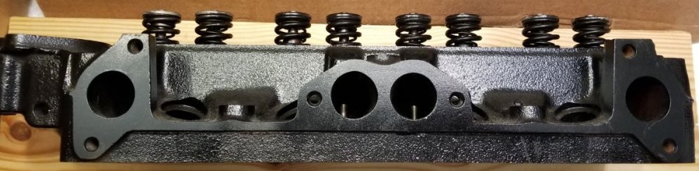

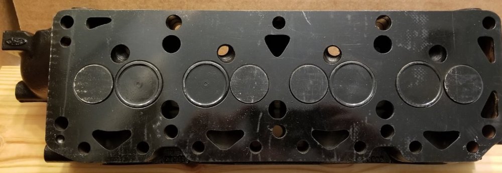

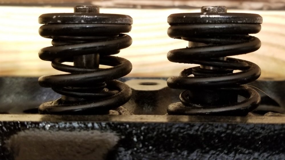

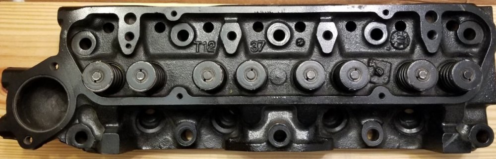

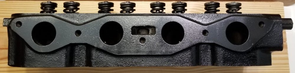

Here is a Xflow head Ive had sitting around for 15 years.
I bought it built to this spec.
About 10 years ago i gave it to a marine boat engine man to install new valve seals and whatever, which it probably didn't need.  It was all bare metal then.  The engine man painted it with a thick coat of black.  I think he knew this heads future waz to sit for the next 10 years and a coat of paint would keep the rust off.
He was very right.
However, as I look toward my Xflow refresh,  its possible that head might go on.
So, what do I have here?
It looks like a ported head with double springs and maybe larger valve stems.  I don't see bronze valve guides.  I dunno about that.
I do know that I don't plan on doing any cam and piston swapping so the A2 cam and standard 1600 pistons stay for now.  Are dual springs necessary?

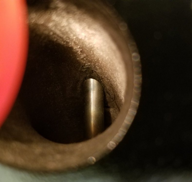

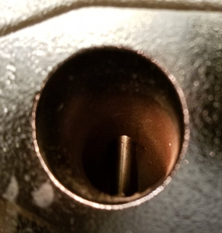

In the porting, #1 and #3 exhaust broke into the head bolt holes.
Install a sleeve?
What else does this head need to get ready for road?
Of course I wouldn't put this on without cleaning it up first.  I'll give it to a shop to dip, flux and face.
Measurements:
intake ports: 1 3/8
intake valves: 1 5/8
exhaust ports: 1 1/8
exhaust valves: 1 3/8
valve stem tops: 5/16
weight: 35 lbs
porting incursions:
ex # 1
ex #3
Edited by IamScotticus

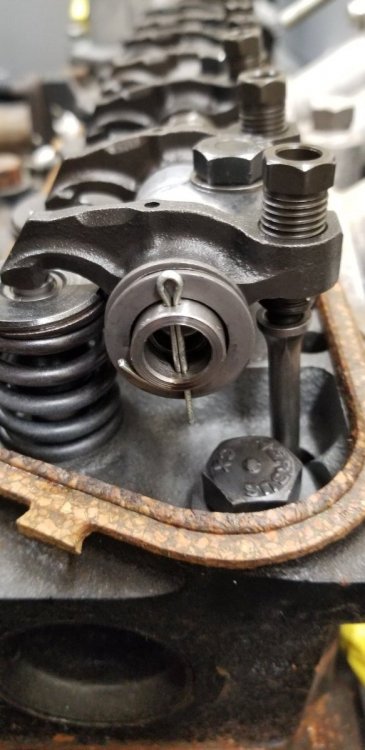

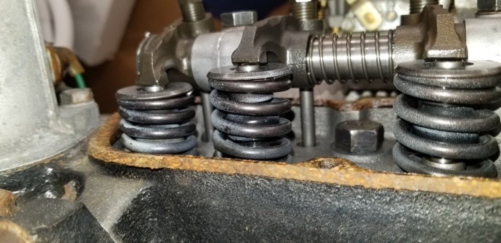

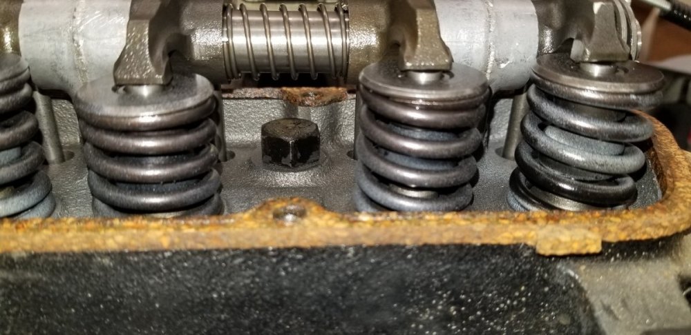

Rocker cover came off, first time in 15 years, and after sitting for the last 10....
the #1 exhaust has been compressed for several years. I only rotated it occasionally,  with some oil in cylinders.
Should these springs be replaced? Valves lapped?
Hell, let's just do it all with bronze valve guides!
Ill set up the go fund me account now.
I’d run it first, adjust the tappets and go from there. A set of springs is about $150 and I’d lap the valves if you’re planning to remove the head. Time to start browsing the Burton Power website!
