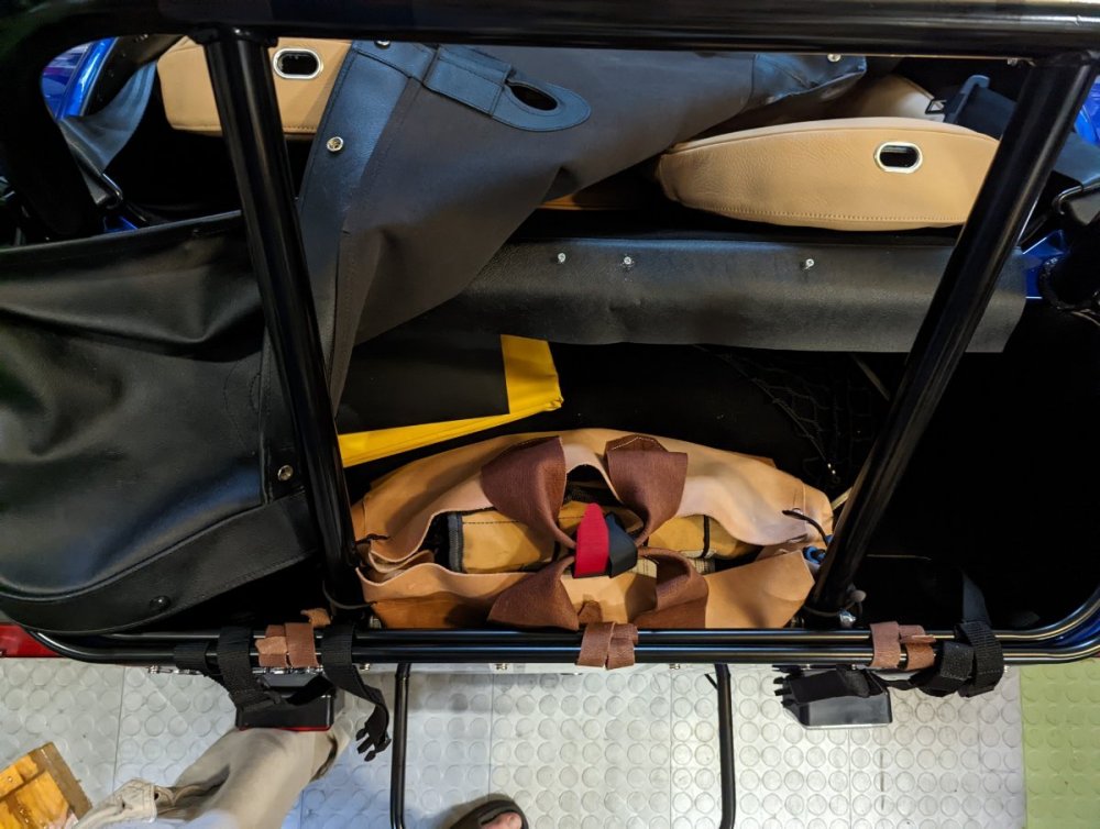

Following up, partly for posterity and partly to track my own progress: I mocked up a few potential bags, v2 shown below.  It's a little overstuffed right now with "the kitchen sink" in there (read: bulky garage tools useful during assembly).  I think I can slim it down after this maiden voyage, 300 miles from home.
The bag is 18" wide (left-right in the boot) + 6"long (fore-aft) and 8" high.  By comparison, the softbits bag is about 16x6.5x6.5.  The boot is 8" high in the back, deeper toward the bulkhead.This should leave some extra space when I unload the non-emergency tools.  I fixed the toolbag to the rollover bar, I do think it needs to be pretty securely fastened.  I don't much like having it occupy most of the easy-to-access space at the back of the boot, though, so I may try to fix it up against the bulkhead somehow.  This bag is also soft, and doesn't really hold shape well -- v3 will fix that.  I may also add a zipper or snap closure for the top.
