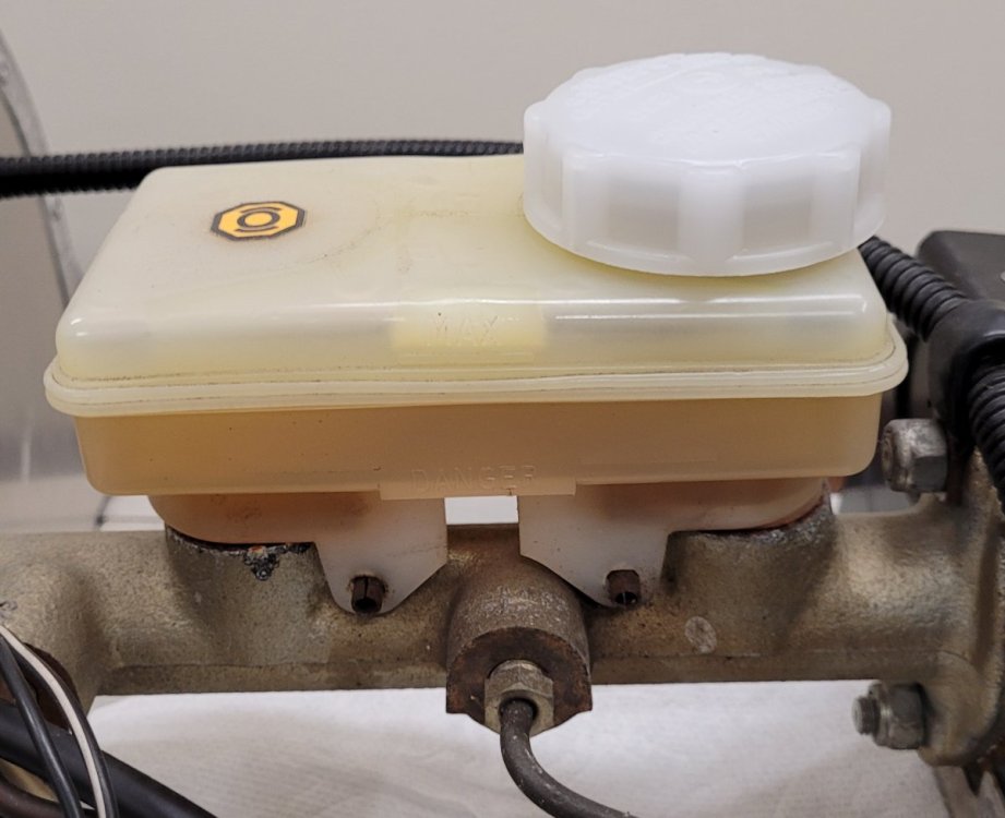

BrianE Posted September 4, 2023 Posted September 4, 2023 On 8/27/2023 at 6:14 PM, IamScotticus said: Just snagged a TRW GMC226 off David Manners Group IamScotticus, just wondering if you received the GMC226 MC and how it worked out for you? I ordered the Morgan one from the eBay seller and got in installed. Unfortunately my pressure bleeder did not make a good seal with the threads and made a small mess of my engine bay, hence I am returning it and will most likely order a TRW Spitfire MC.
IamScotticus Posted September 4, 2023 Author Posted September 4, 2023 (edited) @BrianE No, not yet. What pressure bleeder did you use? Don't they have a cap that will fit? Motive bleeder has a cap for Girling. I'm curious if this is what you tried because that's my plan when I get there. I measured my MC tank opening to be closer to 1.5" than anything listed here, but I suspect the sizes stated are inaccurate e.g. 25mm (1"). Who ever made a 1" neck? Do Spit clutch cylinders have 1" caps? Anyway, before you return something, try selling it on the forum here. I WOULD BUY IT. https://www.motiveproducts.com/collections/adapters-1/products/1123-girling-1-75-id?_pos=30&_fid=38d91d73d&_ss=c This one has a review that says he used this cap on his Spitfire https://www.motiveproducts.com/collections/adapters-1/products/adapters-adapters-import-adapters-adapters-classic-marine-universal?_pos=19&_fid=38d91d73d&_ss=c Edited September 4, 2023 by IamScotticus
BrianE Posted September 4, 2023 Posted September 4, 2023 I used an Eezibleed and the cap I use fits Girling MCs perfectly. The Morgan MC being sold by the eBay seller is not a Girling/TRW/Lockheed MC. It appears whatever mold was used to make the reservoir has enough of a difference from a true Girling one to not allow for an airtight seal. If you are interested in purchasing the MC I think the eBay seller has one remaining or I would be happy to sell you this one. As jbcollier recommended I am going to stick with TRW ones from now on or I will convert to a Tilton. I just want my Cat back on the road!

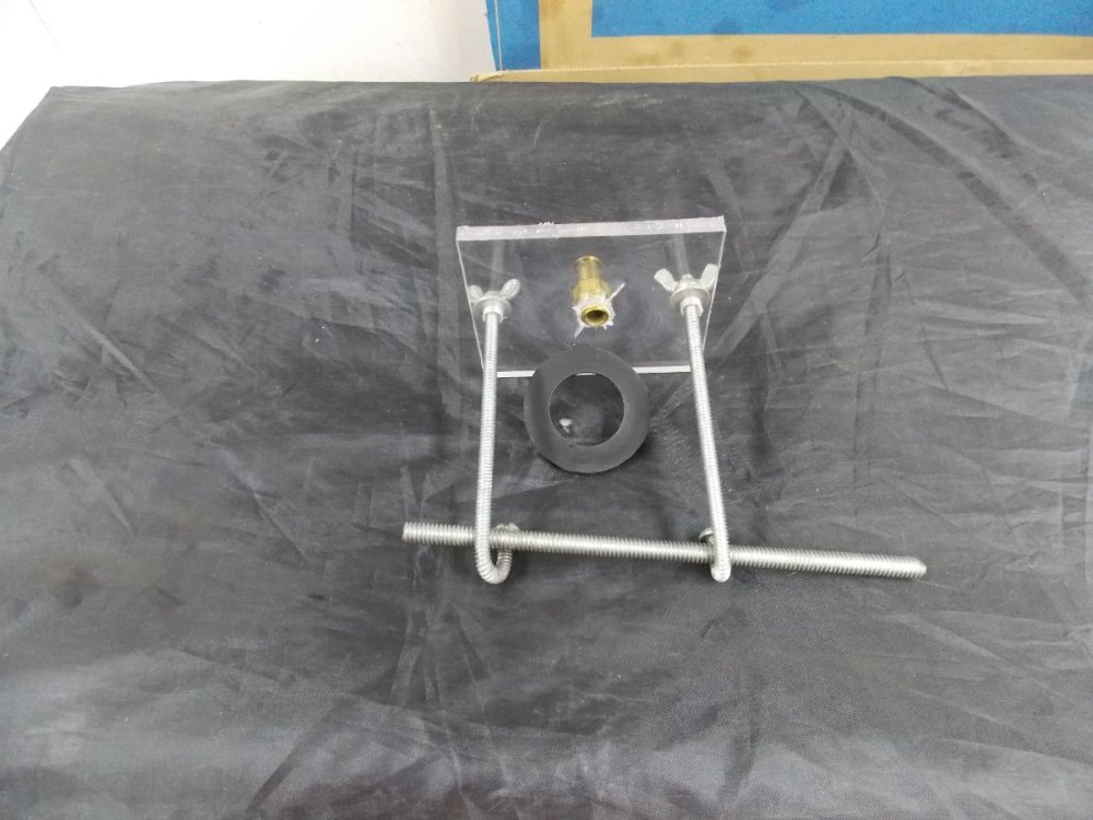

7Westfield Posted September 5, 2023 Posted September 5, 2023 just build your own universal adapter I use this on oddball units that I don't have a spare cap for 1

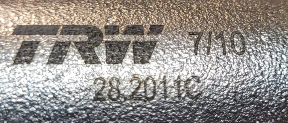

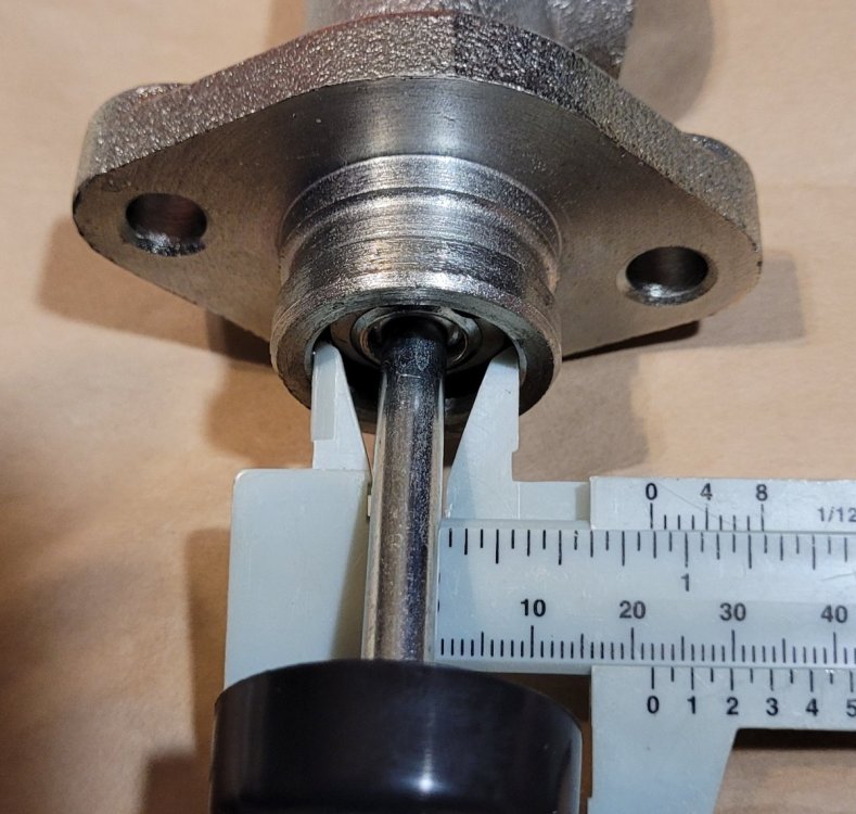

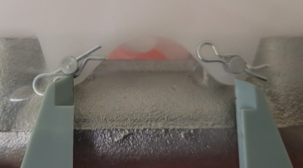

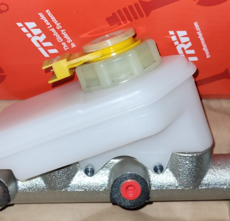

IamScotticus Posted September 21, 2023 Author Posted September 21, 2023 (edited) Alright. sorry this took so long. the MC came in while I had foot surgery (size reduction for better fit in pedal box) so it had to wait two weeks. But the wait was worth it.. MV8 was correct, by all the rough measurements I could make, comparing this new to the old, the TRW Spitfire MC does appear to be a direct replacememt except for the tank and push rod. I am not yet ready to attempt swapping tanks, but even if I don't, this angled tank has enough volume to be usable horizontal. This pin space measurement was taken off my old MC and is being placed on the new. They appear to be close. The other parameters like port space, neck dia, bolt space and length were found copesetic. I will get around to trying tanks and caps later. The spacing is 86mm or 3- 3/8". the tank nipples are 5/16" OD and 3/8" long. No Im not going to take it apart to check bore, etc. I can try to measure the inside of the neck behind the boot, but thats as far as I will go. Another thing, this push rod is capuured behind the circlip. It does swivel on a bearing, backed by spring tension. this may need to be removed to work for the shorter rod the 7 uses. But it could be threaded. I see some are available at Pegasus Edited September 22, 2023 by IamScotticus 1

IamScotticus Posted September 21, 2023 Author Posted September 21, 2023 (edited) I couldn't wait any longer... Yes, the cap for the TRW fits the old Girling perfectly. Yep, this fits too The tank threads appear to be about 9 TPI x 1.75" Edited September 21, 2023 by IamScotticus 1
