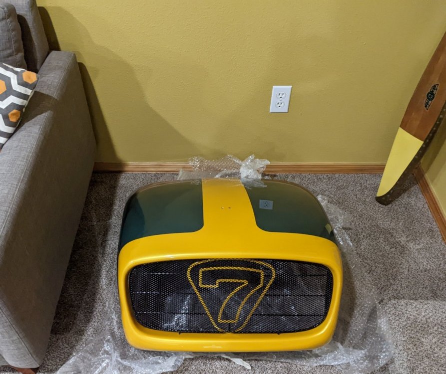

Took delivery of my 420R kit last week. Just under a year from placing the order to getting the kit. Super excited to get started on it. Body is in Aston green and detonator yellow. image.thumb.jpeg.d8b6d3224f7f67ba6c0f4f8539cecd79.jpegimage.thumb.jpeg.89485daf927fb8688639209bac102ea0.jpegimage.thumb.jpeg.afa5169e0980985ee1782980d0d94cd6.jpeg

Prop is a 1942 Sensenich, with stickers and inspection marks still intact. Afraid I don't fly, but am an aerospace engineer by training so have always had the plane bug.

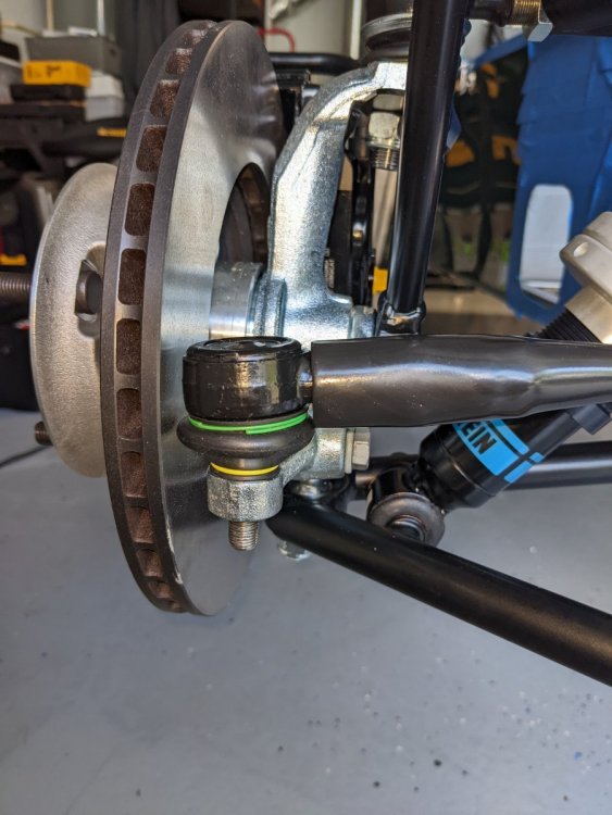

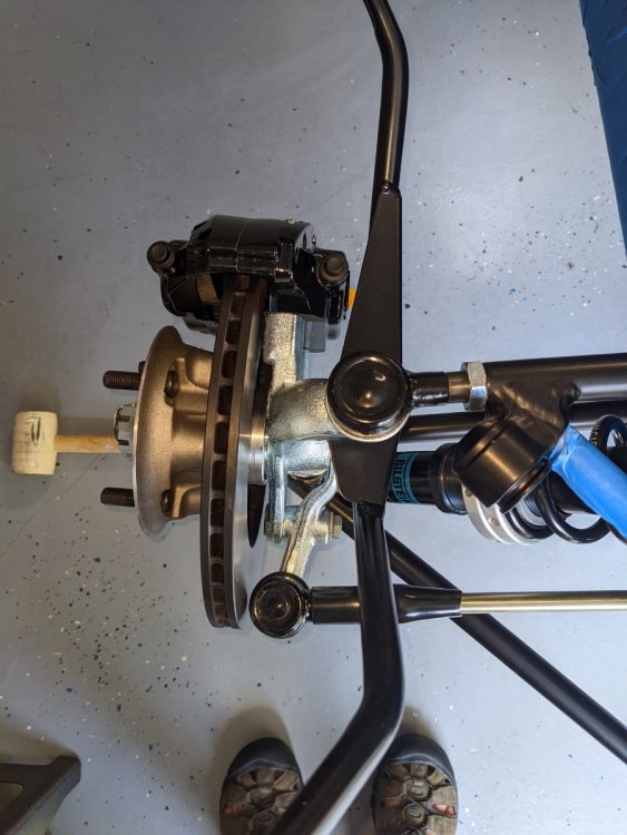

Anyway, have the uprights installed and about to start on the lights. Did have one question though, after I installed the drivers side upright, I found that the brake rotor was tracking about 10-15 degrees to the left, so I added some turns to the track rod end such that it was parallel to the track of the car – at least by eyeball - when the rack was centered. Unfortunately, I neglected to check the orientation of the passenger side rotor before I tightened the track rod onto the upright. So the passenger side rotor is now oriented about 10-15 degrees to the right. Obviously the car was going to have to be aligned post build, but I wanted to at least line it up as best I could during build process. My challenge is that the passenger side track rod end is pressed into the upright now. I tried putting a hydraulic jack under it to push the bolt out but all this does it raise the suspension and eventually the car – obviously the car doesn’t weigh enough to get the track rod end to unseat. Meanwhile there doesn't seem to be any place to attach a puller on the track rod end to extract it. Anyone have any thoughts on the best way to get it out?
I could wait until the build is finished and use the jack then when there is more weight. I could also just adjust things by turning the track rods, but I'd rather have the rod ends starting in roughly the same place if I can.
Thx,
Calvin

Pull back the black sleeve on the silver link toward the rack to expose the jamb nut and flats on the tie rod body. A wrench is placed on each to loosen the nut to free the silver link to rotate freely on the inner tie rod joint that is inside the gaiter on the rack.
For separating a tie rod taper from a steering arm, a tool is used to apply a reasonable amount of force. If it is still stuck, with the tool still applying force, the steering arm boss is struck with a hammer a couple times.
One of the tools in this kit will fit but there is no need for adjusting toe:

I have a puller, but not clear how I can get purchase on the upright without tearing up the boot on the track rod end. Tempted to just adjust the tie rod at the rack side (per MV8s suggestion) but the idea that the rod ends aren't aligned (in the sense that I'll have less play to adjust one vs the other) bothers me. As to Beachman, I fired off some mail to Bruce this weekend to see if he has any thoughts. Working on the headlights for now so no need to find a solution immediately. Would like to find a way to pull the end and get it lined up however.

The yellow ring on the boot is not in a groove on the tierod pin. The boot will slide away from the boss so you can get a lip to pull against but there is no need to remove it.
Don't worry about the alignment now. Part of that process will correct anything you've done.

If you want to adjust it, you can rotate the silver link without removing the tierod end from the spindle boss by loosening the nut I mentioned before.

I agree, run it by Bruce, while at the mean time moving forward with some other components in the assembly.  If I recall, MV8 is correct in that you can adjust the tie rod end without removing the rod end, itself.  But, I'll need to look at mine before I can verify that.
