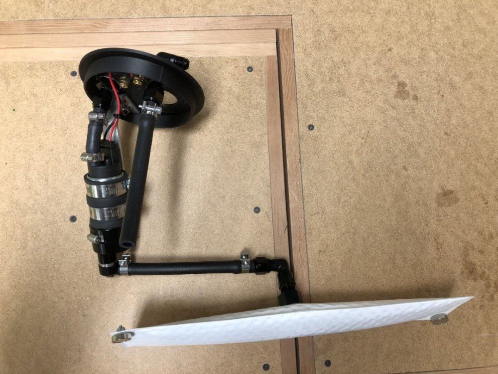

JohnCh Posted July 4, 2023 Author Posted July 4, 2023 Thanks @Anaximander but I have already fabricated the module as shown below and have the Hydramat, so the only difference is the pump, which seems to be one of their standard in-tank pumps. Thanks, John 1

JohnCh Posted July 5, 2023 Author Posted July 5, 2023 I just had an interesting conversation with Holley. There are a few potential issues with the installation that could create either too high a load for the pump ( @Rosteri's theory) or over aeration of the fuel from the return line ( @sf4018's line of thought). Looking at the photos of the assembly out of the car, and remembering the fuel level when I removed it, made me realize that the return may have been hitting the floor and aerating the fuel. If excessive, this could cause issues for the Hydramat. More likely though is the two 90 degree fittings and 12" of hose between the Hydramat and pump creating too big a load for the pump to overcome. Another possibility is that hose rides up the slop of the tank floor, creating a high spot in the routing that traps an air bubble. While I wait for the pump to be returned, I'll print a new fuel assembly lid with inspection ports to let me see how everything sits in the tank, then figure out a game plan. It most likely involves a new Hydramat with an offset collector that can be placed closer to the pump, and possibly changing the angle of the pump mount to allow a straighter shot to the Hydramat fitting. Thanks for the insights and stay tuned. -John 1

JohnCh Posted July 5, 2023 Author Posted July 5, 2023 When you aren't following a well-traveled path, issues are expected, and in a twisted way, part of the fun. Quite frankly, I'm really surprised this is the first real problem I've encountered, but if indeed it is a confluence of design elements in the fuel assembly, it should be a relatively straightforward fix. I've already redesigned the assembly lid to retain both the fuel pump bracket and return hose fitting while adding a massive inspection port which should take the guess work out of the equation. I'll print that later today. And if you think this is challenging, imagine how hard it must be to ensure all the correct parts are included in an expensive kit. Caterham has been doing this for 50 years, yet they still can't figure out how to do it -- it must be monumentally hard <sarcasm mode off> 2
JohnCh Posted July 5, 2023 Author Posted July 5, 2023 I heard back from Deatschwerks. The pump passed the warranty test, but during the endurance test there was "a slight hiccup in amperage most likely from brush break in." They feel it's within spec but opted to replace it in good faith. I also purchased injectors from them and made a few pre-sales technically enquiries during that process. Every experience with them has been very, very positive. Even opening the support ticket online resulted in a response within 30 minutes. Deatschwerks is based in OK and worth keeping in mind for fuel system products: https://deatschwerks.com/ I'll test the new pump before making other changes. However, once the issue reappears or I am confident that was the source, I'll update the in-tank plumbing to minimize resistance. -John 1
MV8 Posted July 5, 2023 Posted July 5, 2023 I was just looking at your intank system. To reduce the aeration, I would replace the elbows with full flow fittings, raise the pump by shortening the pump outet hose if needed for the gradual bends of the full flow fittings, and either shorten the horizontal hose or use aluminum tube between the ends with two more clamps on 1-1/2 inch long pieces of hose as couplers to ensure the hose does not collapse. Be sure to use hose rated for intank use.
JohnCh Posted July 5, 2023 Author Posted July 5, 2023 Thanks, but I'm thinking about a different direction. With the internal fittings, there is only room to raise the pump about 1/2" and still accommodate the bend in the output hose which is required for fitment -- space is really tight. Current thinking is to replace the Hydramat with a slightly larger version that positions the collector at the end rather than in the middle and attempt to position the pump end so there is a short, nearly straight shot to the Hydramat, thus eliminating both 90 deg fittings. I need the pump back to play with this and ensure I can make it work. The hoses are rated for in-tank placement. One thing Deatshwerks brought up is wiring. The pump (255 LPH) runs at a little less than 10 amps. I believe, but need to verify, the fuel pump wire is 16 gauge, which technically is fine for that amperage. Deatschwerks, however, likes to use 12 gauge wire. Running new wire is doable, but a pain. Any thoughts there? Is anyone running a larger pump with stock Caterham wiring? Thanks, John
