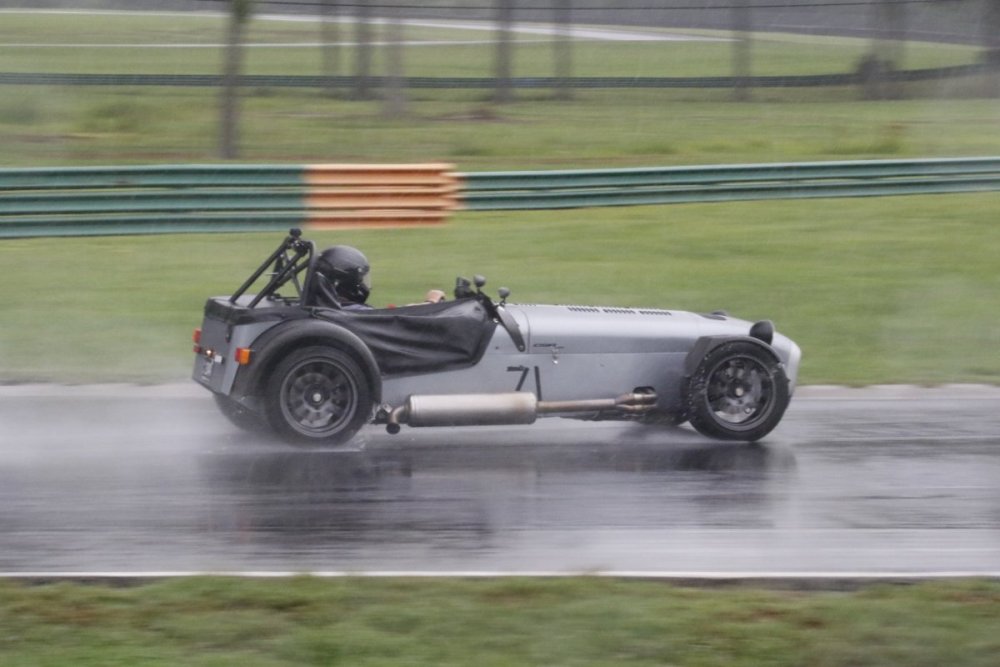

Croc Posted December 11, 2022 Posted December 11, 2022 57 minutes ago, Austin David said: Croc, do you drive year-round in NYC on ZZS? I saw ZT7s out there but I'd need to stash a set of wheels for 'em, and that's a lot of garage space. I did NOT see a lot of interesting 4-season options in smaller wheel diameters (< 16) though. I don't store my car at home anymore. Its just not possible to drive a Caterham around the NYC area. Road quality is horrific and the drivers just too aggressive/too stupid. So I keep it at the weekender. I don't take it out in winter - not much fun in the cold. Its street tires are ZZS plus I use those as the wet tire for track days. My UK 420R also has ZZS for wet/cold days on track or backroad driving. I have driven Spa-Francorchamps in snow/ice/rain days on ZZS and survived perfectly well. I will do trackdays in winter in the UK - its a little warmer than my US climate. I find the ZZS a perfectly good tire for a Caterham all conditions. But that does not stop the need for the driver to have some common sense with the throttle usage. I find I can get a ZZS up to 110-115mph before I feel aquaplaning on track in heavy rain whereas the ZZR is in the 90-100mph area. Hoosier slicks..40mph... 1
