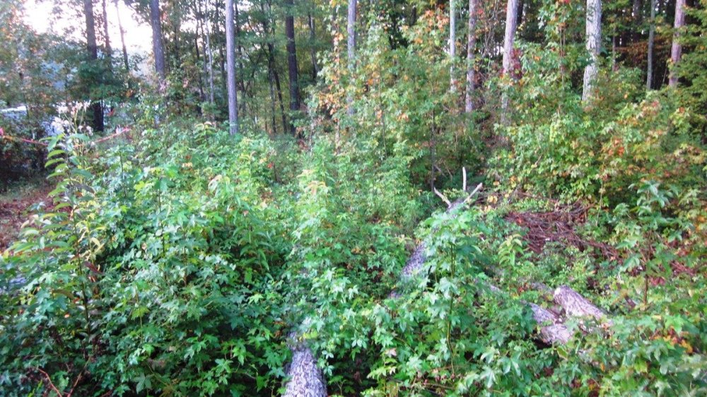

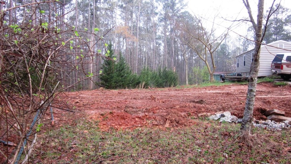

MV8 Posted March 7, 2023 Author Posted March 7, 2023 Not much to show of the hobo castle at this point. I'm at the hand grading/screeding point of the pad area near the blue truck before forming and pouring. Side yard before: After mulching: After grading, stump pulling: 1

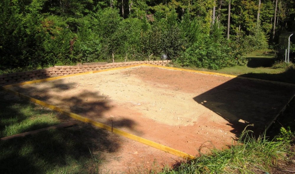

MV8 Posted June 23, 2023 Author Posted June 23, 2023 (edited) Getting close now. Found I didn't have enough dirt for the size of the area (24wx25d plus a foot) without digging too deep. Ordered a full tandem axle load for $250. I was expecting mostly clay but this will be a lot easier to move and level. Need to till the surface again, bring it down, then incorporate the remaining sand. Edited June 23, 2023 by MV8 1

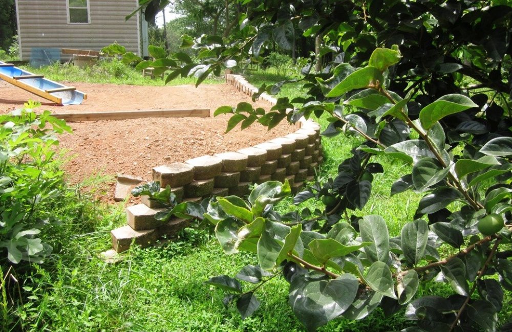

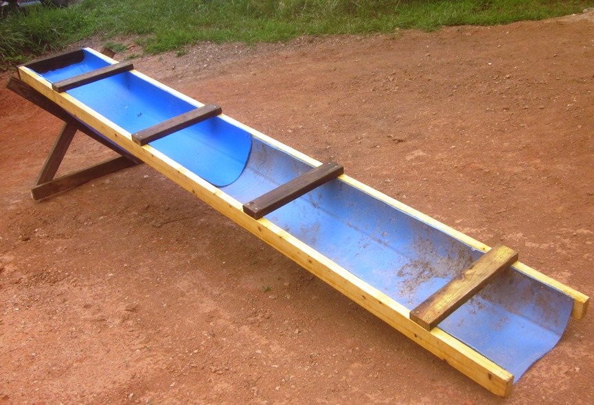

MV8 Posted July 21, 2023 Author Posted July 21, 2023 (edited) Had to build a retaining wall to ensure support with no future erosion issues. Making the pad 3.5" thick with 2x4x12 forms and #4 rebar stakes to keep it square. Made a cement chute since the truck boom won't reach and I don't want to have it pumped. The chute is from a couple thick walled blue barrels that were free. Ends are cut off (the barrel bottoms make great drain pans as deep as you want and will last forever. The remaining tube without ends is cut down one side, laid flat, then rolled the opposite direction for a 6 foot chute about 16 inches wide with one barrel. Mostly repurposed scrap and deck screws ( I did oil it). Not perfect but not bad for a first effort (no examples found online) and it will work fine for what I need. The stand is not attached. Yes, it is that humid (camera fogged up in about 15 seconds). I could have bought a chute, but those are about $1000 depending on the length. Edited July 21, 2023 by MV8 1

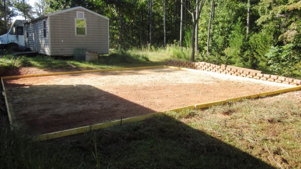

MV8 Posted October 5, 2023 Author Posted October 5, 2023 (edited) Scheduled ready mix delivery. Will also get a layer of plastic/vapor barrier. 25x26x3.5 for 7 cuyds. Had extra retaining wall block so I just kept stacking until I find another use for the excess. Added a hanger strap to mount directly to the cement trucks chute and made a darby from more repurposed scrap 2x4 and deck board. Edited October 6, 2023 by MV8 1
