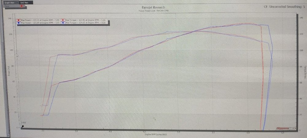

Vovchandr Posted May 1, 2023 Author Posted May 1, 2023 (edited) Thanks for that. Here is my graph ~130hp @ 6200 ~122hp @ 5252 It's just not building power in top end Edited May 9, 2023 by Vovchandr
das76 Posted May 1, 2023 Posted May 1, 2023 Ouch. Yes time for SVT. Or it might just be worth going newer with a Duratec.
Vovchandr Posted May 1, 2023 Author Posted May 1, 2023 (edited) 6 minutes ago, das76 said: Ouch. Yes time for SVT. Or it might just be worth going newer with a Duratec. I have a Duratec sitting on hand, just not willing to commit to a major swap if I can get ~200hp out of the Zetec setup. At this time I'm pending going FI on the current engine or maybe swapping it over to another Zetec for the ease of swap (either a fresh regular or SVT) I just fail to understand what can be so wrong with this engine with so few miles and passing all the health checks, even if it had a hard life earlier. Edited May 1, 2023 by Vovchandr
das76 Posted May 1, 2023 Posted May 1, 2023 (edited) @Vovchandr Here is the brochure section for the "Roadsport" version of the Zetec stating 147hp. So maybe it depends which Zetec you have? And the Ford link i posted lists it at ~130hp, so i'm a bit confused since your numbers are similar. Were you expecting much higher? To get 200hp I think you'll need the SVT Zetec but i'm new to it all, so still learning and digesting a bunch of notes I have from the previous owners (for ex the lightened flywheel is 9lbs vs 32lbs for the stock flywheel) Edited May 1, 2023 by das76
Vovchandr Posted May 1, 2023 Author Posted May 1, 2023 2 hours ago, das76 said: @Vovchandr Here is the brochure section for the "Roadsport" version of the Zetec stating 147hp. So maybe it depends which Zetec you have? And the Ford link i posted lists it at ~130hp, so i'm a bit confused since your numbers are similar. Were you expecting much higher? To get 200hp I think you'll need the SVT Zetec but i'm new to it all, so still learning and digesting a bunch of notes I have from the previous owners (for ex the lightened flywheel is 9lbs vs 32lbs for the stock flywheel) I'll scan my paperwork and share what I have My understanding is that Superlight R's at the period were sold with a "200whp" package of a Zetec, ITB's, cam work and maybe a tune. I have receipts and paperwork on my end to my build but it has many mixed messages. Different cams get mentioned in different areas while upon doing headwork on my car it appears that I have stock cams that were custom ground. There are certainly lots of receipts with lots of "$" to the original engine build paperwork. From what I got from the builder and the communications is that this engine was actually his race engine that he used in another 7 that was swapped into this build once he completed it by the dealer.

MV8 Posted May 1, 2023 Posted May 1, 2023 48 minutes ago, Vovchandr said: I'll scan my paperwork and share what I have Different cams get mentioned in different areas while upon doing headwork on my car it appears that I have stock cams that were custom ground. Unless the reground cams were stenciled with a part number, you may need to have lift measured and the profile degree'd to determine what is actually installed.
Vovchandr Posted May 1, 2023 Author Posted May 1, 2023 15 minutes ago, MV8 said: Unless the reground cams were stenciled with a part number, you may need to have lift measured and the profile degree'd to determine what is actually installed. No part number. Is this something that is actually needed to be measured? Tuner did his best work to try to find the optimal output by playing with adjustable cam gears.
MV8 Posted May 2, 2023 Posted May 2, 2023 He probably assumed your documentation matches the cam installed. Pulley adjustment just alters timing and overlap of what is installed. Pulling the valve cover and measuring is the only way to know what you have. It could be the compression variation is due in part to unintentional differences in cam specs from cylinder to cylinder from cam wear or machining error. Those differences could be masked by differences in valve and ring seal from cylinder to cylinder. 1

Vovchandr Posted May 4, 2023 Author Posted May 4, 2023 On 5/2/2023 at 7:11 AM, MV8 said: He probably assumed your documentation matches the cam installed. Pulley adjustment just alters timing and overlap of what is installed. Pulling the valve cover and measuring is the only way to know what you have. It could be the compression variation is due in part to unintentional differences in cam specs from cylinder to cylinder from cam wear or machining error. Those differences could be masked by differences in valve and ring seal from cylinder to cylinder. Pretty sure we settled on the fact that mine are stock. He opened up the valve train by getting the cover off at some point during the tuning. I think at some point I'm better off just ordering new cams and getting another tune. For those wondering, quick google search just found Tom saying that SVT cams aren't interchangeable with non SVT and vice versa.
