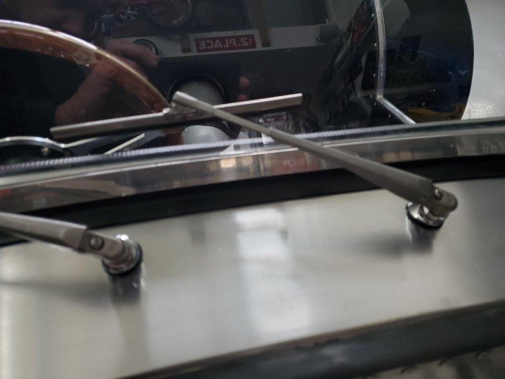

Vinman1 Posted June 20, 2023 Author Posted June 20, 2023 Hope all are getting some road time in your Sevens. Ventured out of town in mine to show the car at Heritage plantation in Sandwich, MA. The shake down runs are getting longer! The clamp on wiper arms (Moss # 164-640) look great. Now just need short bayonette style blades. The E brake handle and what car they came from still a mystery... Cheers, V 1

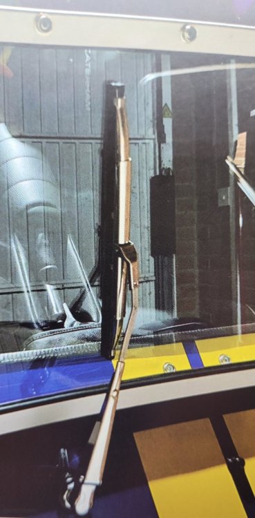

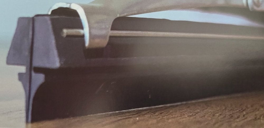

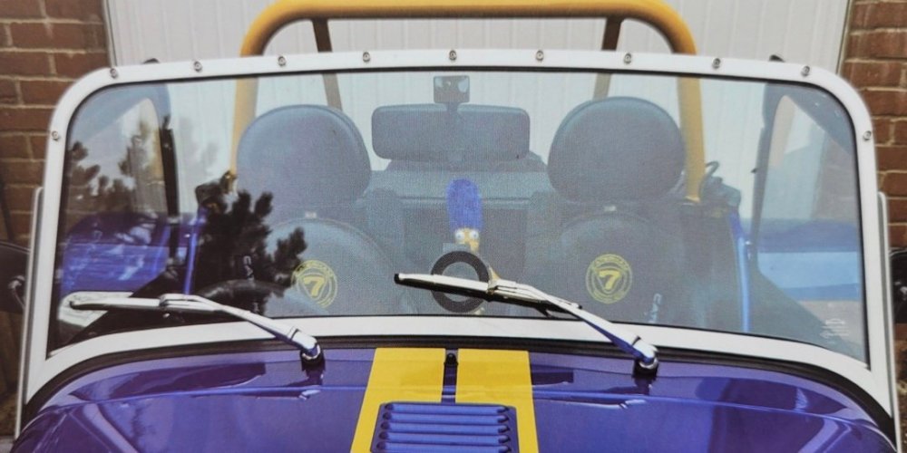

IamScotticus Posted June 23, 2023 Posted June 23, 2023 (edited) In Low Flying June Ed, an article by Gavin Hobbs is stating that uprated wiper blades used on Morgan's will press onto the same arms Cat uses. Got them from Krazy Horse. 10mm x 220mm. Longer blades are available. https://krazyhorse.co.uk/pages/parts-and-accessories I couldn't find a link to the blades on thier site, but they support Caterham as well. They should be able to get you sorted. Edited June 23, 2023 by IamScotticus

Vinman1 Posted June 23, 2023 Author Posted June 23, 2023 Maybe you can drill a hole in the arm at the center of the wheelbox shaft, and use a small puller to get them off? Perhaps a bit of never seize I should consider on mine...
Vinman1 Posted June 23, 2023 Author Posted June 23, 2023 Scott, Thanks for the info. I will reach out to crazyhorse or Morgan Spares to source. Cheers, V
