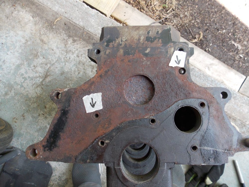

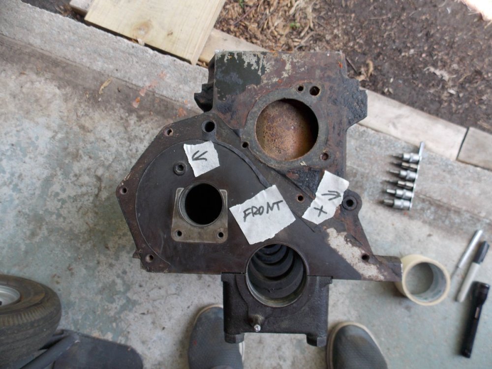

7Westfield Posted July 2, 2023 Posted July 2, 2023 not staked, because it's covering a low pressure passage, but still a real PITA if you can put it in a mill, a cobalt drill at low speed with lots of pressure should work most people just go at it with a dremel, then drill to 7/16 and tap 1/4 NPT the one on the front marked X is where a lot of FF builders put the oil back in with dry sump systems. eliminates a couple of corners in the flow path
IamScotticus Posted July 2, 2023 Author Posted July 2, 2023 @7Westfield Thanks for the illustrations. I Will be dry supming my engine and that front port is a very desirable place to port into. I have a 4 port pump to do that with. Looking at it, that front port is behind the pully belt. I don't know how to work around that. I looked ay many FFs DS and, suprisingly, all I've seen are using the 5 port. With that being the common pump (that I've seen) I suppose the 5 port is adequate for 99% road use, with an occasional spirited showing off. So I have a 5 port too. If I feel the need to port the front, I can when I know how to route the line. Everyone: sorry not selling either pump at this time.
