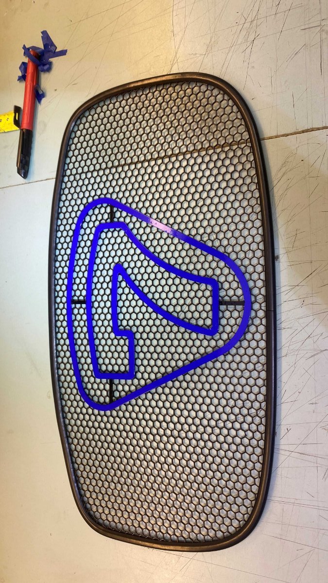

ptegler Posted August 24, 2023 Posted August 24, 2023 what are people using as a grill material to stop possible radiator rock eating events? Options I'm looking at: 1- heavy welded s.s. #5 mesh, behind 1/8" s.s rod supporting the '7' s.s logo/emblem. (mesh probably powder coated black 2- round hole perforated s.s. sheet behind a wire and '7' logo structure as defined in #1 above. 3- other options? suggestions? considerations? tia ptegler

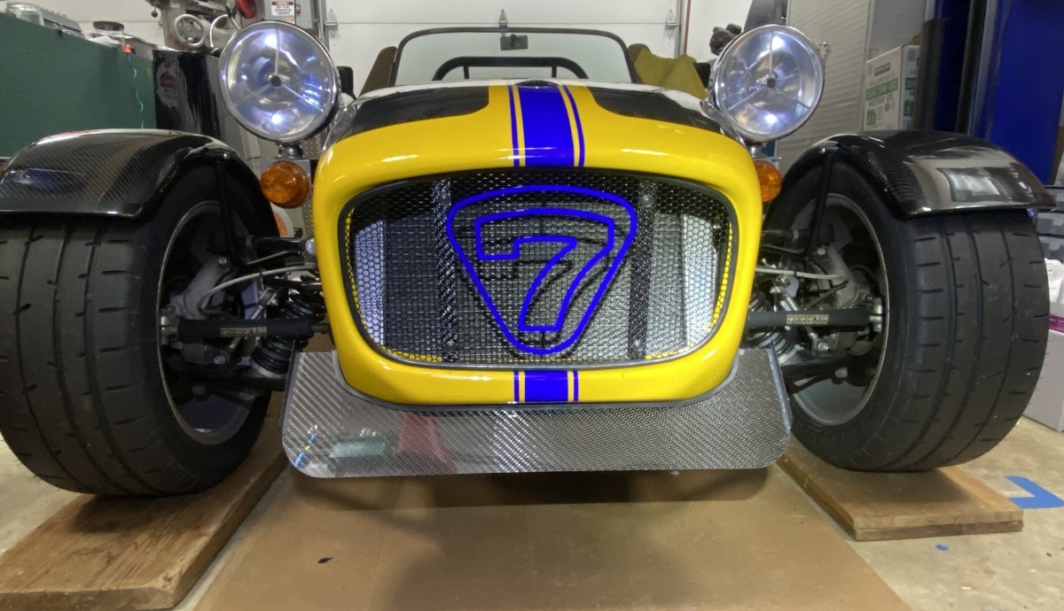

FE07 Posted August 24, 2023 Posted August 24, 2023 I used this when I did mine: Medium Mesh Stainless, #6 x .035 Wire (6 openings per inch). Bought at Pegasus auto racing. Made a template of the opening with cardboard then used that to trace onto plywood and used that as a buck to bend it over. Used aviation snips to cut the wire. Sits behind the 7 grill and held in place with small zip ties. Works well to keep bugs, tire rubber and stones out of the radiator. I’m in Owings Mills if you want to see what mine looks like. jim
MV8 Posted August 24, 2023 Posted August 24, 2023 Can also use rubber edge molding to help prevent woven wire from unravelling. "Hardware cloth" is another option. % open area is important for cooling. Perforated usually has much less open area, restricting airflow. Screen has been used to protect radiators from stones and rubber thrown up that can clog the fins. It clogs the screen instead but much easier to clean.
papak Posted August 24, 2023 Posted August 24, 2023 I did the same as FE07. I made a buck out of 1" particle board ( had a remnant) by tracing the outer dimension of the inside of the nosecone. This allows the formed screening to wrap forward around the inlet. I fasted it with 4 small SS buttonhead screws with large washers on the back of the screening. Where I to do it again, I would fabricate a bracket in front of the radiator and just rivet the screening to that. I would advise to leave it unpainted. The small pebbles and such that hit it will just chip the paint.
ptegler Posted August 24, 2023 Author Posted August 24, 2023 power coating planned.... btdt have had good luck to date. tnx all

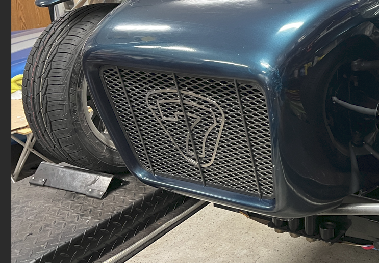

7Westfield Posted August 25, 2023 Posted August 25, 2023 (edited) https://www.speedwaymotors.com/Nomex-Honeycomb-Radiator-Guard-Protector-Screen-Mesh-18-x-22,29432.html this is what I use on a formula ford just cut a piece and hang it on the front of the rad with small zip ties edit---put it against the rad, not spaced away Edited August 25, 2023 by 7Westfield 1
