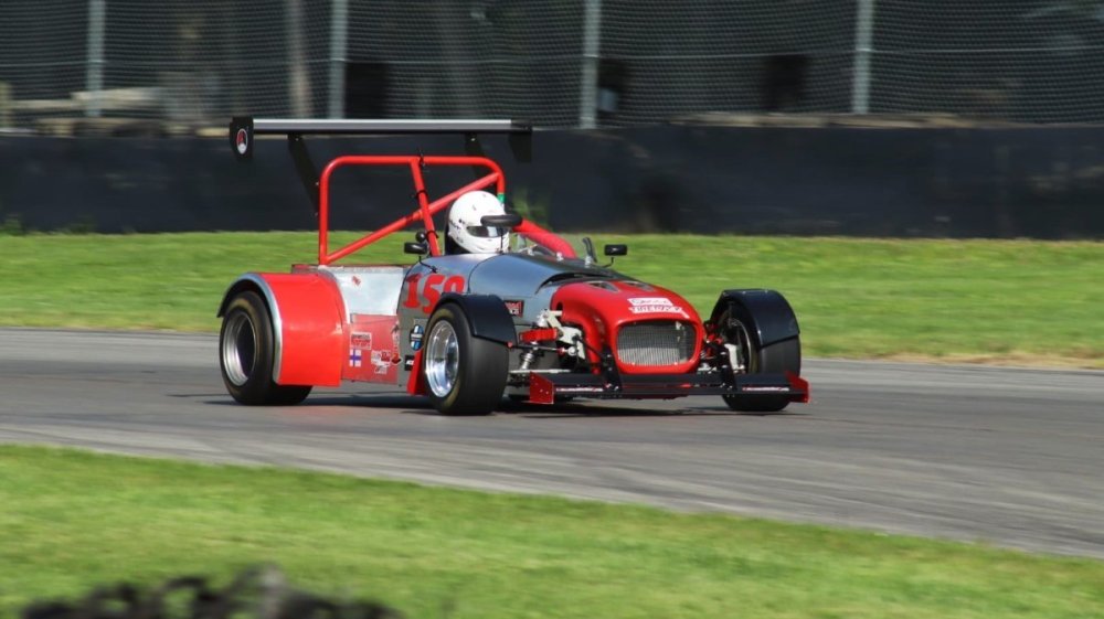

Locofinn Posted April 25, 2024 Share Posted April 25, 2024 If you want track wheels and tires, try this. I run Real Racing Wheels from https://www.rsracing.com/rrw13.aspx Real Racing Wheel can make you anything you need. For Tires: Just buy used tires are are run on Formula cars like Formula Atlantic/Indy Lights and P1 (prototype class) cars in in SCCA. They use them for qualifying then sell them cheap with more than 75% tread left. The set I just got this week were off a USF2000 Formula car Continental slicks. https://www.continentalracetire.com/usf-2000 The set of 4 tires were only $425 including shipping UPS to me in Indiana and look to have about 90% tread. Should last me 4-5 full weekends of TT. I get my tires from John Berget Racing Tires in WI. https://www.jbracingtires.net/ Tires are the biggest expense if you run a lot of track events. Saves your nice street wheels and tires for the street. 1 Link to comment Share on other sites More sharing options...
