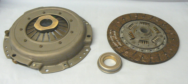

joe7 Posted July 2, 2024 Share Posted July 2, 2024 Did you try SJ Sports Cars UK? Not sure if this what you are looking for. They have a 3 piece kit: PP w/platen, disc, T/O bearing for UK 198 about $250. Link to comment Share on other sites More sharing options...
TEM Posted July 2, 2024 Author Share Posted July 2, 2024 Hi Joe, Do you have an SJ part number or link to the kit? Link to comment Share on other sites More sharing options...
MV8 Posted July 2, 2024 Share Posted July 2, 2024 5 hours ago, TEM said: Well, not good news from Burton. "Im sorry we are unable to supply a replacement kit that is a very early deep kit which we dont supply my advice would be to talk to either kelvedon lotus or QED motorsport or contact the owners club they may have the parts or may of had them re made possibly." It is apparent that they do not have an early, deep diaphragm kit for sale. Link to comment Share on other sites More sharing options...
joe7 Posted July 3, 2024 Share Posted July 3, 2024 SJ Part # for the kit is SJ036Q0008. They also sell the parts separately. Link to comment Share on other sites More sharing options...
TEM Posted July 3, 2024 Author Share Posted July 3, 2024 Thanks Joe7. I'll reach out to SJ and get confirmation on fit and quote. Did you use this kit on your car? Link to comment Share on other sites More sharing options...
joe7 Posted July 3, 2024 Share Posted July 3, 2024 No. It was 14 year's ago when i did mine. So I don't clearly recall where I got a stock set from. My best guess is from Dave Bean. Link to comment Share on other sites More sharing options...
