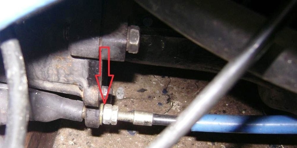

Carz01 Posted July 24, 2024 Author Posted July 24, 2024 (edited) Thanks for the feedback, I’ll check the adjustment as a first step. Prior to this occurrence it shifted fine. When I looked at the linkage it seemed a bit loose, but I didn’t have any specs to work with. More to come. looking at this, the the jamb nut was in fact loose, so I’ll adjust there to start. In the picture below you can see there are quite a few threads showing on the barrel. Since I’m starting from scratch any recommended order to set the linkage? Edited July 24, 2024 by Carz01
MV8 Posted July 24, 2024 Posted July 24, 2024 (edited) Pull the cable sheath forward with a little effort to see how much the thick nut moves away from the bell housing. How far will out? If the end of the threaded sleeve comes out of the bell, consider fitting a new cable. If you can't and the movement is more than a 1/2 inch, rotate the thick nut to make it a 1/2 inch or less. Hold the thick and just snug the thin against it. It doesn't take much effort to set the thin nut. Edited July 24, 2024 by MV8
Carz01 Posted July 24, 2024 Author Posted July 24, 2024 I’ve checked the cable and the threaded sleeve did not come out of the bell but, I was able to pull it out over a 1/4 inch. So I’ve adjusted the nuts and have about a 1/4 inch now. However after adjusting I’m still unable to get the car in gear when running. When stopped no issue, I can select all gears. I’m thinking clutch replacement, unless there are other things to check. Since I’ve never replaced a Caterham clutch, what’s the difficulty scale, and any special tools needed? thanks, Joe
