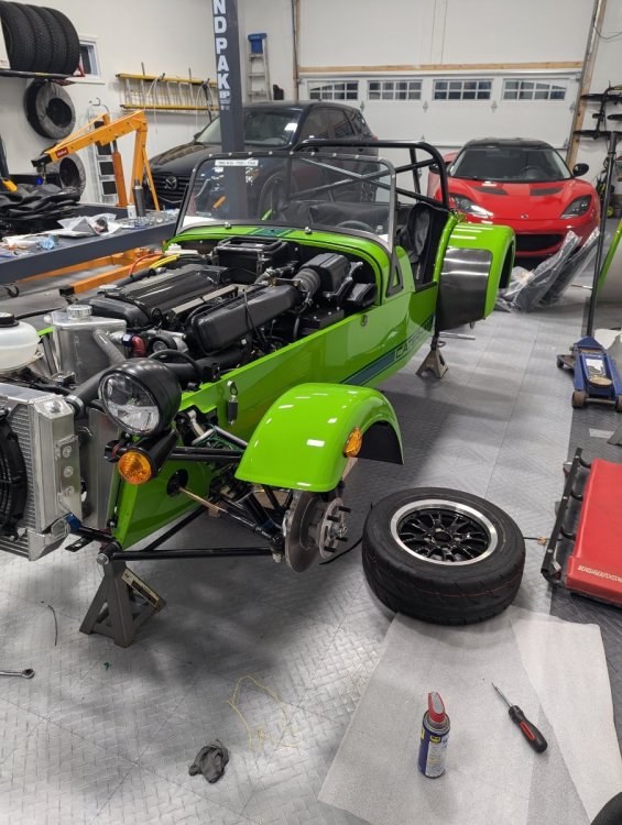

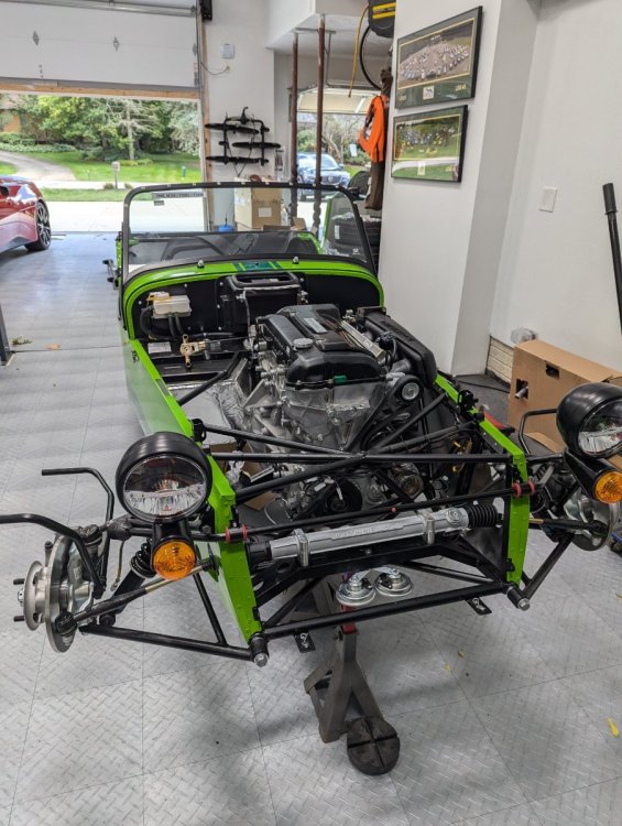

hyper7 Posted September 2, 2024 Author Posted September 2, 2024 Motor is IN! Was actually a little easier than I expected, just a lot of twist/push/pull/up/down game to line things up 1

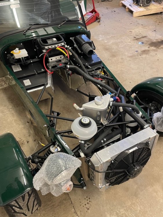

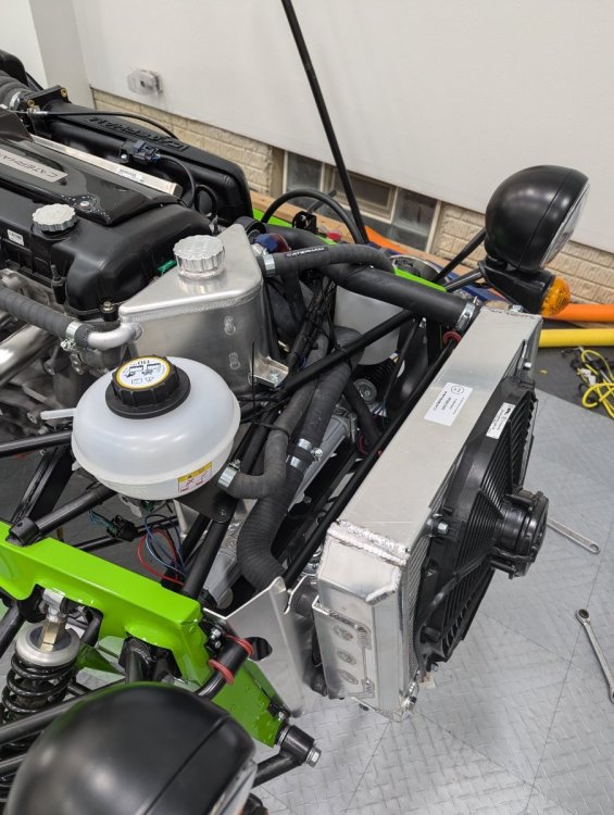

hyper7 Posted September 5, 2024 Author Posted September 5, 2024 Went to slap on the radiator this evening in the hour I had, and seems like I'm missing something else - can someone confirm these are the brackets I'm supposed to have? I found a picture on https://www.caterham420rbuild.co.uk/post/19-radiator-and-fan That looks like what I need, but of course nothing in any of my boxes or on the pick list. The front of the car has brackets coming out the front, but I need a 90 to mount the radiator
JohnCh Posted September 5, 2024 Posted September 5, 2024 Yes, those are the required brackets. See this post for some potential fitting issues you may have: 1
hyper7 Posted September 6, 2024 Author Posted September 6, 2024 I sent an email to Caterham for the parts, thanks
CBuff Posted September 6, 2024 Posted September 6, 2024 Once again I can’t offer any first hand helpful insights. But these are photos of the rad mounts factory built (so I’m 60% sure it’s right).

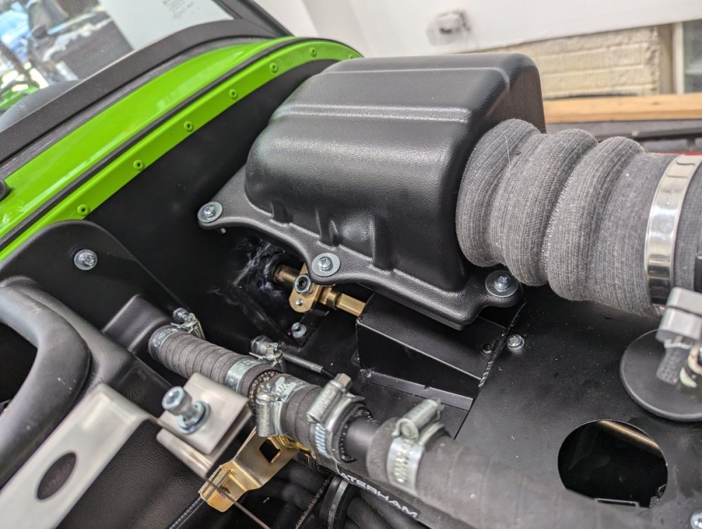

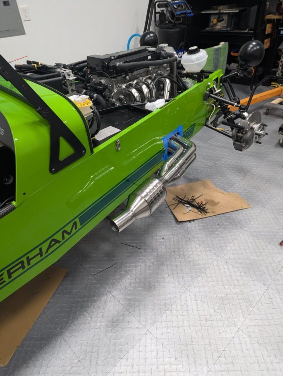

hyper7 Posted September 7, 2024 Author Posted September 7, 2024 Got to work running the plumbing, and attaching the exhaust pipes (minus the actual muffler because I don't have the correct one yet) Two observations - 1) thank god for https://www.tiggercaterham.co.uk/post/plumbing-preparation I was so lost trying to follow just the picture in the book. I absolutely could not have even attempted this without the better pictures/descriptions. 2) the exhaust springs are AWFUL. My hands will hurt for a couple days I'm sure trying to get those damn things over the hooks. Eventually got them, but required waaay more force then I wanted to use Also, anyone have a better way to route the heater control wire? It's clearly designed for RHD

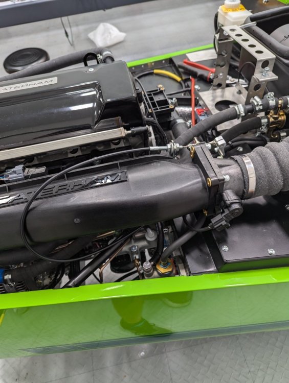

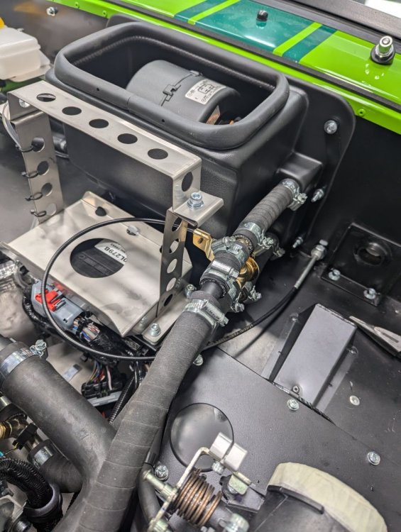

hyper7 Posted September 13, 2024 Author Posted September 13, 2024 Figured out routing for the heater wire - had to twist it behind the battery tray. I also don't like my throttle cable routing... Received the missing radiator brackets yesterday and got the plumbing buttoned up, also got the steering column in...but I screwed up..... In reading blogs, they all said to put the bushing into the steering column first because they seemingly all use the removable steering wheel, which I do not have. I had already pushed in the bushing before I realized my mistake, and basically destroyed it pulling it back out. Oh well, live and learn, new one is ordered, so the column is put together without the top bushing for now Also for anyone else reading this in the future, for LHD, do the steering column BEFORE the airbox, and before the plumbing. It was all in my way and I had to take some of it back out to get enough space to work.
JohnCh Posted September 13, 2024 Posted September 13, 2024 On 9/7/2024 at 3:57 PM, hyper7 said: 2) the exhaust springs are AWFUL. My hands will hurt for a couple days I'm sure trying to get those damn things over the hooks. Eventually got them, but required waaay more force then I wanted to use Was that using the zip tie method or just brute force?
hyper7 Posted September 13, 2024 Author Posted September 13, 2024 3 minutes ago, JohnCh said: Was that using the zip tie method or just brute force? Both. 5 zip ties and still needed brute force on both.
JohnCh Posted September 13, 2024 Posted September 13, 2024 It sounds like either the springs have gotten stronger, or the cat bypass pipe places the hooks slightly closer to the hooks on the primaries. I used either two or three zip ties and remember thinking it was surprisingly easy. You are making great progress! 1

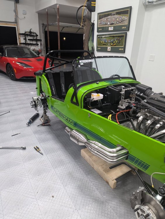

hyper7 Posted September 24, 2024 Author Posted September 24, 2024 (edited) Did some heavy lifting over the last week or so and got the diff and rear axles all in place. Also got the seatbelts and roll bar in...starting to run out of things to do 😭 Edited because yeah I'm an idiot. I figured out my question. Edited September 24, 2024 by hyper7 I'm an idiot 1
