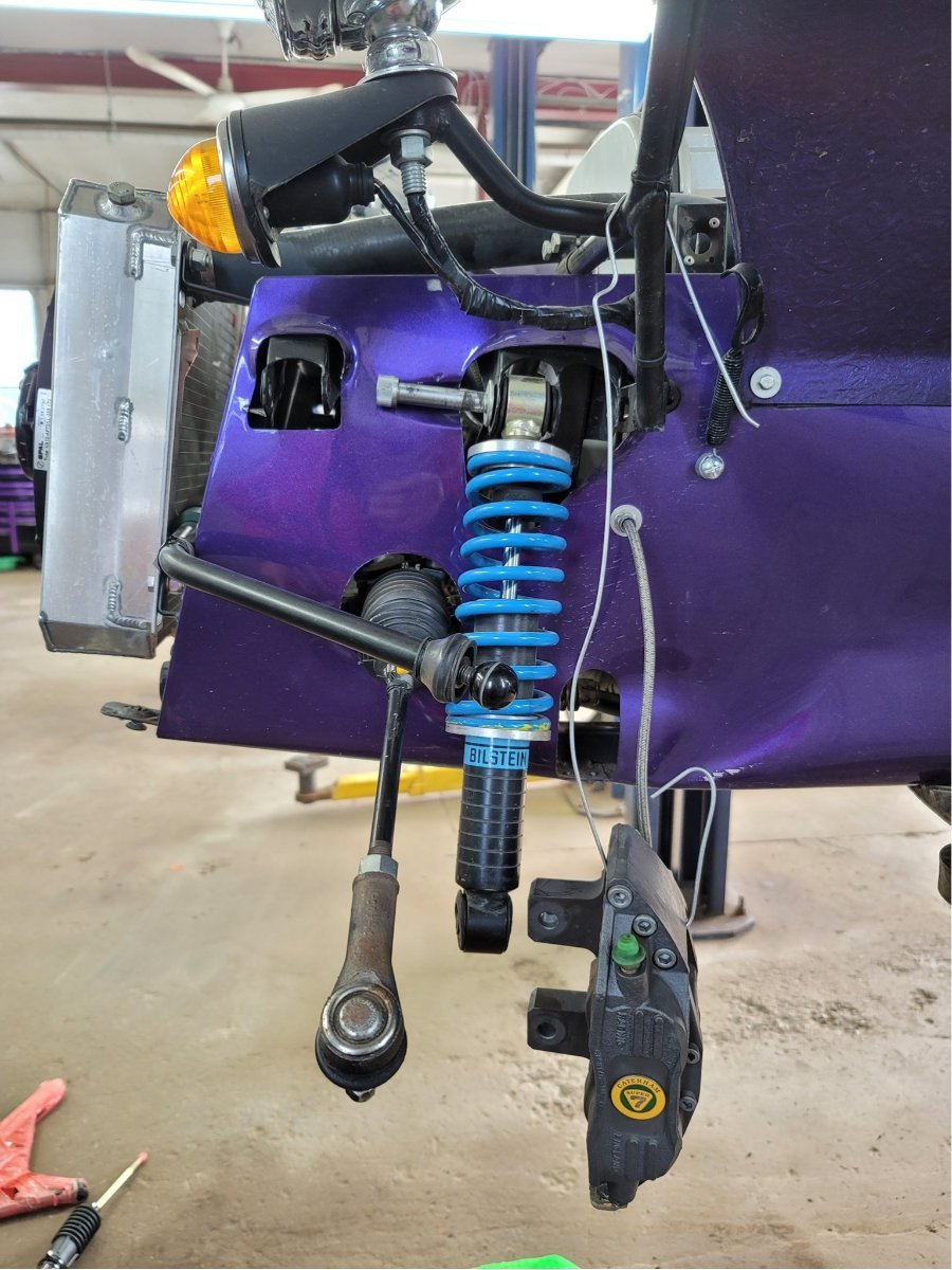

Left front suspension is mucked up (tie rod bent back and everything is skewed) fender is toast and the body panel from front to the exhaust cutout is rippled with paint missing. I suspect more damage will be found like the suspension mounting points will be bent/broken.

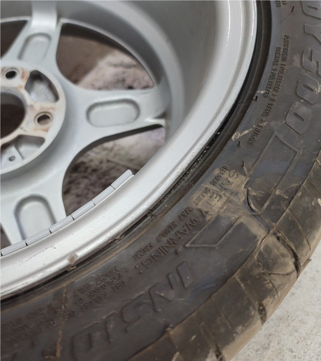

Thanks for the offer but the rim looks untouched. It will have to be spin balanced once it gets a new tire and we’ll see if there are any problems then.
There does appear to be some damage to the wheel. In the last picture, just below the fender, the inner lip of the rim looks bent.
DAMN! You are correct, I missed that.
We'll have to see what the insurance company says as it'll probably come down to cost.

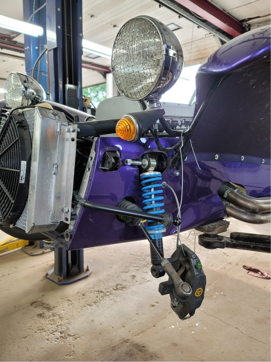

The car arrived at the body shop where Earl (the shop owner) and I went over it. WOW, worse than I thought and we did not do a complete investigation. Things like the wheel bearing, tie rod, steering rack, main frame rails etc. all still have to be evaluated.

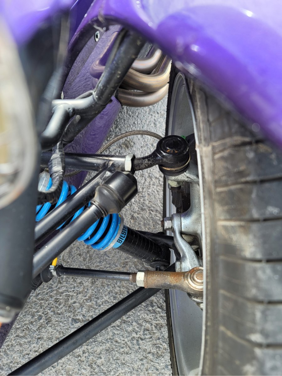

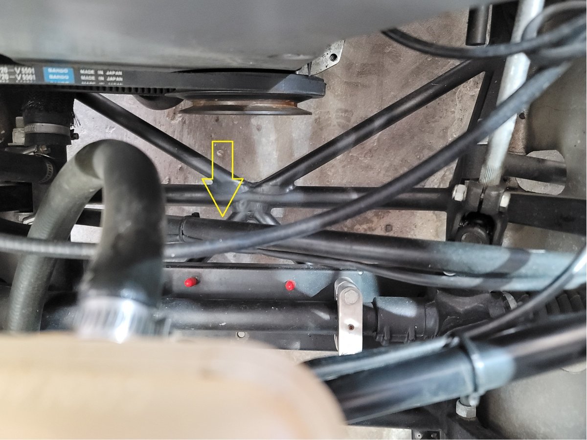

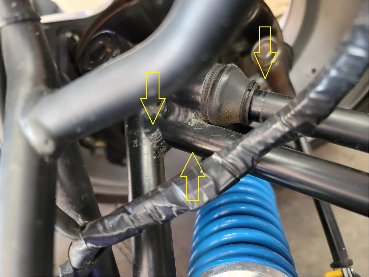

I understood that the rim and tire would be toast. Same for the upper wish bone rod end. What I didn’t see was how bent the upper wish bone and upper suspension pickup points were. You can see in the image how far back the rubber boot on the sway bar has been moved by the amount of exposed bar. The upper shock mount is about ½” back and the upper wish bone shows cracked and flaking paint both on the bars and the welds. The lower wish bone mounting bolt is bent revealing a gap between the washers and the pivot mount.
The diagonal bar running past the headers is warped about 3/8” as is the brace running from the top left to bottom right near the steering rack.

In addition to the above pictures, based on what I see, your body shop will need to get the chassis up on their frame rack and take cross measurements. Expect the chassis to have a torsional twist to it that may require additional work to straighten out. I'm not throwing this out there to worry you, but as the retired body shop owner, yours will not be the first one I've laid eyes on in similar situations.

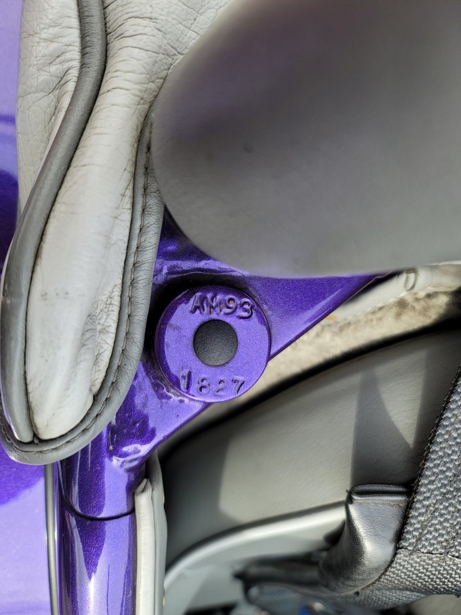

Hi Dreamer.  If you can, try scraping the paint away from a couple of the welds to see if it is an Arch gas flux bronze welded chassis, or perhaps a mig welded chassis from Caterham (Cages or Caterham factory?).  If it is gas flux braze welded, no tig or mig should be allowed near the bronze welded joints if possible.  Heat can be applied carefully with an oxy/acetylene torch to straighten tubes as necessary, but the body shop tech should be advised regarding the chassis tube joining method.  I have seen a couple of good body shop videos (one from a Nissan tech in Japan) who did wonders with a damaged Nissan car.  It is amazing how body shops can restore bent metal back to shape and make it as good or stronger than the car came from the factory.  If the car needs to be stripped, can you store the engine, transmission, fuel tank etc. at your place to save on any storage charges and prevent possible theft?  Good luck. W
EdWills, you must have missed all the posts about my Purple Reign. It is definitely an Arch Motors chassis (see image).
Earl is confident that any frame tubes can be brought back into alignment and that no chassis welds will be affected. The upper wish bone will be replaced, lower too if need be.

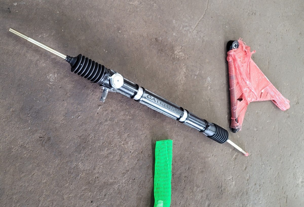

Among the parts to be replaced was the steering rack. My 1993 HPC has a small diameter rack tube. I now understand this original part was a modified Mini rack no longer available. Oddly they also ordered a new right side tie rod end. There is no damage to the right side. So is this common practice or is this a metric rack and therefore needed a metric right side tie rod end? The mechanic has not replied as to whether the threads on the rack are metric or standard.
The rack delivered is the newer Caterham cast alloy unit. The mounting brackets for my car won’t fit over this new rack. Emails back and forth and new brackets were dispatched. When they arrived they have an offset mounting hole. They don’t work either. I just learned that new brackets have been dispatched but with no ETA. It seems no one understands or pays attention to tracking numbers. No one seems in a hurry to get my car back on the road. So it’s sitting in a corner of the mechanic’s shop waiting to get put together and a four wheel alignment done. Then it has to go back to the body shop to have the alloy panel and fiberglass fender repaired and painted.

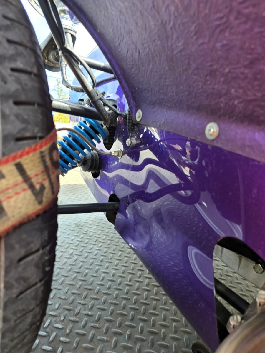

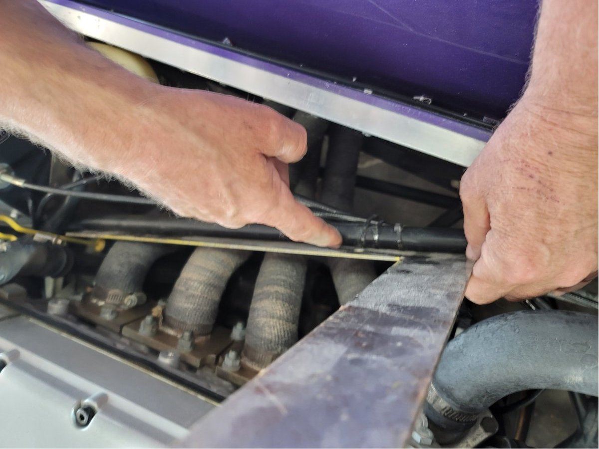

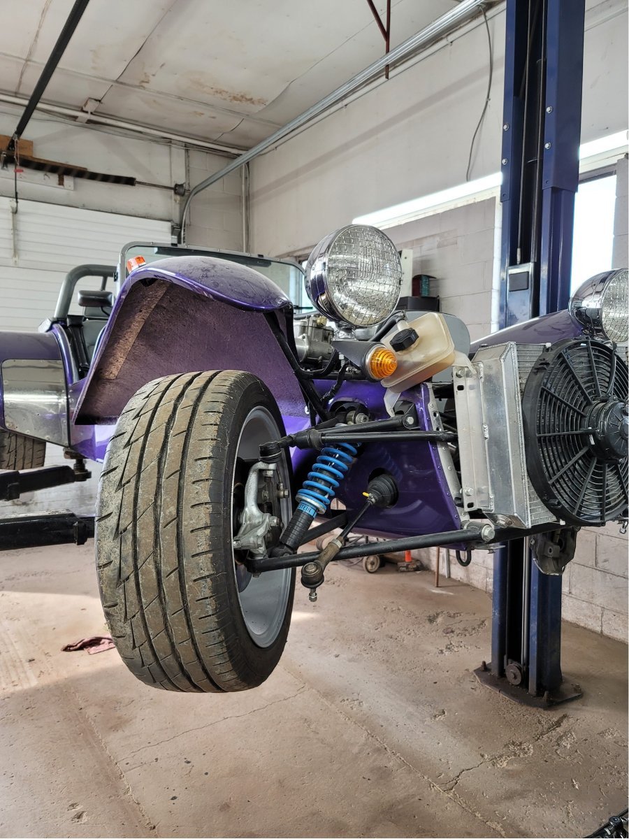

Latest photos I shot of the car taken weeks ago when they discovered the rack issue.
