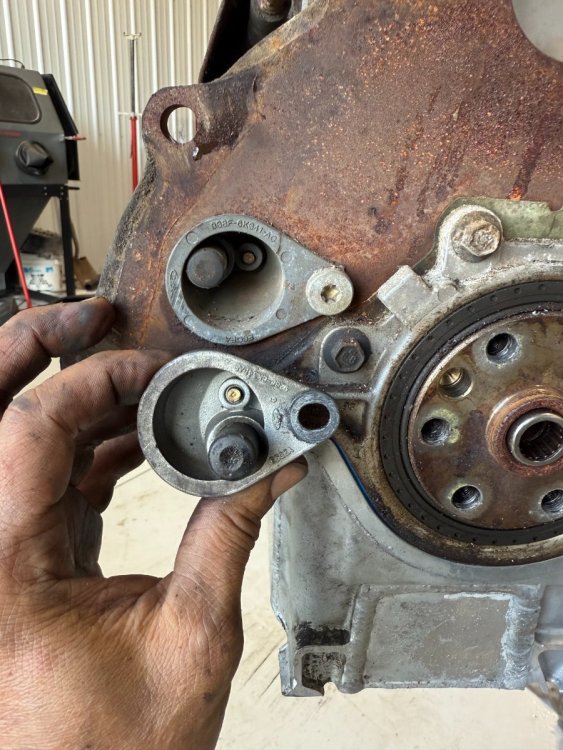

pethier Posted August 18, 2025 Author Posted August 18, 2025 IMG_9128 seized oil pump Apparently, the oil pump runs concentric with the crankshaft. It seems to have taken the brunt of the abuse of the unrestricted clutch travel. The original block and head will need to be thoroughly-cleaned to remove all the shrapnel.
pethier Posted August 19, 2025 Author Posted August 19, 2025 (edited) On 8/17/2025 at 6:44 PM, pethier said: In the interest of getting this car back on the road for LOG, Ron is not going to clean the engine for shrapnel, but use the block from the engine that I just bought. After consultation, Ron and I have agreed to use both the block and head of the bought engine. This saves Ron from having to clean the head. Alternator and other parts are different in the Birkin. There a few aluminum Ford pieces that are not used, and other pieces have been created to support the different configuration used for the Birkin. The result of using the bought cylinder head is not likely to give as much power and torque. Steve had made some changes to the head to improve the flow. With luck, I will have a useable engine for now and all winter to clean up the "Steve" engine and have it back in the car for next season. Apparently all this is because the other shop missed the importance of the simple clutch-travel limiter right there on the bell housing. Ron spotted it. My guess is that Steve never needed to use it because the pedal layout in the Birkin stopped the travel before the throwout could cause trouble. Edited August 27, 2025 by pethier Just spotted a sabotage-by-spellchecker.

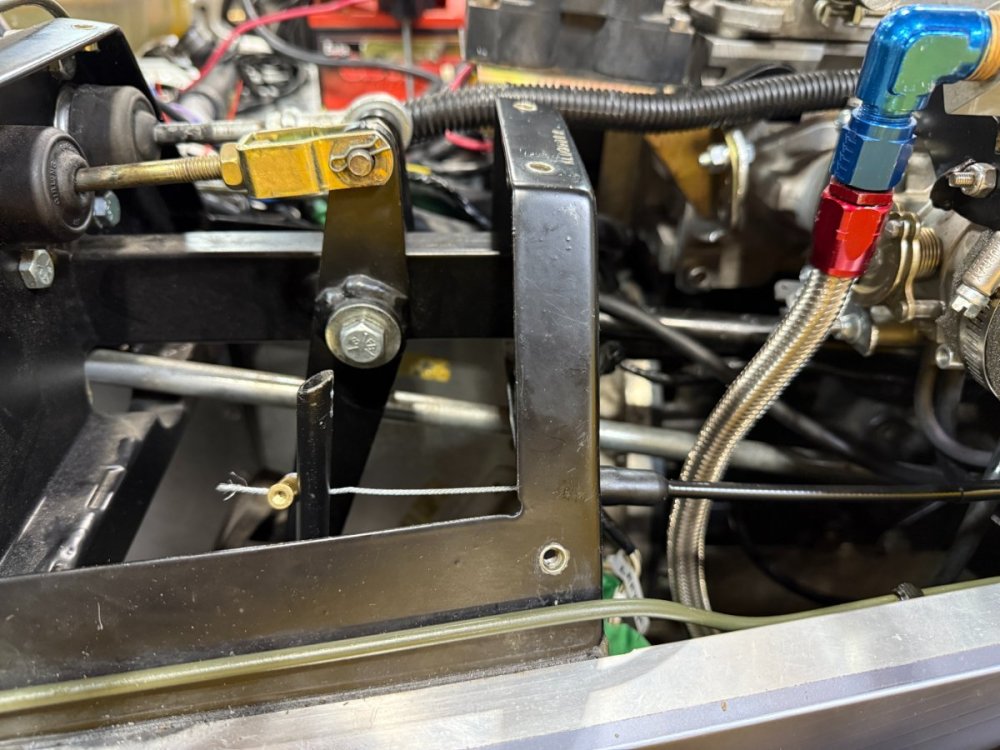

pethier Posted September 19, 2025 Author Posted September 19, 2025 It is now obvious to me that Steve, the builder of the Birkin, (who is now building it into an electric car) followed the Birkin instructions to set up the clutch. The shop transferred the hydraulic clutch system into the Caterham which had used a cable system. The action turned out to be quick, and there was a lot of pedal travel left after the clutch was fully disengaged. After over half a century driving standard-shift cars, I didn't know this was a problem. The is a bolt with a locking nut on the aluminum bell housing which can be adjusted to provide a hard stop as soon as the clutch is disengaged. This bolt was turned all the way in. I assume that a stop was done on Steve's Birkin at the pedal end of the mechanism either by accident or design and Steve autocrossed the car for decades with no trouble. Since I didn't know any better, and the professionals who should have known better didn't, that bolt on the bell housing never got turned out to block the throwout lever at the appropriate place. I seized the engine by using the clutch in the normal manner. I had by this time taken the car to a tuning shop, which had always been the plan. When the engine seized, I brought it back to the tuner, who suspected I had rotory-welded the thrust washer (which I had in my ignorance assumed was a bearing). Tuner suggested I get a junkyard engine to get me through the season. As he dug into the engine, he was surprised to find that the oil pump, which is on the crankshaft on these Zetec engines, had taken the hit. To clarify, it is not that the pump failed and the engine seized due to oil-pressure failure. The pump itself seized and prevented the engine from turning. This is entirely a clutch setup problem which did not harm the clutch but harmed something on the other end of the engine. This engine will come apart and be cleaned and balanced over the winter. The junkyard engine is in the car with the Hayabusa injection working. The clutch throw has been properly limited with the bolt on the bell housing so this can not happen again.
