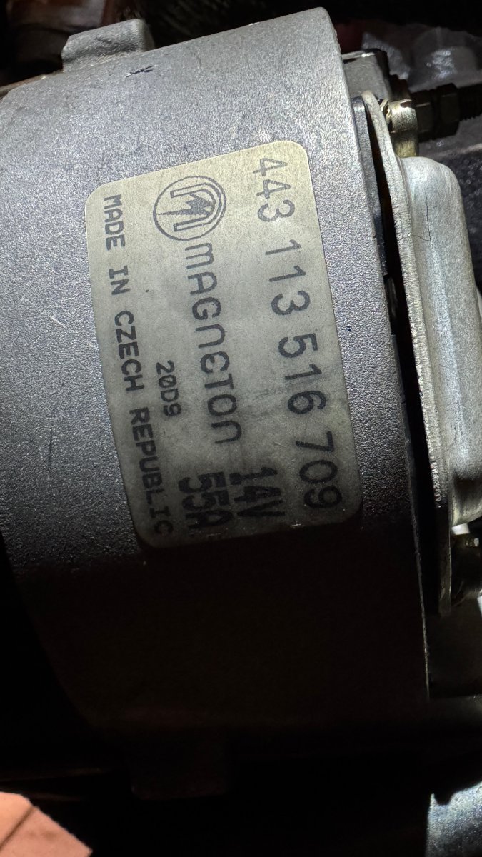

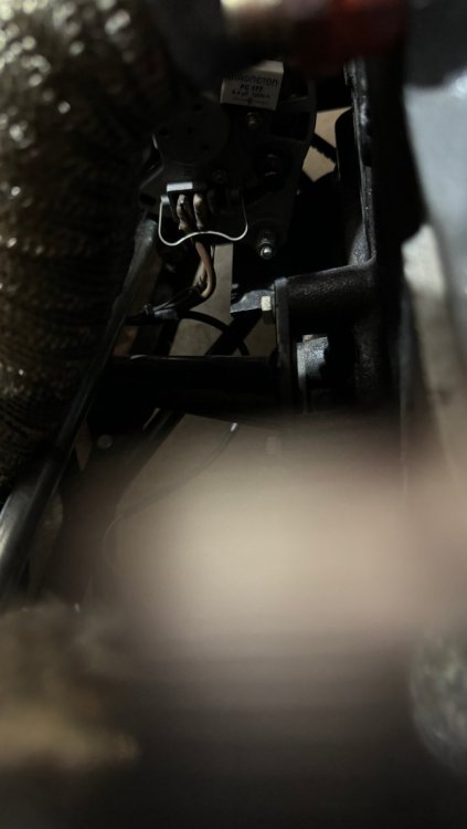

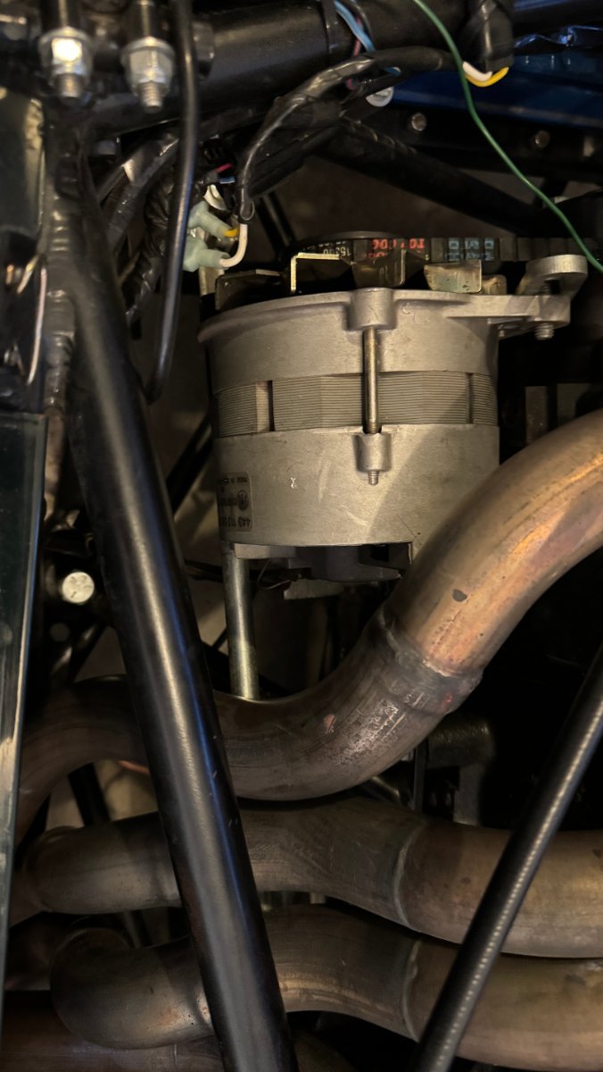

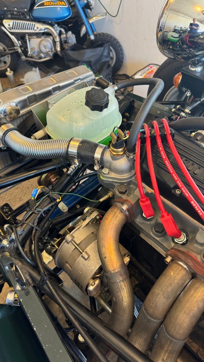

The real estate for the alternator is very limited and I am not sure whether it is the original unit (see attached picture)
All the attachment points look very much stock.
There is an angle iron attached to the bottom of my engine block, which serves as the mount for the two alternator bolts on the bottom
and there is the usual adjuster at the top which mounts to the front of the engine.

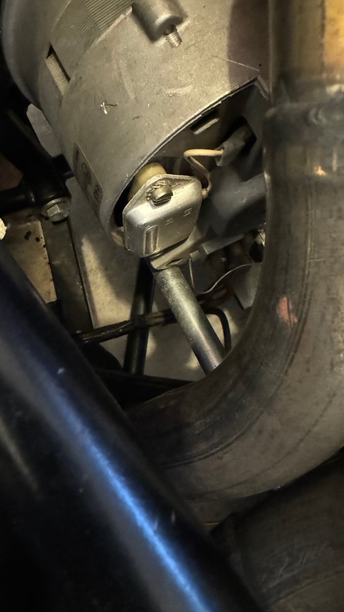

The electrical connections are three spade connectors which seem to have the cover/housing missing.
The Alternator is a MAGNETON 14V 55A unit made in the Czech Republic.
Part number is 443 113 516 709
Additional code on the sticker: 20D9 (could be a date code)

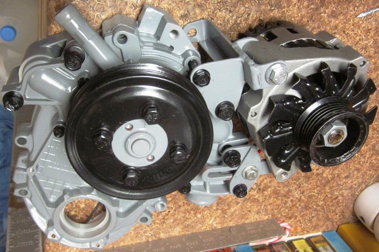

Just to back up MV8’s post. Photo is out of the Superformance Installation Manual. Engine kit came with a Geo alternator. Similar idea in small packaging. Maybe this will help.

It looks like the main issue here is alt case diameter between the steering shaft, block, outboard chassis rail, and the unfortunate routing from Cat (must have built the prototytpe header on an engine without an alternator). I have many types of alternators in-hand (mostly ones I've replaced) that I could compare dimensions on. Applications are 60s-90s. I have engineering and fab experience if you'd like any suggestions for mounting the geo alt. Here is a bracket I designed and fabbed for a CS-121 on a chevy v6-60 in a Triumph.

There is NO space.
I pulled the alternator today and it barely (as in nearly not) cleared the exhaust/frame/ steering column.

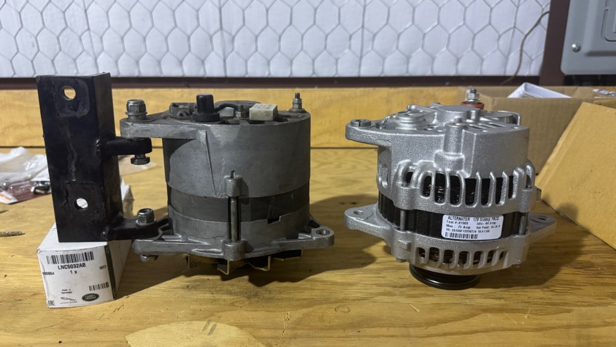

The Geo Metro alternator got delivered and it seems somewhat smaller but needs bracket fabrication.

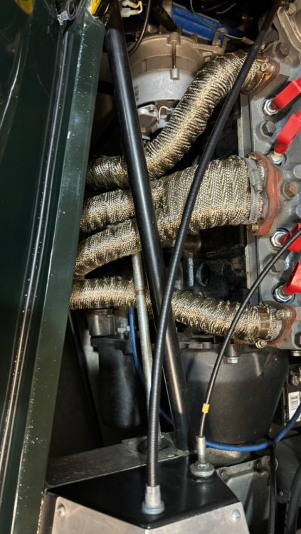

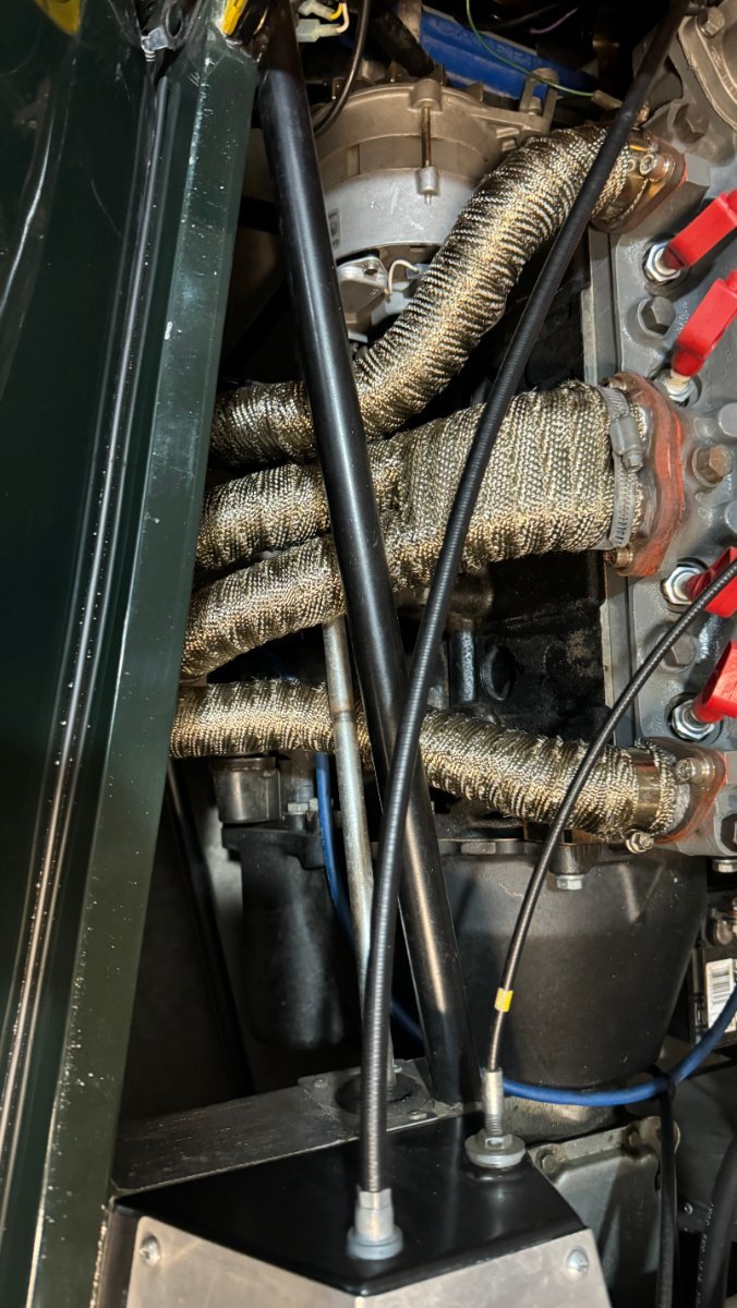

If you'd like some bracket suggestions, post pics of the old brackets installed without the alternator in the way.
Nice Fabrication!!!!
As soon as I find some time I'll send pictures of the brackets installed without the "Boat Anchor"

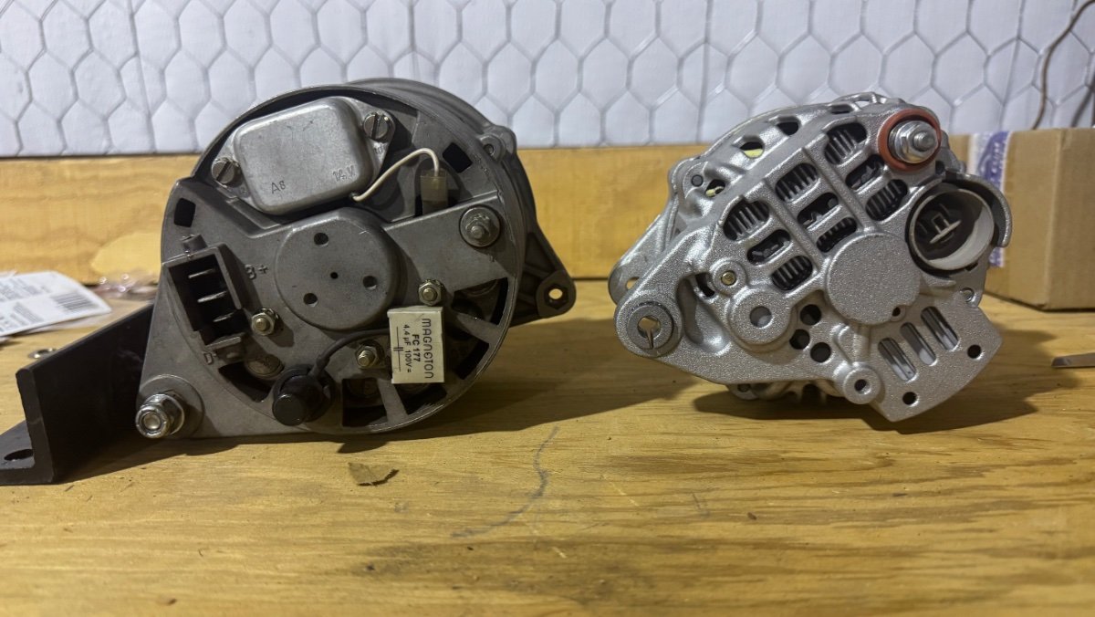

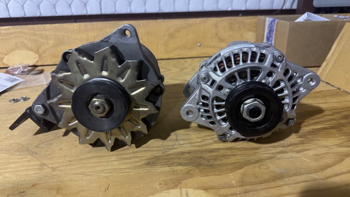

Here are a couple of shots which show the size difference.
in comparison the “original” alternator (left)IMG_7249.thumb.jpeg.e45e0d62f4ac7bc93148f766a7f2650a.jpegIMG_7253.thumb.jpeg.4eb9c7baf91c75cdee2abaf5482a0b13.jpegIMG_7252.thumb.jpeg.5a3ee6fea6739afae54fa263ecf5ce17.jpegwhich probably was a mid 2000s replacement, because Caterham supposedly used Magneton Alternators during this time frame demands a blood/skin sacrifice where as the Geo Metro (1996) one leaves the mechanic’s hands somewhat intact.
see for yourself
the clocking of the new alternator will need some bracketeering!

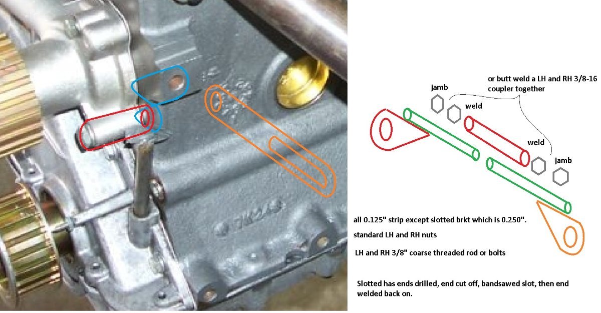

Looks like the original pulley has a smaller shaft so it may not fit the geo. Appears that all you will need is a reworked upper bracket or just make new. The upper just tensions so it can be a 90 degree tab on the block with rod ends and a coupler if you want. May need to shim the lower brkt between the front ear and the alt to set the belt alignment; possibly shim the rear as well depending on the gap to the geo floating bush.

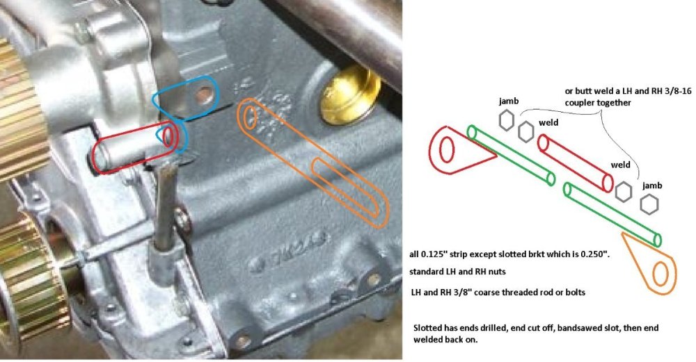

Here are a couple ways to make the alt adjustment bracket. No welding if you source an adjuster.
Edited by MV8
