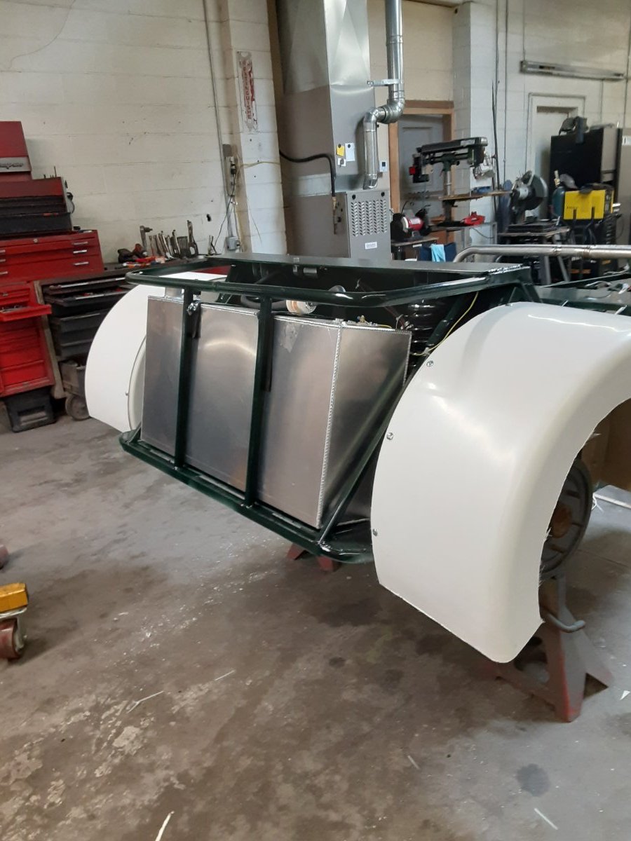

Alex-Ks1 Posted Tuesday at 11:25 PM Posted Tuesday at 11:25 PM I saw the link for a Gas tank, I made my own ,think I spent 35$ doing it, made it from 1/8 inch T-8 aluminum.Its 19 gals and the top plate for the sender , pick up is 4.5 inch in Dia. TIG welding is not as hard as one would think ,just takes practice.

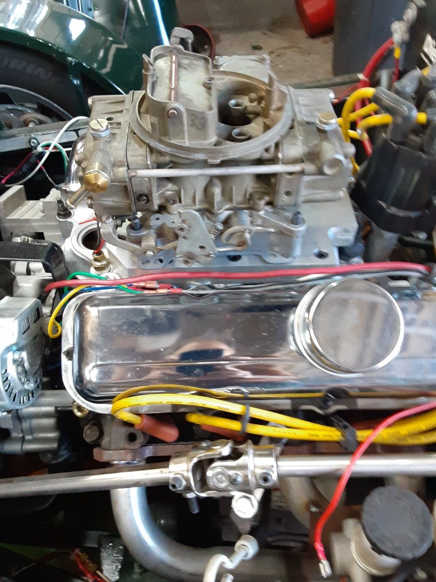

Alex-Ks1 Posted Tuesday at 11:40 PM Posted Tuesday at 11:40 PM The 7 needs a big gas tank it has to deal with a holly 500 CFM ,carb on a Hi perf, V-6. No one makes a holly manifold for this engine so I made my own .
