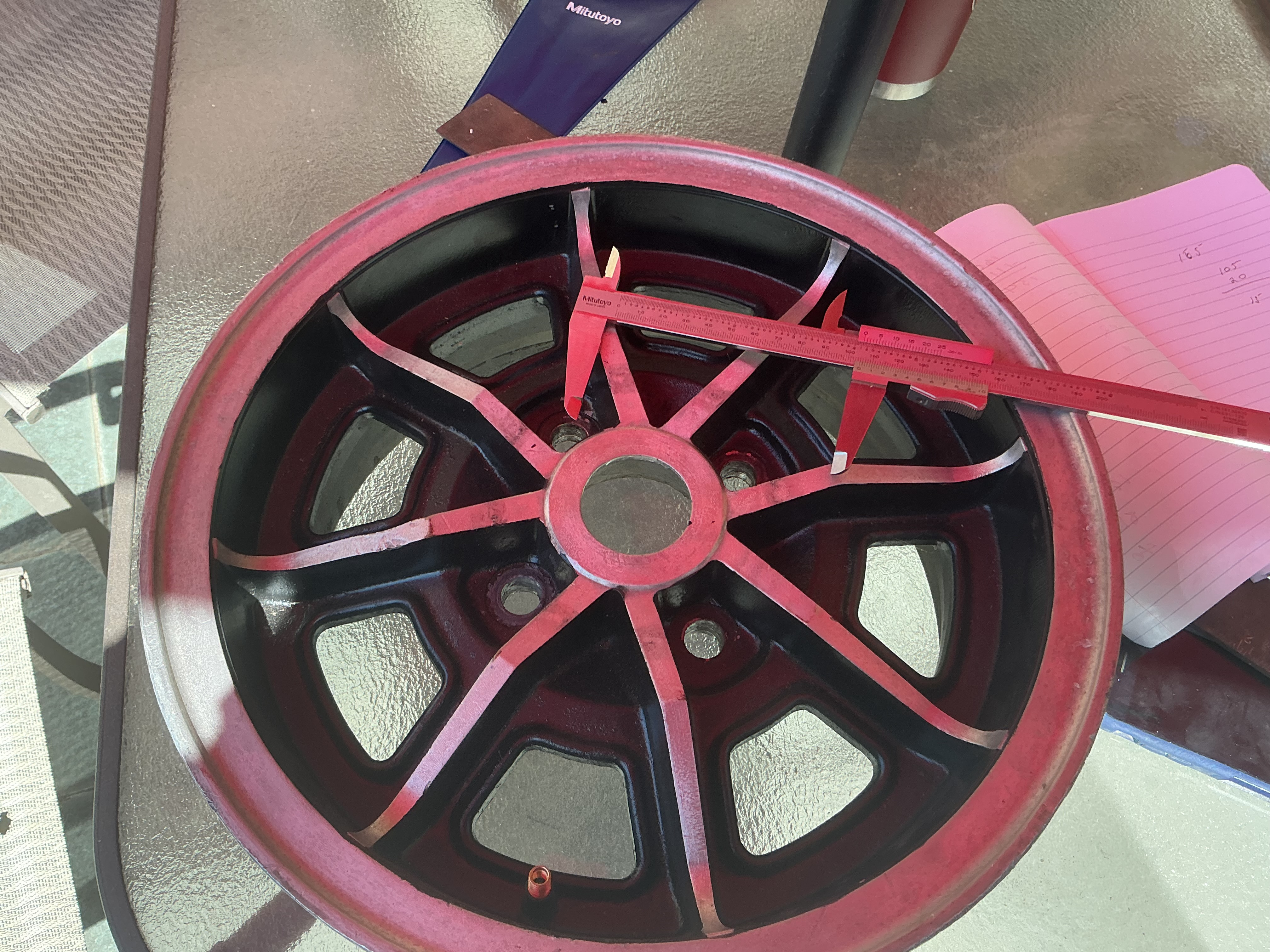

Lotus had offered optional Lotus brand alloy wheels similar to the Dunlop D1 in 1970. They were also used on the S4. Specs on these were 13x5.5 4.25 pcd. These are very rare today, however, John Brown Wheels in the UK makes replicas of the D1 in the correct pcd and an offset of 16mm which are probably better quality than any 56 year old wheels you could find today. I found a set of original Lotus Brand alloys for my S4 on this site. They are still in the box and need to be refinished. If I find they aren’t true I would have been better off to go with the modern replicas. I got one of my Lotus brand wheels out this morning and got an offset of 15 which +/- 1mm close enough to 16mm.

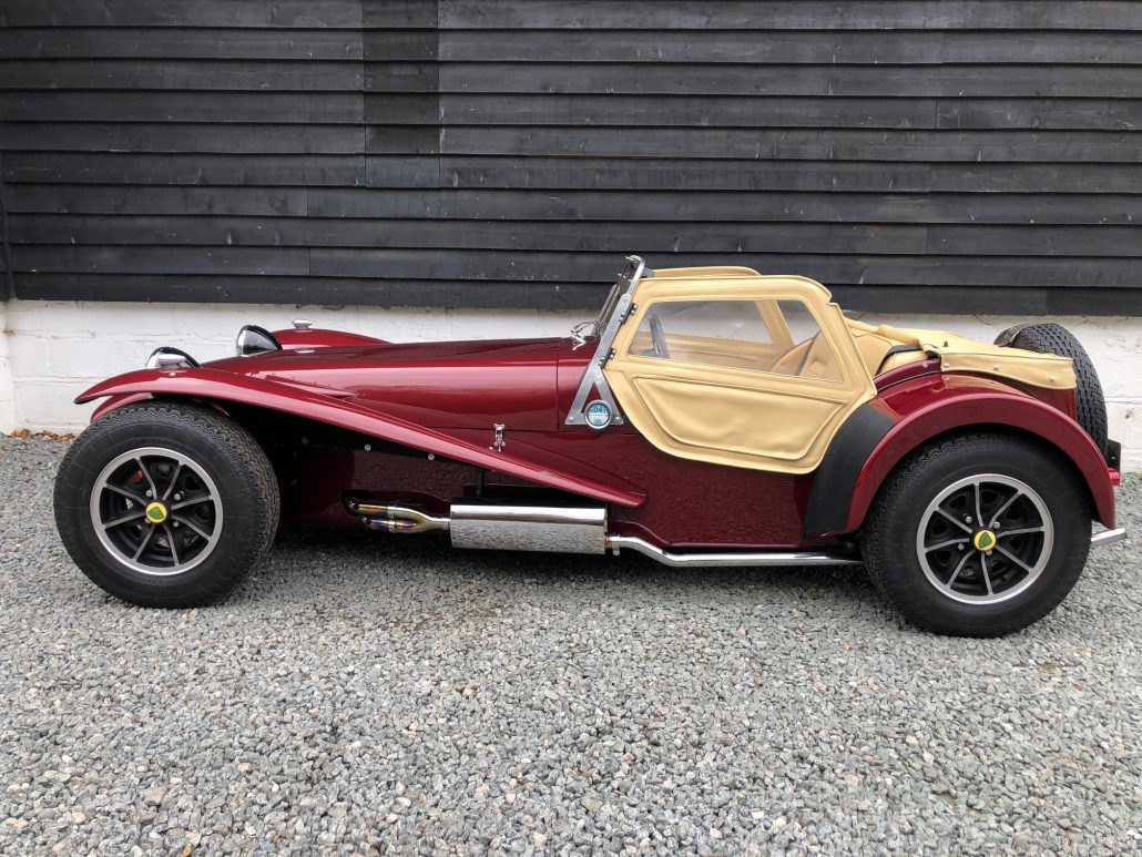

Here is a link to an original S3 with the Lotus Brand wheels
https://www.gpsevens.co.uk/portfolio-item/lotus-super-7-s3-holbay-s-1969-the-only-factory-built-lotus-s3-in-existence-5949

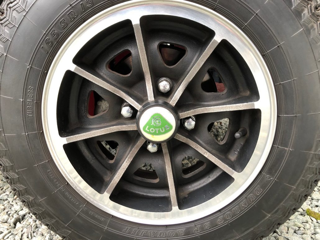

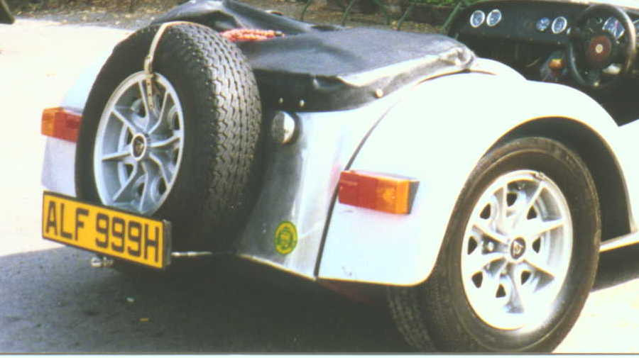

@San Augustinethanks for the detailed post about the wheels. I find it interesting that the wheels on the gpsevens car have a triangular relief where your wheels have a trapezoid shape which is what I have. I’m also running the Pirelli 185/13 tires on my S4. Great wheels!

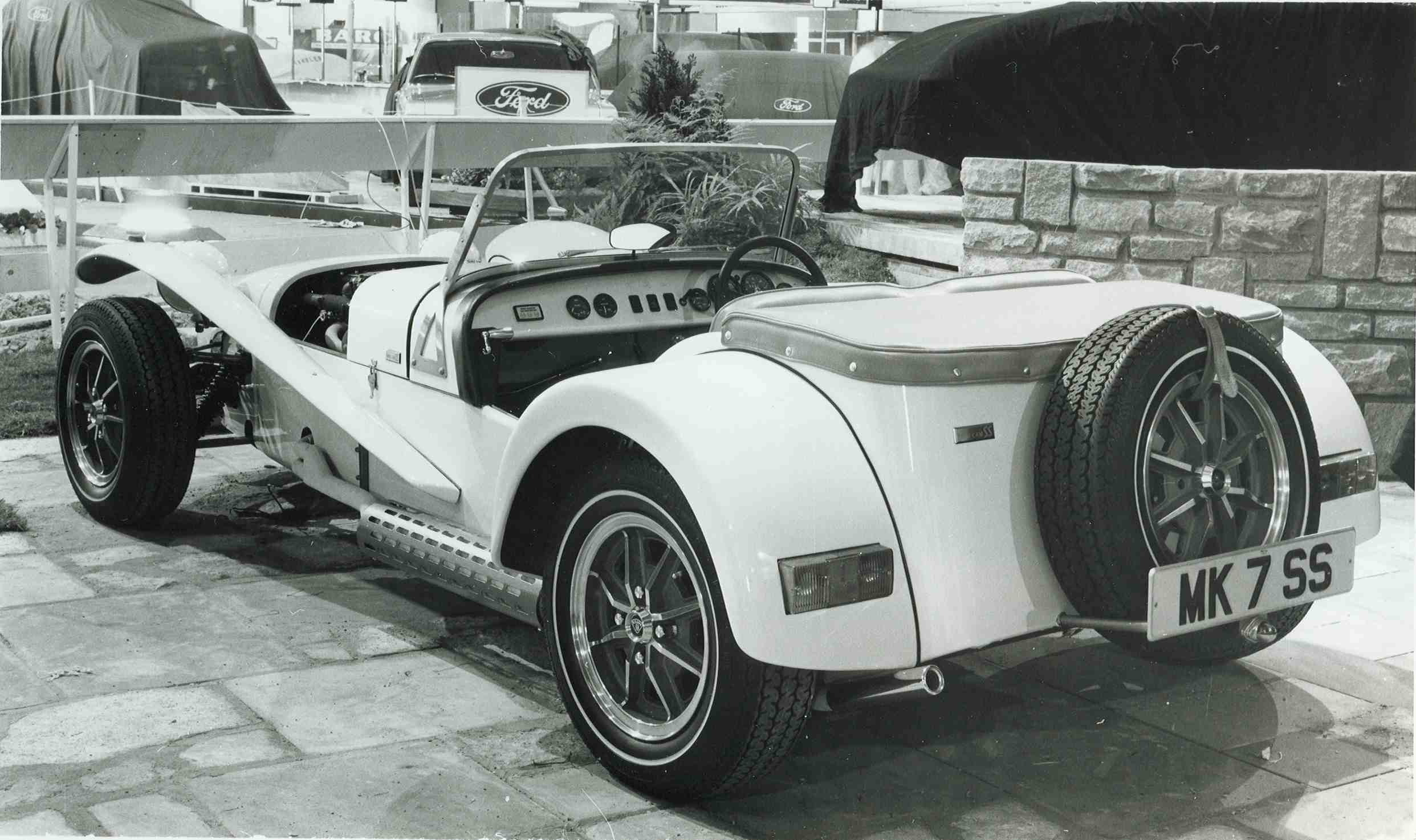

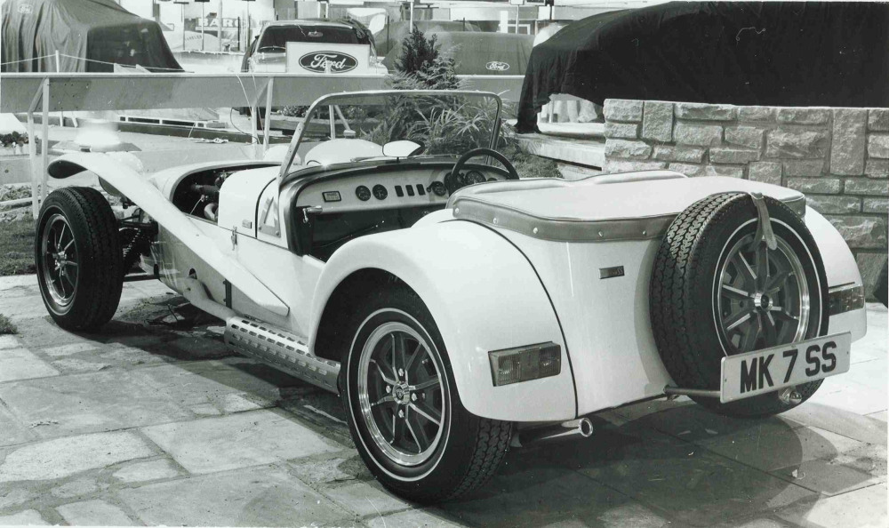

@Carz01You are absolutely right! I just noticed it myself. I checked some other pictures and I think that the Lotus Holby on the GP,sevens site has different wheels. I found this to confirm the Brand Lotus wheels on a Lotus S3 twin cam from the Tony Weale book p. 223 and they are not triangular as well this advert from about 1970. And also this pic from of the Lotus Seven twin cam from the Earles Court motor show of 1969.
Edit - at the bottom of this page Link explains the difference between Dunlop wheels and Brand Lotus. Both were offered for the S3.
