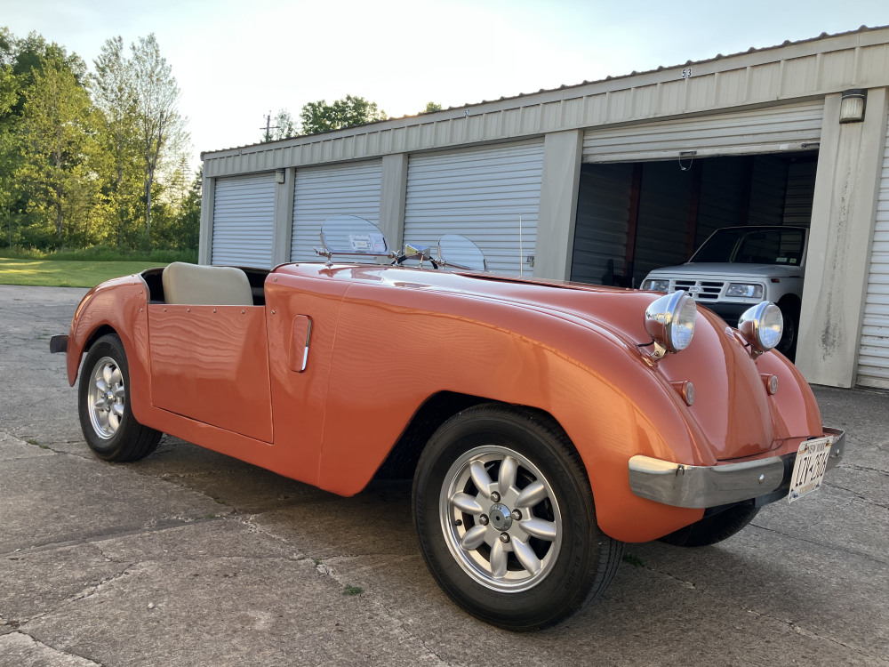

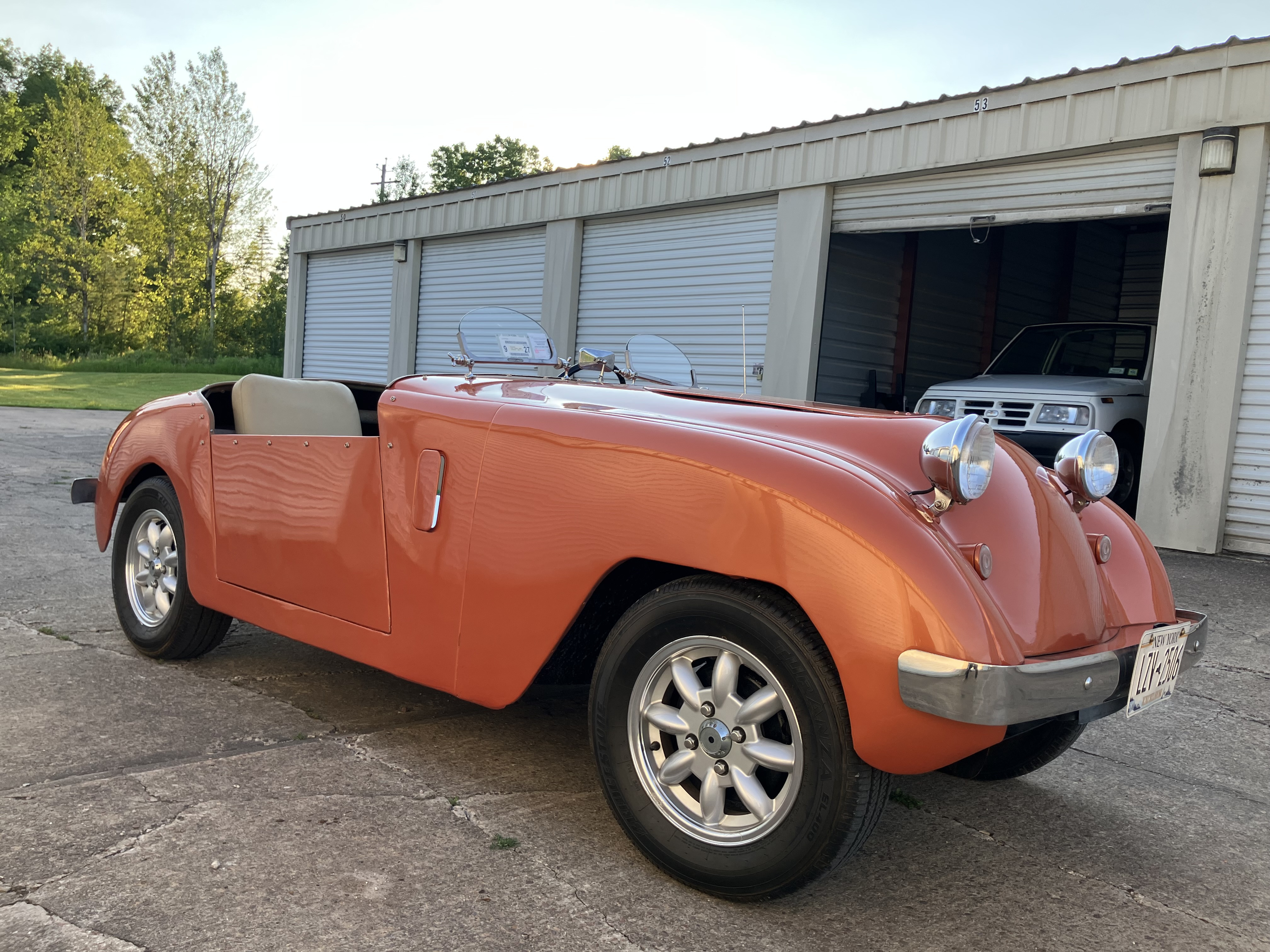

m2711c Posted 21 hours ago Posted 21 hours ago 47 minutes ago, SENC said: People's reports on wind reflectors are that they are hit or miss. I have a pair from Redline, and they are a marginal improvement, but I'd rather have them on than off. Of course, the issue isn't really wind, but the aerodynamics (or lack thereof) in these cars. Between the brick shape and the nearly vertical windscreen, at any speed you're developing a big low pressure area in the cockpit - and sucking in the air. Deflectors MAY shift that slightly away from your ears. I've long thought a better solution would be to find a way to route air into the cockpit centrally - either a duct underneath into the cabin or a Miata-style windscreen mount. yeah, I’ve had a similar thought. I was thinking some side vents near the bottom of the footwells should help with clearing the excess heat out of the footwells and help alleviate the low pressure developing behind the windshield. Something like you see on this Crosley Super Sports 1
