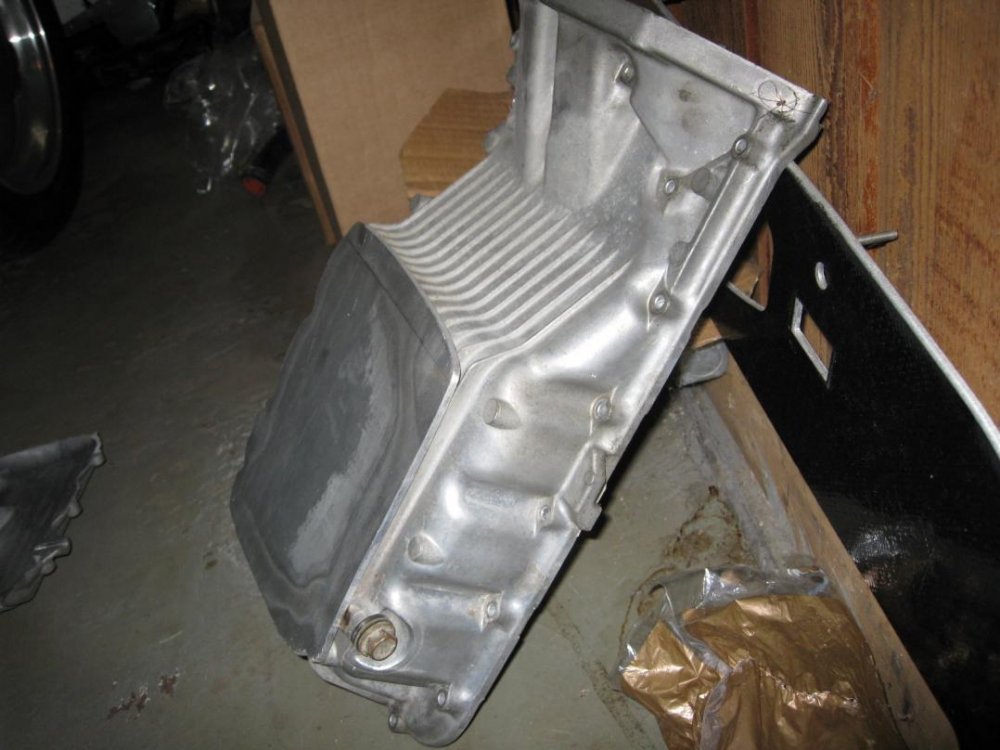

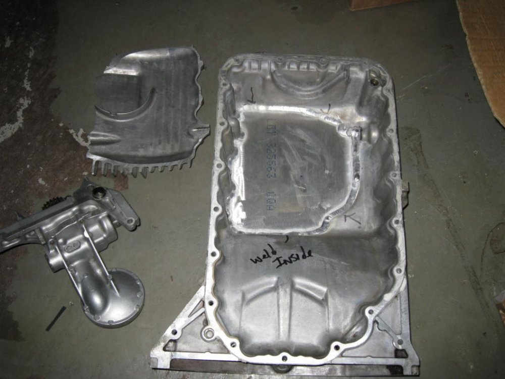

Mondo Posted February 28, 2009 Posted February 28, 2009 After grinding my oil pan down once and seeing Kevin do the same at Buttonwillow I had a skid plate made up. Quarter inch aluminum plate.. only lost about 1/2in of clearance. I do have to undo 6 bolts to change the oil (small price for piece of mind). http://www.usa7s.com/aspnetforum/upload/1947019395_Lotus shock bracket 003.jpg http://www.usa7s.com/aspnetforum/upload/1036560826_IMG_2173.JPG http://www.usa7s.com/aspnetforum/upload/1422298942_IMG_2172.JPG

Arya Ebrahimi Posted March 9, 2009 Posted March 9, 2009 How come you guys don't just bond the skid plate to the oil pan? In the offroad world, many people just weld a piece of 3/16" plate to the bottom of the oil pan to distribute point load impacts. Seems like where abrasion is the main concern, simply bonding or welding a piece of plate to the bottom would be sufficient and maximize ground clearance.
Mondo Posted March 9, 2009 Author Posted March 9, 2009 It takes more than gooping up a sheet of aluminum and slapping it on due to the finned oil pan (see the pics of what it took) . In the foothills around here it's not unusual to have little rock slides and have rocks around the size of your fist, or bigger, in the roadway as you come around the bend. I wanted to deflect those too. I guess I could of cut the bottom of my oilpan out and bonded a plate that had a 45 degree angle in front of the oil pan.... seems more work than what I had done.
