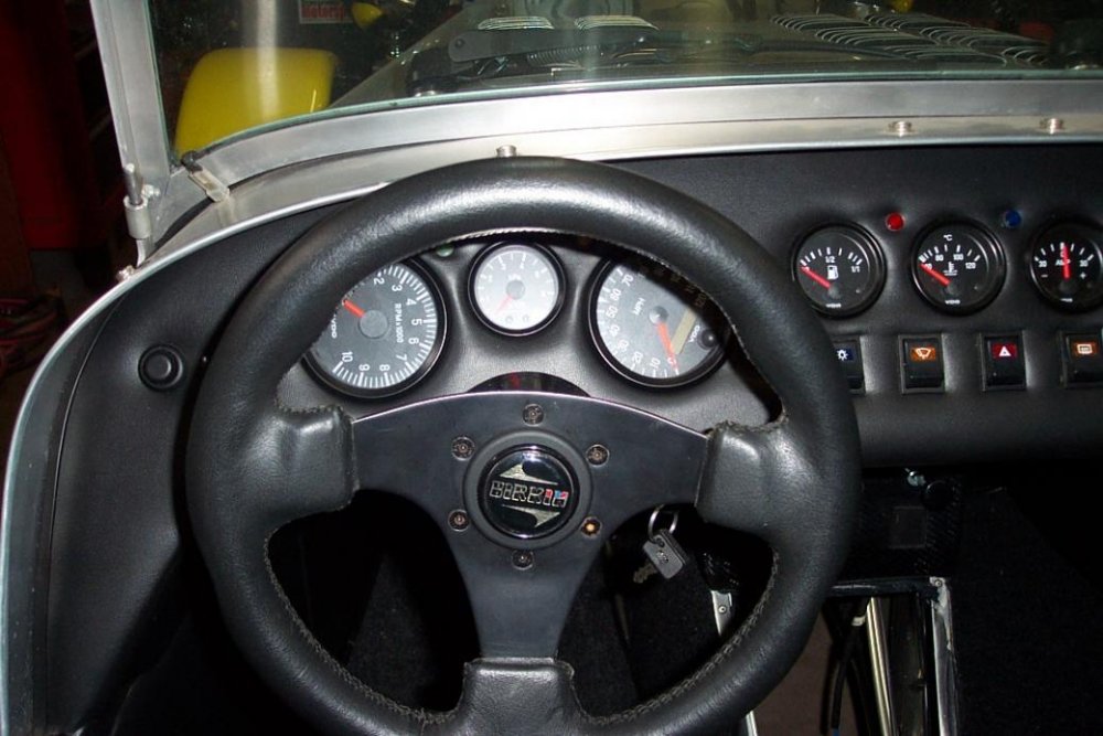

My problem was the steering wheel blocked the important parts of the speedo and tach. Some racers twist their gauges so that the needles point straight up when everything is right, so they only need a quick glance and do not have to read the numbers. This inspired me to exchanged the speedo and tach from their original positions, and then twist them so I could see above 2000 rpm and up to about 70 mph without ducking. An image is attached (I hope).
Same exact thing I did with my Birkin. Works very well.

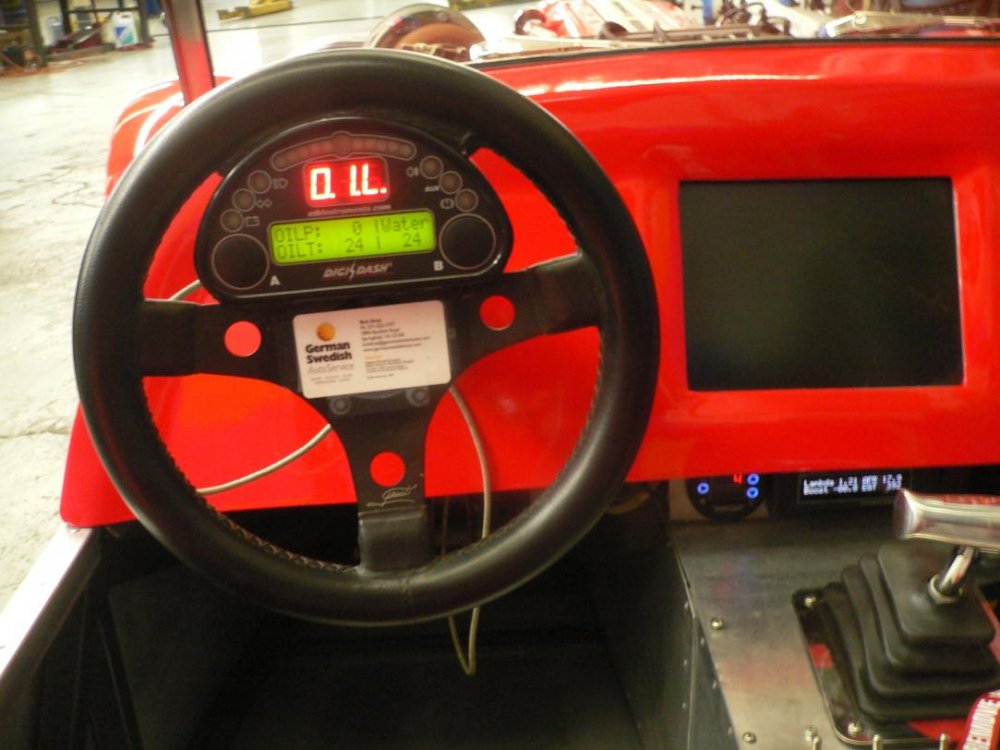

Put it in the steering wheel!
