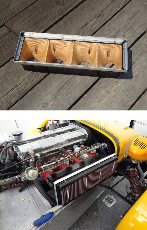

My 6 year old ITG foam filter was finally falling apart and I did not like it anyway: very messy with the oil impregnation and prone to detonate when freshly oiled. Also very expensive to replace and hard to find the rounded version.
So I looked around and found the the Chevy HHR air filter fits pretty well into the bonnet cutout. The biggest challenge was the air box and I ended up combining this with the trumpets which also allowed me to go from 63mm trumpets to 90mm length. I cut it from a thick laminated plywood block on the CNC, but I used the K&N version of the filter because it is only half as tall as the OEM paper filter (and looks better). See pics below. I braved the 103 degrees heat in the trailer today and installed the contraption. So far so good, did not drive it yet but I don't believe there will be much difference.
Thanks guys, I will do some data logging and see if the fueling needs to be changed. I would guess not and if so only at WOT.
I had seen the test results from Emerald a while ago and the crazy long tubes obviously have an effect. But the conclusions drawn for the smaller changes are a bit shaky, based on the charts. Or at least if there is a measurable change it is also quite small. Maybe I take the car to a dyno again sometimes and compare with the old setup.
