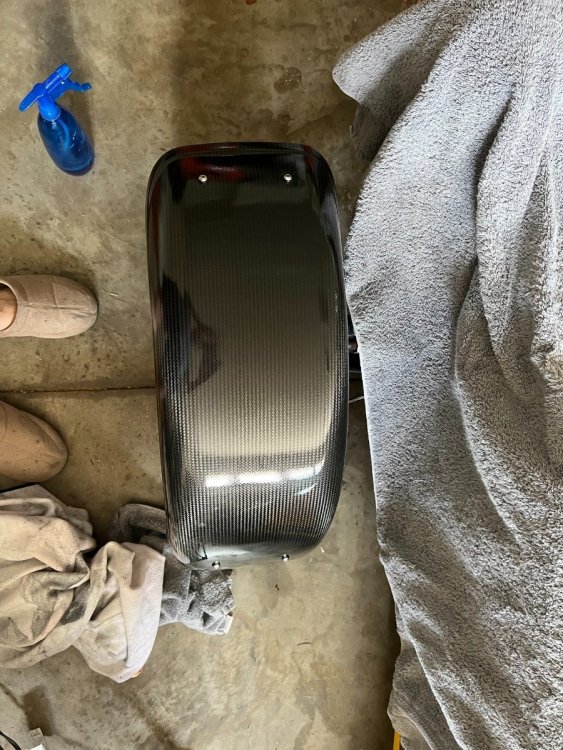

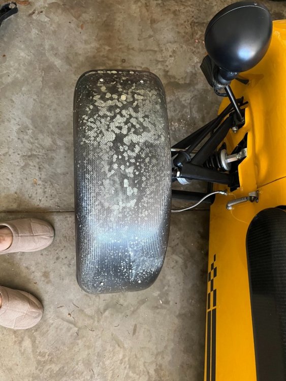

Removing water marks from carbon nose and cycle wings
jeffs replied to das76's topic in General Sevens Discussion
While I was absolutely terrified doing it, its not actually that hard to reclear the fenders so the spots don't come back. 1) Clean with wax/tar remover 2) Wet sand with 400-800 sandpaper (opinions vary, I mostly used 600) 3) Clean and clean and clean and clean some more with alcohol wipes 4) Spray with a good 2k clear coat (I used spraymax) -
