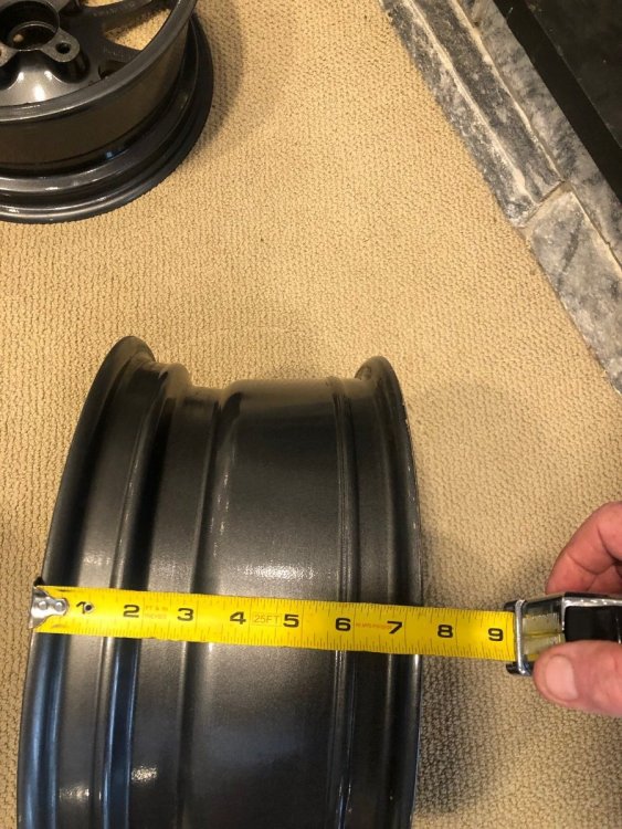

Yes, sorry guys, the 13" rims have been sold.

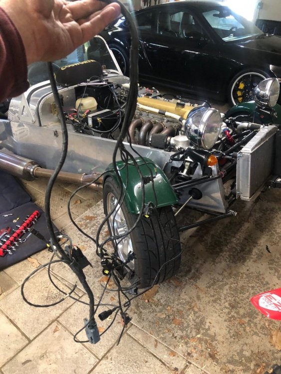

My #3 cylinder went cold again. It happened the first time at the track and switching coils in an attempt to diagnose the problem "accidentally" cured it and I was able to finish the weekend. Now, with all new coils, it's happened again. Dead #3 cylinder and a black sooty plug again. So now it's war. if it sparks or squirts it's getting replaced. I decided to replace the 20 year old engine wiring loom as well. We do that after 10 years on our race cars. SBD in the UK was great in helping me determine exactly what I need and getting it to me quickly. There are soo many sensors and connections, but everything fit perfectly. It started right up and runs smoothly on all 4 cylinders now. I think there must have been a short in the harness.

Actually. the buyer of the 13" wheels realized they wont fit his bolt pattern so they're still for sale too. I mounted a brand new set of Toyo Proxes R888R 205/60R-13 to the rear wheels. I'm bringing the whole lot to NJMP this weekend. Who wants them?
