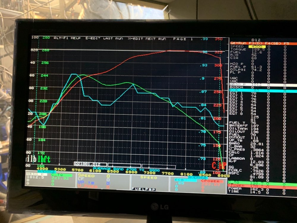

  3. It was dyno’ed on 93 octane pump gas
  4. It looks to me like it "wants" to live between 7,500 and 8,500, where the power stays about flat at max. But... given that I'd rather not turn this one into a coffee table, I'll keep it below 8,000.
  5. Final pull: 325 hp @ 8.100 244 tq @ 5,700

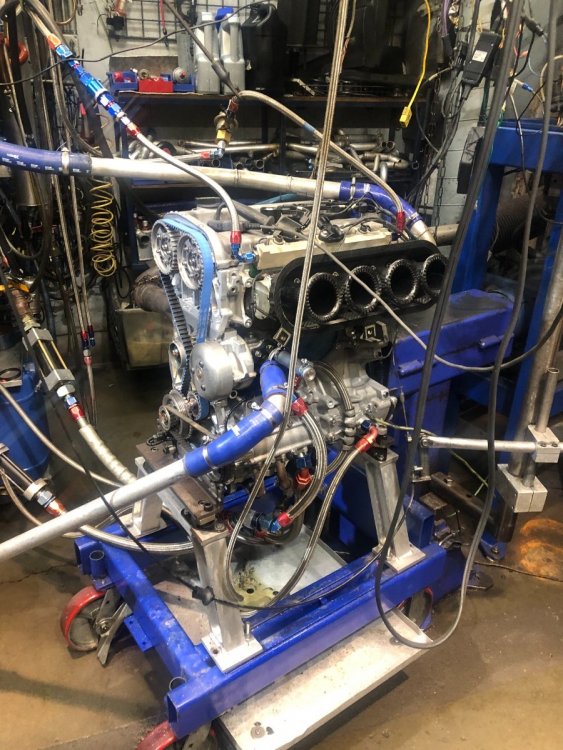

  7. Well it’s been about a year and a half since I blew a hole in the block of the 2.5L MZR engine in my SV at a NJMP track day late in the summer of 2019. Covid induced delays at my engine builder Hasselgren Engineering slowed things down quite a bit. I’ve suffered a fairly severe case of Caterham withdrawal as a result. My wife and I are on a trip out to Santa Clara, CA to visit our son and we drove around the Bay area doing some hikes and stopped for lunch in Berkeley, where Hasselgren’s shop happens to be. Paul Hasselgren has been building the race engines in the Formula Atlantics my son and I have been racing for quite a few years so I naturally wanted to pop in and pay a visit. It was pretty much pure coincidence that this happened to be the day my engine was on the dyno. Paul has done quite a bit of development on it and we went back from the 2.5L stroker crank that failed in favor of a Billet and balanced 2.3L crank. The engine is basically a short stroke 2.5 MZR with a bigger bore and a balanced billet crank from a Cosworth Duratec The whole front end of the engine has been redesigned to run a belt drive for the cams. I was hoping to get a little more power than my previous 2.5 MZR with this higher revving configuration, but I was quite surprised by the result. 312 hp at 7,500 and still climbing. 241 peak torque @ 5,900. Paul says he’s not done yet. He thinks he can get 320 out of it, which will be limited by the barrel throttle dimensions. A redesigned barrel throttle can unlock even more. Paul cautioned this one will hit hard. Good! I can’t wait 😛
