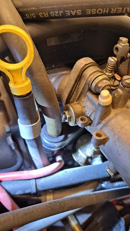

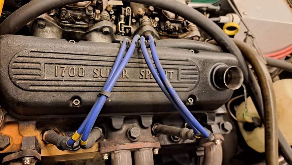

Thanks for the info. Normally oil pressure at idle (100 rpm) is 2 bar = 30 psi so that sounds good. This situation came to my attention when I saw a small amount of smoke coming up through the louvers on the bonnet. There was oil sprayed around the engine bay and apparently some found its way to the exhaust manifold. I found the plug on the bottom of the catch can, so emptying it will be easy. My plan is to replace the oil filler cap, empty the catch can and see what happens. I've attached a pic of the valve cover so someone can tell me what oil filler cap to get. the diameter of the oil filler is about 1.5". -
The engine is a 1700 Crossflow. The first image is a catch tank for oil. There is a clear vertical tube to show how much is in the canister. The tube is now full of oil. It was empty for a long time. The other end of the tube connects to a sort of box which connects to the crankcase. You can see the other end of the tube in the second picture going down beside the dipstick. I may have overfilled the crankcase. It loses oil pressure when the dipstick shows half a quart below "H" so I keep it above the max mark on the dipstick. May or not be related, but the oil filler cap on top of the valve cover disappeared. What part do I order to replace it? I'll be away for a few days, looking forward to any info I can get.

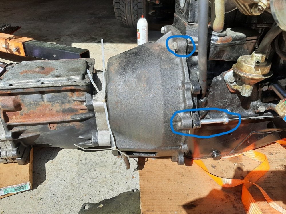

These tips made a huge difference. First I blocked up the engine so the top of the valve cover was horizontal. Then I moved the transmission in close and blocked it up in position. Then I used 4" bolts as shown in the big blue circle to line it up. Picked up the transmission in the middle. Slid right together, no issues. 10 minutes just like its supposed to be. If I had it to do over, I would also use 3/8" threaded rod (or sawed off bolt) in the top holes for extra help. fun fact to know and tell: The bolts which go from the engine side into the bell housing are 10mm x 1.5. The bolts at the top (small blue circle) which go from the bell housing into the engine are 3/8 x16. You can put a 3/8" bolt in a 10mm hole and it will screw in no issues but it will feel a little loose. You will go to Home Depot and come home with a 10mm bolt and it won't fit. If you try to put a 10mm bolt in a 3/8" hole, it won't go. This is not the first time I have made such a mistake and probably won't be the last. Thanks again for the help! -

In the process of changing the clutch in my Crossflow with a T9 transmission. New clutch is installed on the flywheel. Now I can't get the transmission mated to the engine. The plastic clutch tool inserts fairly easily. It's certainly not loose but it goes in and out with no issue. The transmission mated up with the bell housing is removed so I know it can work. It took some (well a fair amount) of futsing to get the shaft lined up and a push, but it went in smoothly. I'm using the engine crane to position the transmission. Sometimes I have positioned the trans a little low with the crane and picked it up in my hands. Lots of wiggling. I am using the gap between the bell housing and the back of the block to gauge alignment: making the gap equal all the way around. After an hour and a half of trying, no success. Feels like this should have been done in about 10 minutes. Any tips or tricks? Thanks in advance.
