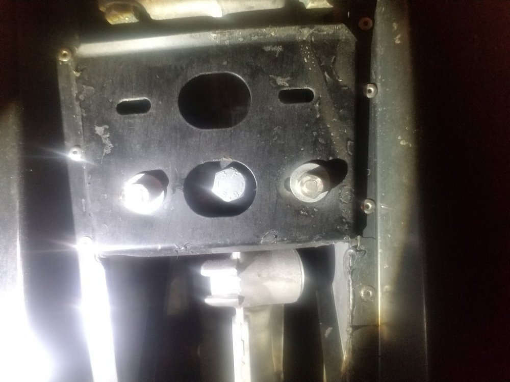

Nope, that's the transmission mount.  See bottom photo which shows the alignment between the transmission mounting pad and the fill plug.  If your transmission was modified with a drain plug, it would be in the main case which is the low point (painted black in the photos).

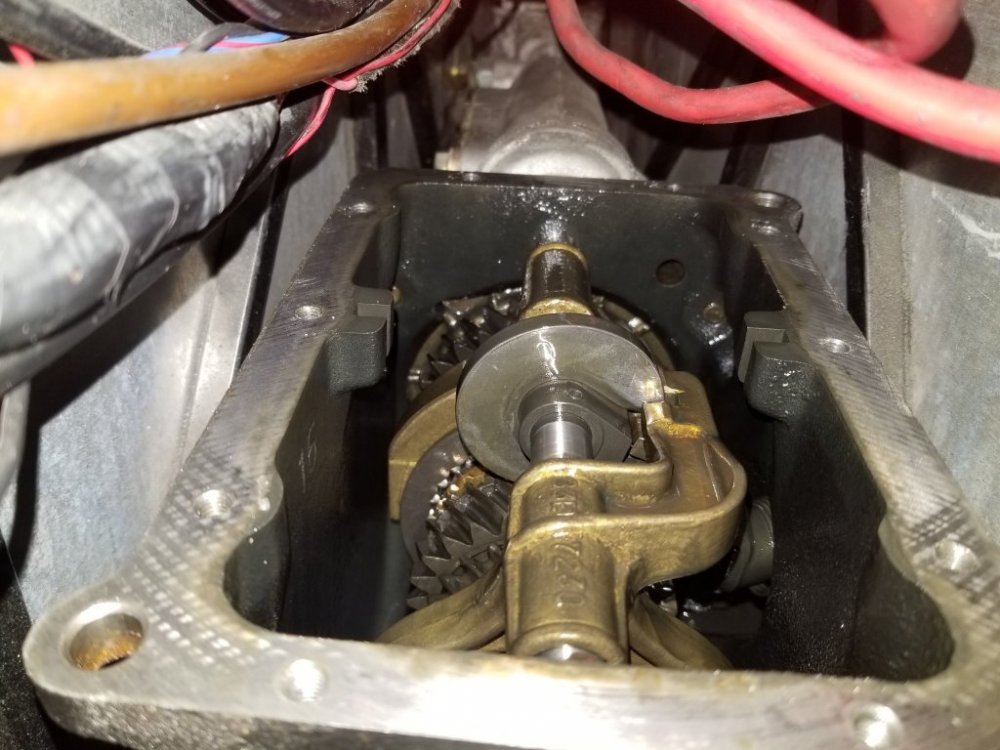

The top lid is a tight squeeze to get to the rear bolts but it is off
Still easier than getting that dam drain plug out (might have to get a skinny armed kid to get them back in)
 I have drained the oil best I can by jacking the rear of the car and using a high $$ Liquid Transfer tool from Harbor freight
https://www.harborfreight.com/multi-use-transfer-pump-63144.html
Which worked great, although there are a lot of gears in a small space so it took a few attempts stuffing the tube down into the case to insure I got to the bottom and retrieved as much oil as I could, I also jacked the back of the car to try to get all the oil to the front of the case.
I retrieved about a Liter and assume I have 99%+/- of the oil which translated to about 750ml so it was low
I am going with the 1.6Ltr +/- and the 144mm measurement concept and using Redline MT-90 living in Florida and the monthly track day I thought it was a better option than the MTL-90

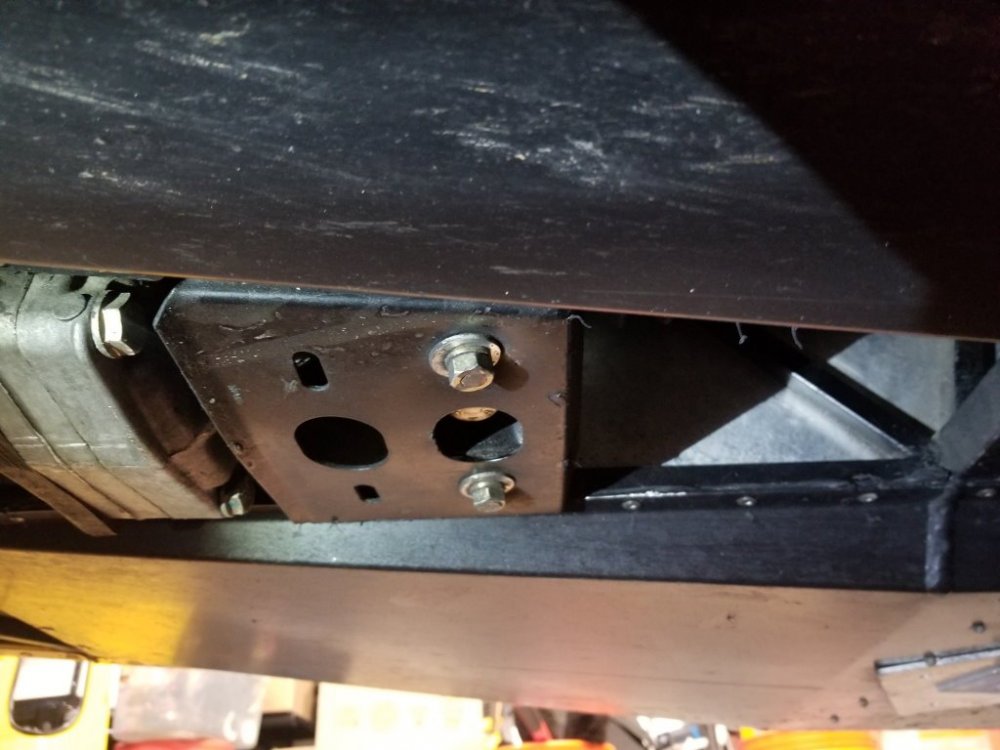

I am using the oil dipstick for the car to gauge the level from the front of the gear box (see arrow)
The gasket on the lid looks to be in great shape so I will reuse it (unless I hear "Don't reuse the gasket)
I realize to most gear heads this is kinda a trivial undertaking but I hope it helps one or two members who are not so....... and want to have a crack at it
Thanks again for the assistance and advice.

Good job! The vent for the transmission is that pin hole in the bump on the top of the cover. Take care to push brake cleaner through it to make sure it is clear. It serves to provide a fine oily mist on the top of the transmission over time. The British anti-corrosion program!
