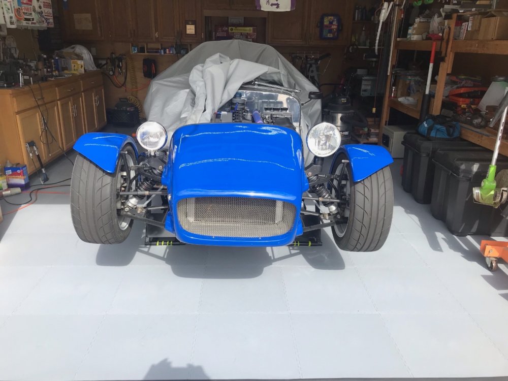

My Birkin came with 7" headlights. I have taken my time in considering going to LEDs, rectangular housings and other options because they REALLY hang out there in the breeze. As tight as I get everything, they still go a little out of adjustment after a couple of freeway drives. I finally found a nice 5 ¾" unit (replacement for earlier Harley) that meets nearly all of my criteria. Smaller, similar visual appearance, same H4 bulb and the chrome finish is much better. I am mounting them about ¾" lower as well. I think I may also have solved the adjustment stability issue by using "Nord-Lock" lock washers. I'll provide a few more pictures as I complete the installation over the next day or two.
Fastg found the link. Available from McMaster-Carr and others. They work great and are reusable. Perfect for an application like a headlight mount that is susceptible to vibration and the elements. I also swapped over to 18-8 SS nuts and bolts.
Wrapped things up today. I like the lower profile. These assemblies are slightly more rounded as well. There is a small (3w) high beam indicator light on the top of each housing. The Nord-Lock washer is evident in the first pic. The ss braided hose is from a hot rod supplier. Teflon lined to prevent chafing. It provides a nice detail to the car.
