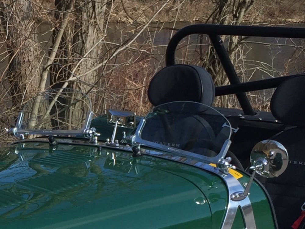

For a true vintage look, you can get a traditional center mirror as used on many early British cars, such as Sprites; and for the side mirror(s), a Jaguar mirror has a nice stem which raises the actual mirror portion to a usable height and it can be reversed to use on either side if you want.  Both can be obtained from Moss Motors: center mirror Halcyon #770, side mirror xks.com #223-310.

Today I found the center mirror on the internet by just going to google and searching for “Halcyon 770 Interior Rear View Mirror”.  This is not a Moss Motors site, although I thought I had obtained mine through MM, however, that was several years ago.  It seems you have found the side mirrors on the MM site, and, as I had mentioned, they are reproductions of early Jaguar mirrors and can be mounted on either side by merely reversing the attachment of the mirror to the stem.
if you have questions regarding my process for mounting the “hoop” as well as the screens and mirrors, please let me know.

I get a good idea about the positioning from the photo. I assume that you have to counter sink the screen and mirror holes in the back of the hoop and use stainless countersunk screws to attach them. Looks like the mirrors come with the screws needed but not the screens. (not very nice considering the price!)
Looks like you used domed nuts on all fixtures.
There are 2 small holes pre drilled in the hoop about 3 inches from center. Is this where you put the inside leg of the screens?

Yes, I used those existing holes as you observed.  On the underside of the hoop I countersunk the screws for the screens and mirrors so as not to damage the scuttle.  And, as you note, used chrome acorn nuts on the top side.  The nuts were a bit too wide to fit flat into the holes on the screen and side mirror so I had to fabricate a spacer of about 1/8 inch cut from small aluminum tubing.  Also, if you haven’t installed the “Easy Swap Retaining Channel”, which can be obtained from Caterham, you’ll want to do so.  It provides a more secure fastening and allows very easy swap from the Brooklands hoop to the stock windshield — only four bolts needed (two on each side). And in the future you won’t have to remove the kick panels for access. The captive nuts on the retaining channel are M8x1.25. I suggest getting some nice chrome button head bolts with hex drive for that application.

Regarding the bolts and nuts used on the screen and mirrors, I don’t remember the specific size, but I know I took the screen pedestal to the hardware store and just found some stainless steel countersunk socket head bolts that fit along with washers, lock washers and acorn nuts.  And, if you don’t already have it, you’ll need a tool to countersink the holes on the bottom of the “hoop”.
