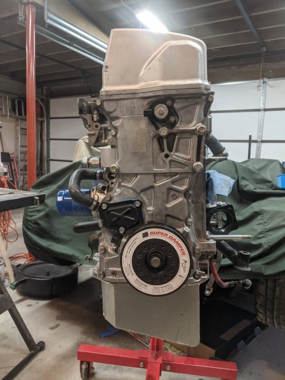

fastg Posted December 14, 2021 Posted December 14, 2021 Parts, gotta love parts. Will install over Xmas and dyno test in the spring. Should really liven up the engine. This package cost twice the amount I paid for the engine:) The engine is a Honda K24A2 out of a 2007 Acura TSX. Graham

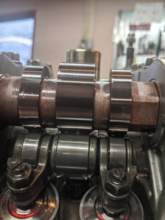

fastg Posted December 14, 2021 Author Posted December 14, 2021 Dual lift inlet and exhaust, variable cam timing on inlet. Mapping is complex, you have a map for each lift level and cam timing. You have a low lift 0 degree timing and fuel map. low lift 10 degree timing and fuel, low lift 20 degree timing and fuel, and so on. Then the same for high lift. A LOT of maps, but they is one reason they run so well you can really tune the details. Graham

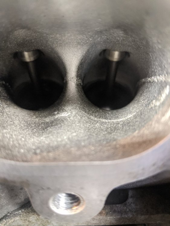

fastg Posted December 22, 2021 Author Posted December 22, 2021 I was doing a little setup work for the cam swap, engine out, new 6 speed transmission in. I was inspecting the engine and the inlet valves/ports are amazingly clean, looks like they were just installed. Graham

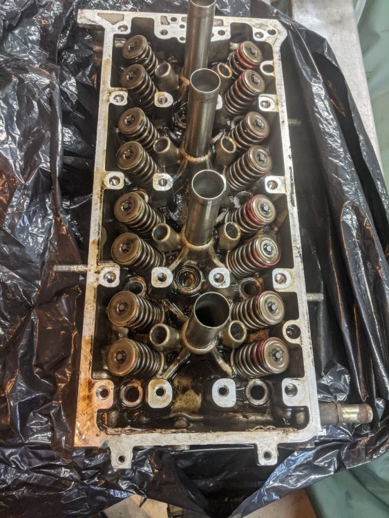

fastg Posted December 31, 2021 Author Posted December 31, 2021 The cams, springs, can chain and followers were installed. It only took about 3 1/2 hours. We used a 'wack it with a hanger' valve keeper tool, it worked perfectly much to our amazement. Forgot to buy a O ring for the front timing cover, so once that arrived the engine should be ready to reinstall. Graham
fastg Posted February 18, 2022 Author Posted February 18, 2022 Ready to go back in. The ATI damper is quite a lot smaller than the stock damper so I am going to have to research a new belt. Graham

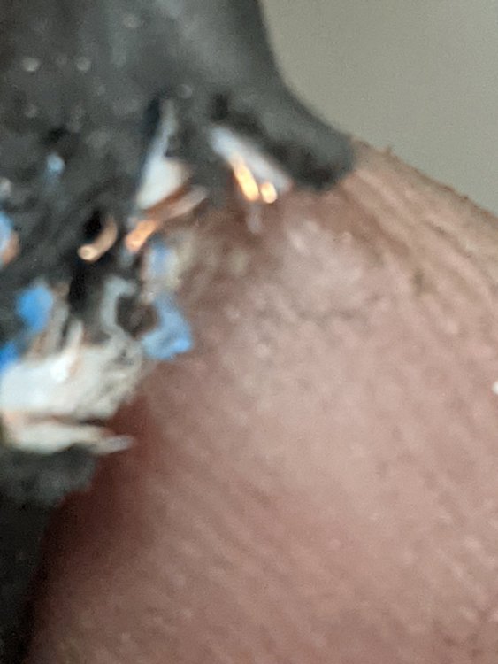

fastg Posted April 18, 2022 Author Posted April 18, 2022 We took out first test drive Saturday. Everything went perfectly apart from the speed display on the dash. The car is louder and definitely has an angrier disposition. The new 6 speed shifts very smoothly, but has a slightly longer throw than the 5 speed. The speed display issue proves Murphy is a evil bastard. I had removed the scuttle and disconnected all the wiring. The scuttle is one piece on a Locost so looking at the wiring is a neck twisting endeavor. But I could find nothing. So I changed my approach and started at the sensor end, Grrrrr, just were the cable goes around the upper control arm. All soldered back together and working perfectly now, but I will have to re-program the dash for a 6 speed trans. Well be booking a dyno session next week. Graham

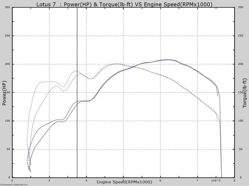

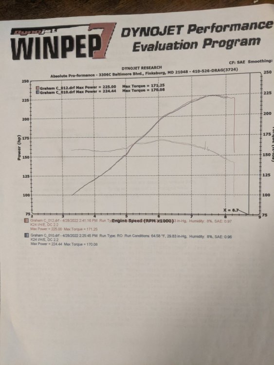

fastg Posted April 29, 2022 Author Posted April 29, 2022 When to Absolute Pro-formance yesterday, John the owner is a Honda guy, vast experience, many trophy's on the wall from drag racing. He spent 4 hours adjusting the car. 17 runs in all I think. He started by giving the car a detailed inspection, most of the specials/engine swaps he sees a total train wrecks, but mine got a passing grade:) A little background, the K24 setup is complicated. There is a fuel and ignition map for each 10 degree of cam angle, 0-50 degrees. There there is a complete set for Vtec high lift and low lift, a lot of maps. He spent 1/2 hour just smoothing out the maps because they were all over the place. Many runs, has to increase the fuel pressure as he were getting a little high on the injector duty cycle. We ended up a 225bhp, we did see a partial run at 227, the car was getting very heat soaked by the end, he is confident it would be 227-229 maybe touch 230 on a fresh run. But as you can see from my prior runs, more power everywhere, much smoother. Great torque curve, just starting to flatten off at the very top end.
Kitcat Posted April 29, 2022 Posted April 29, 2022 Hmmm, 75 more hp and 30 more lbs torque than my Zetec. Given the likely 10-15% drivetrain loss and those are big numbers.
fastg Posted April 29, 2022 Author Posted April 29, 2022 I guess there not big number, With a CNC ported head, Skunk2 inlet manifold, 90 mm throttle body, and Drag Cartel 4.4 cams 250-260 is the norm. I have the small port TSX head, the holy grail is the K20A2 large port head, with the same set 275 is the norm, all on a stock bottom end. You can guess what I am searching for:) Graham
JohnCh Posted April 29, 2022 Posted April 29, 2022 Wow, that's an impressive improvement, particularly over 6300 rpm. Do your driving impressions correlate with the dyno results? -John

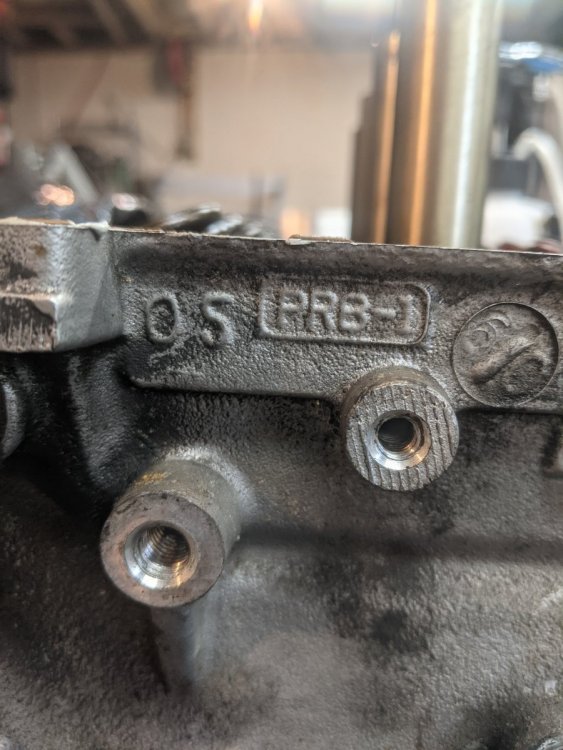

fastg Posted May 2, 2022 Author Posted May 2, 2022 Well Santa came a little early, but it looks like my winter project is already decided. The hold grail cylinder head for a K24 block is the large port K20A2 head off a Civic Type R or an Integra type S. I thought lets look in Craigslist, a trip to Reston VA and $200 secured a nice specimen. So I guess we are now on the hunt for 275bhp:) Graham
