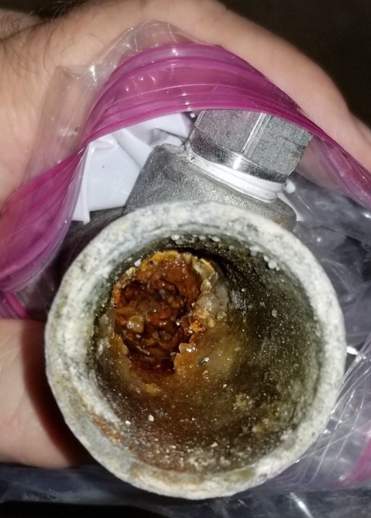

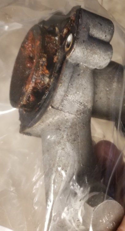

My input here is only to share that when I took my Xflow water pump off,  I found it to be 100% clogged with congealed goop.
If you haven't had the pump off and the cooling jacket flushed, might be the thing to do.
20220111_074933.thumb.jpg.99aa9eda52e42abafdc606b5f25b84ba.jpg20220111_075027.thumb.jpg.aba642083e1bd37b2aa5c642c3ea5670.jpg

ACK! Long life coolant strikes again!

Thats orange mixed with green then sitting for 9 years.
