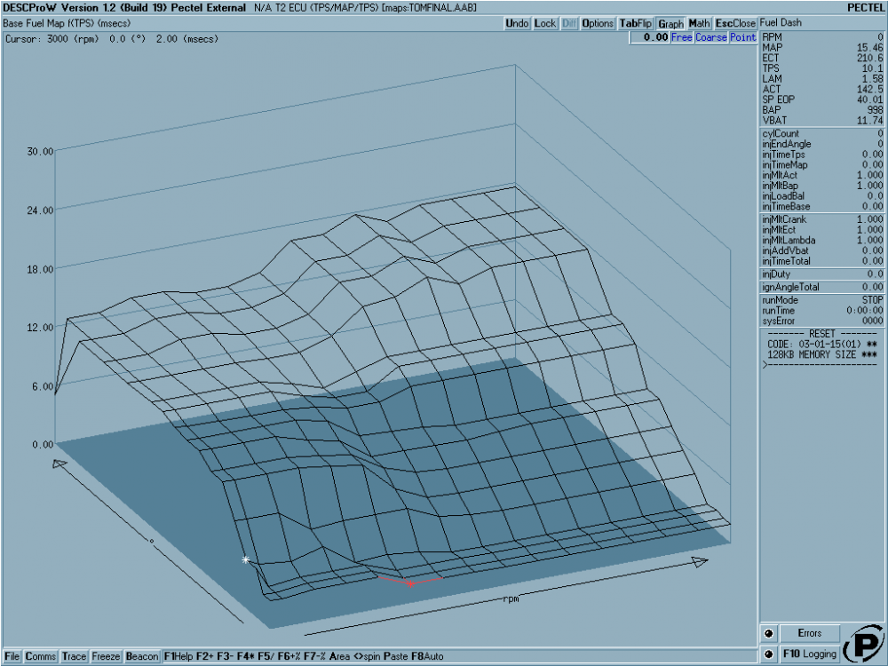

Vovchandr Posted August 6, 2022 Author Share Posted August 6, 2022 On 8/3/2022 at 5:02 PM, MV8 said: If the wording is greyed out and the "light" is black, you probably do not have the data logging software which is an add-on. What version of Desc PRO are you running? I guess you have an old XP laptop or running virtual? I was running a very old Win98 laptop until literally today I discovered that there is a version of DeskPro that works on my modern Win 10 laptop!!! Huge breakthrough. I can actually use a laptop that doesn't require to be constantly plugged into the wall in order to work Here is a map screen shot Only sensors on my ITB setup is TPS and IAT and it uses those two to run the car. My idle setting is a bit of a wild card. My car was build with ITB's and IAC, but that's very unusual. I'm not certain IAC has been working at all nor me or the tuner knew how to make it work so we just have idle set with a butterfly stop and no vacuum rail (all plugged). I'm fine without it but if ECU is still trying to hunt for IAC but we aren't using it, it could be a problem? I'll try to figure out ignition tables next. I know tuner had a hard time finding them and not sure if he ever did. Link to comment Share on other sites More sharing options...

MV8 Posted August 6, 2022 Share Posted August 6, 2022 I see you have all the normal sensors based on the upper right corner. IAC is more likely Intake Air Temp. You have only one map under the FILE tab when plugged in to the powered on ecu ("online")? Link to comment Share on other sites More sharing options...
MV8 Posted August 6, 2022 Share Posted August 6, 2022 I'd look for tables with kpa and rpm with timing or afr in the cells. Link to comment Share on other sites More sharing options...
ashyers Posted August 6, 2022 Share Posted August 6, 2022 Vovchander, Looks like progress! I'd suggest ditching the IAC, there's no need. I'm actually surprised someone took the time to hook a system up. The ports will be nice for balancing the throttles . To run this setup you primarily need RPM, TPS, and ECT. The remainder of sensors (ACT, BAP...) work to modify the values from the 3D fuel and timing maps. The fuel map will be a combo of RPM and TPS giving an output of ms of injection time. The ignition map is much the same but the output is in deg. of crank rotation at firing. I'm concerned about your idle setting. Think of the idle setting as the anchor point. If the idle setting is incorrect the entire map will be shifted and can lead to a bit of a mess. Some questions: Have you balanced the throttles? Do you know the intended value of the TPS at idle on your original map or current map? How did your tuner do the mapping? Did they run the engine at various loads and throttle openings or just do WOT acceleration runs? If you can post a screenshot of the fuel and ign. maps with the throttle at idle and the maps "live" that would be helpful as it will highlight where you're currently set. Andy 1 Link to comment Share on other sites More sharing options...

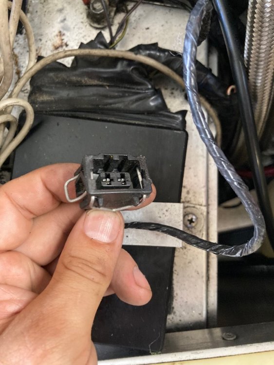

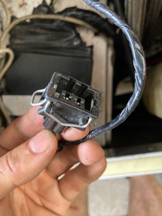

Vovchandr Posted August 21, 2022 Author Share Posted August 21, 2022 (edited) Still working on addressing pending issues. In meantime came across this. Can anybody explain to me what this plug is for?? Anybody with a Zetec or Pectel recognize it? Edited August 21, 2022 by Vovchandr Link to comment Share on other sites More sharing options...
