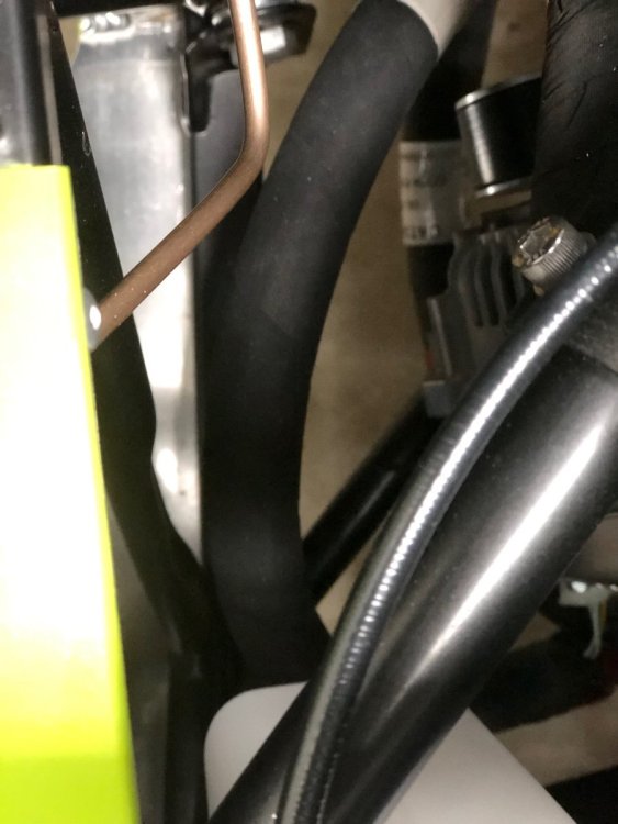

Routing it between the chassis tube and side skin is specific to the S3.  It is a fiddly fit on the SV - I remember a lot of swearing when I did mine -- but it will fit without rubbing.  If no one has a picture, I'll see if I can take one later.
-John

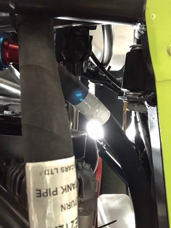

Here are two hastily taken photos to supplement those provided by Wallisek.  For reference, the first photo was taken with the phone on the ground looking up at the bottom of the chassis.  The top of the photo corresponds to the front of the car.  The second photo shows that same hose from above.  Although it doesn't look like it in the photos, there is clearance to the chassis tube.
Don't let the white plastic bottle at the bottom of each photo confuse you.  I mounted my windscreen washer bottle there to get it out of the way.
-John
Thanks much everyone for the pictures, I'll take some today, really surprised you have that much room to your alternator in the bottom picture. I'll try again!

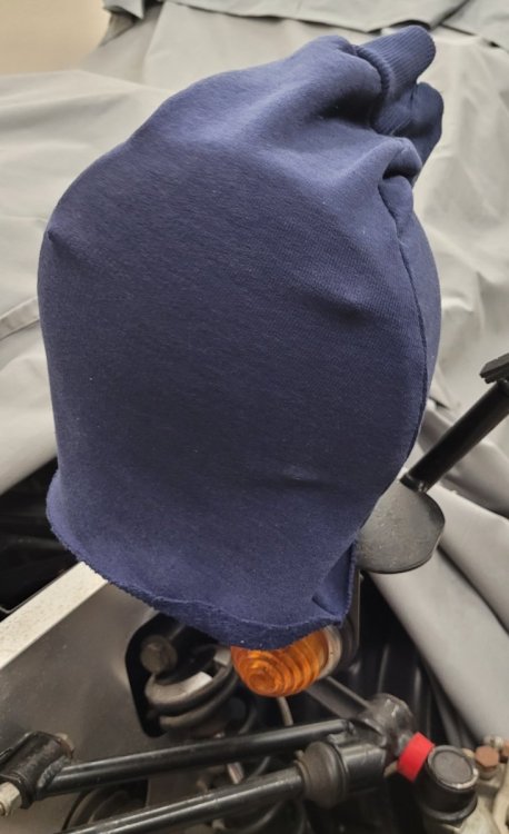

I have a suggestion..
Your lamps might get cold 🥶
Ha, the next time I'm getting rid of a sweat shirt I'll prep them for winter...
Ok overall a pretty good day - getting pretty close to mechanically complete - connected the prop shaft bolts, full exhaust, accelerator cable and started on the de dion tube, and time spent hunting for parts (and a run to Napa). After some more swearing I think I've gotten the final dry sump line locked in a position that won't hit the belt and alternator but it really seems like it is slight too short. Hoping to complete the rear end tomorrow.
It's to protect them from getting scratched.
Yes, sweat shirt sleeves work well.
Edited by IamScotticus
Ha, my brain was off getting headlight fluid :)
