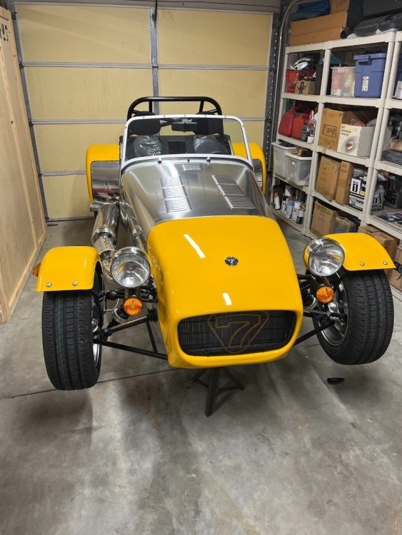

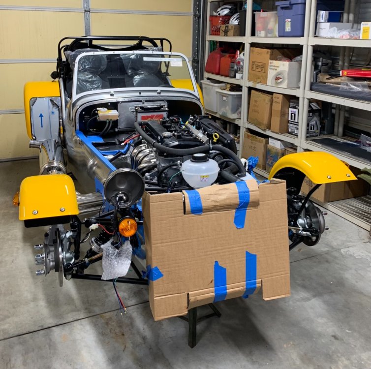

Headlights and front turn signals
Unfortunately, in the heat of the battle, I did not take pics of some key assembly steps and I apologize for that.  I know text alone is not the best way to communicate this kind of stuff.
The headlight and the turn signal "pod" share a hollow vertical stem that passes through the headlight stay and routes the wires through it.
To install the turn signal you first remove the lens, attach the base to the "pod" (a black plastic shell) and then reassemble the lens.  The pod mounts on the headlight stay under the headlight.
To install the headlight you first need to disassemble the reflector/glass unit from the housing, including disconnecting the clip holding the headlight bulb housing and pulling out the running light bulb housing.  I then installed the headlamp loosely on its stay on top of the turn signal pod, and threaded the ground wire from the turn signal pod through the hollow stem of the headlight into its housing and added it under the headlight ground screw.
Next pic:  Disassembled headlight and pod loosely on stay, with the turn signal ground threaded up into the headlight housing.  Next steps are tighten the turn signal ground ring to the headlight housing, install the bulb housings back into the reflector/glass unit and attach it to the housing.
Next I reconnected the bulb housings with their bulbs to the reflector/glass unit, threaded the bundle of 4 wires down the stem and reassembled the reflector/glass unit to the housing.  Then I threaded the bundle of 4 wires from the headlamp and the positive wire from the turn signal pod through the hole in the headlight stay and into the chassis.   Finally I tightened the single large mounting nut under the pod.  This nut gets loosened for aim adjustment.
Alignment of the headlights and pods on the stem is "infinite" -- it is up to the builder to align the pods straight, and to use headlight aiming equipment to fix the headlight horizontal and vertical angles.  The counter torque to the above mounting nut is your hand holding the headlight, and maybe your knees holding the pod from turning...
The electrical connection of the front lights to the chassis loom is made with a 6 spade "Econoseal" connector per side which you need to put together.
Each Econoseal connector combines 4 leads from the headlight (low, high, running and ground) and 1 each from the pod and wing repeater (turn signal positive wires).  Easier to assemble than I expected.  The 2 spades in the sub-loom on the left are the turn signal wires.  The insulating sleeves are not in their final position.
Secured the repeater wires with zip ties under the front tubes of the upper wishbones leaving sufficient loose length outboard to accommodate steering.
Next I added 1/2"" braided sleeve to the last ~6-8"" of the bundles near the connector (the edges look fraying but they are melted).
Finally I routed the lighting loom inside the chassis and connected and secured the assembled Econoseal connectors to the top chassis tubes.
Proper loom routing and securing is a key ingredient of the front lighting installation.  It is critical to first properly route and secure the repeater wire along the wishbone to keep it out of the way of things, yet allow enough slack for steering.  Only then you can finalize the routing and securing of the rest of the wires.
Cheers!

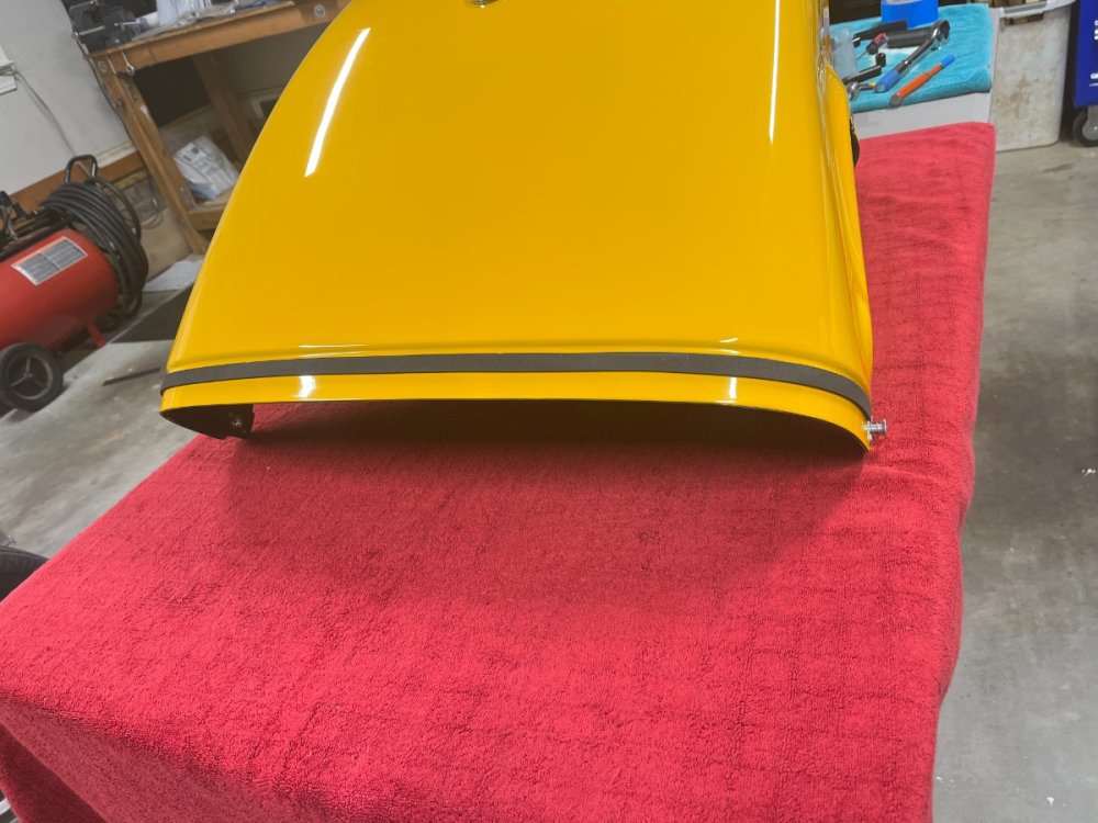

Bonnet
The only tedious part about this one is peeling off the blue protective film from the top surface.
Applied Amazon-sourced 1/2" x 1/8" high density black self adhesive foam strips (instead of the crap supplied in the kit) to the nose cone and the bonnet's long edges.
I found the best way to lay the bonnet down onto the car is to hold it on both sides in its target orientation (one arm stretched over it) and then lower the rear edge onto the scuttle.  Then, with the rear edge resting on the scuttle, move forward, grab the front side ends and pull them apart a bit to clear the nose cone as I lower them into position.  Obviously the nose cone needs to be secured in place before putting on the bonnet.
Clamping the bonnet down with the 4 latches is straightforward.  I am thinking of adding clear film on the skin behind the front ones to prevent scuffs.
8 October edit:
Had some leftover silicone hose I used for cushioning the front wings on their stays, and decided to try to use short pieces as body skin protectors over the springs of the bonnet front latches.  I may actually leave them on like this, or not.
Cheers!
