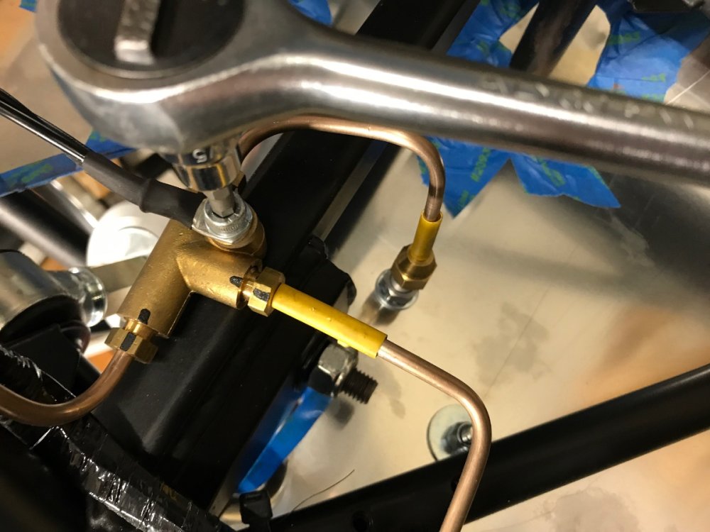

First just an obvious tip:  To make it easier to line up the fixed brake pipes with the braided hoses I removed the outermost zip ties tying the pipes to the chassis.  I also loosened the bolt holding the little brake line manifold to let it "find its place".  Tighten it back after "final" bending of the pipes and tightening of the fittings.

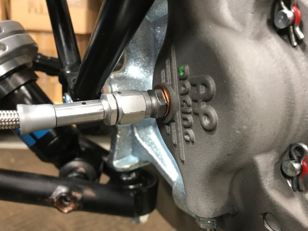

Yellowjacket has the standard brakes (remarkably fixed calipers nevertheless!); I found in my kit two pairs of slightly different brake hose/caliper "adaptors", both with apparently same thread types/sizes (don't ask me what they are):
I decided to use the gray ones as they leave a bit more thread length on either side after tightening.

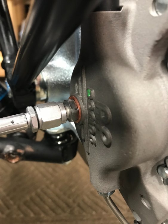

The real issue is with the copper washer between the "adaptor" and caliper.  The only pair that came with the kit does not work -- ID too big, OD too small.
I found a size that fits a bit better from my Amazon copper washer assortment on hand, but still not optimal (ID still a bit too big, and thickness smaller than the kit one).  See the initial eccentric position of the kit washer (before getting discarded) and dimensional comparison:

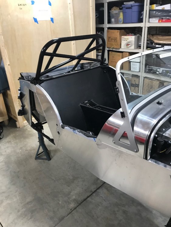

Track Day Roll-Over Bar:
Y'all know that the upper mount bolts of the rear suspension coil-overs need to come out to insert from below the bolts into the threaded boss of the main hoop.
That's part of the reason the roll bar went up now rather than after the rear suspension.  The other reason is that it provides a stable rear hoist point should I decide to move the entire incomplete car in the garage with the engine hoist and strap.
This went in remarkably easily.

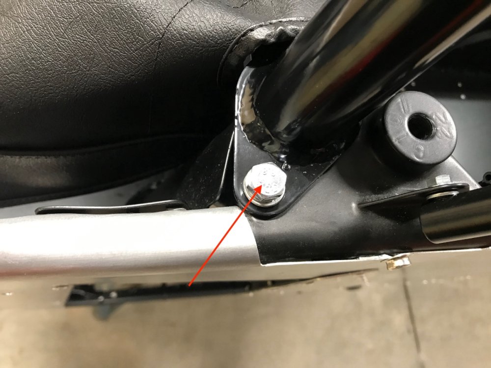

The overall dimensional control between the bar and the chassis (in my case) is actually remarkable.  But still, here is a lame tip I'm sure most of you figured out:  The thread in the boss at the bottom of the main hoop (which takes the bolt from below) may not quite line up with the hole in the chassis.  The solution is leverage it to line up by a conical punch from underneath while tightening the smaller flange bolt (see arrow).  It will hold the boss aligned and ready for its bolt.

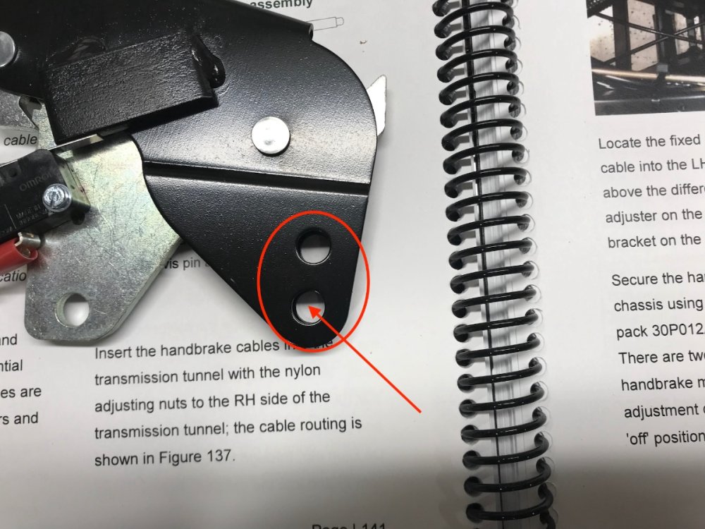

Handbrake Lever Assembly:
Inserting the two bolts and nuts to secure the lever base/bracket to the tunnel (rearmost couple barely visible at left edge of pic) is a Royal PIA.  Make sure to have a few first aid bandaids handy and the garage radio turned up loud.  After a bloody fight to insert the bolts, I got each to bite into the nut by holding the nut in vise grips and loosely dangling it to line up with the bolt axis...  A diabolical design.  I suspect there are cleverer ways to perform this...
But here is something that left me speechless:  We all recall Sir Colin's decree "No Washer Shall Get A Free Ride", right?
Well, I counted 7 (!) washers between the two clevis pins!  And clearly that is only because the pins themselves are too long, which compounds gravely the weight penalty. Truly shocking.
By the way, my handbrake lever has 2 clevis pin holes, which I hadn't found mentioned anywhere.  The advice from Denver is to use the bottom one (quicker action).  I suspect the top one is to add lightness...

The sealing washer won't have a close fit to the fitting since it necks down in the seal seat area. It looks like the copper washer spec'd by AP is 14.2x10.2x2.0mm but the amazon washer should be fine. AP adapter fitting CP-2554-108, M10-1.0 flat seal to 3/8-24UNF 37deg.

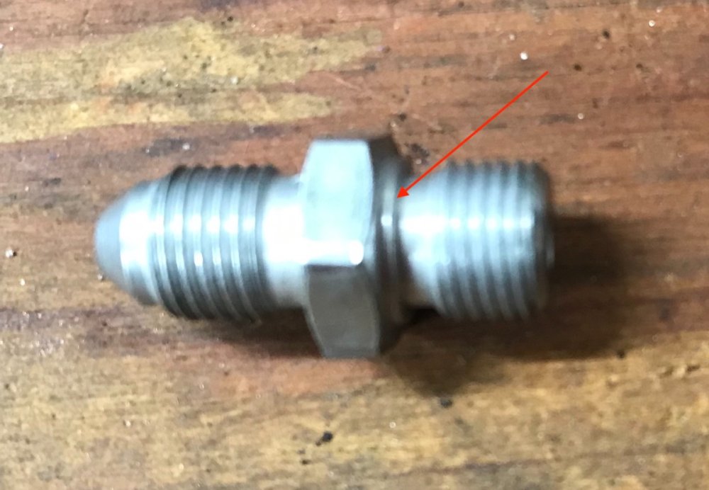

I looked into this some more, following a key pointer from Josh Robbins. The fitting has a small "ridge" on the caliper side between the hex and the neck-down - sorry for the crappy pic. The ridge is supposed to locate the ID of the washer. I measured the diameter of the ridge and it is just about 10.0 mm even.  The Amazon washer ID is 10.2 mm, same as the AP one.
So... I disassembled both sides and installed carefully a new Amazon washer on each side making sure it is concentric around the ridge.  They fit perfectly and sit flat between the hex and the caliper, so the problem is solved.  I don't like the 1 mm thickness of the Amazon washer but the height of the ridge is about 0.5 mm or less, so it does not "short" the washer.  I will try though to get hold of the AP washers.
