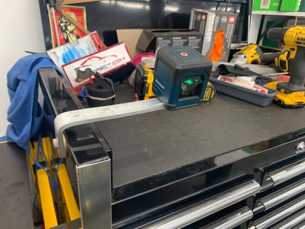

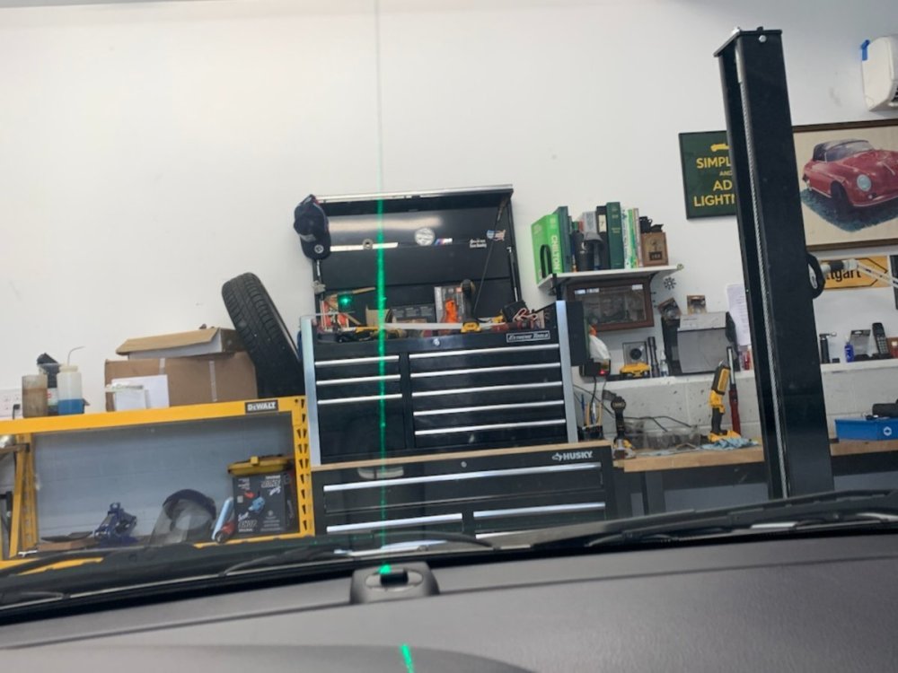

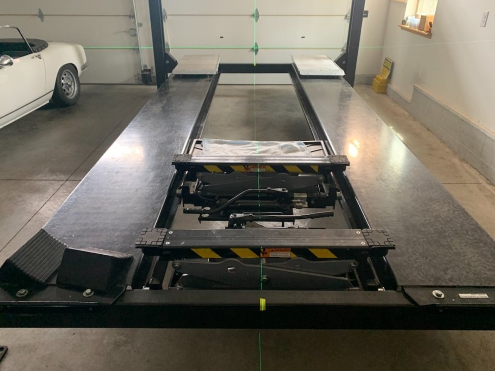

One of the fun parts of having a little car (or two!) and a 4-post lift is that the little car is "width challenged" relative to the ramp spacing. The Se7en isn't too bad because I can lean over and watch the front tire roll on. The Elan however does not allow me to do the same, plus the track is narrower than the Caterham. I have about 2" to spare on each side. So I came up with a solution. I purchased an inexpensive 2-axis laser level and aligned it's vertical output with the center of the lift. Now when I drive up I can line the green light up with the center of the car and just drive on. Saves a ton of back/forth fiddling.
Here's the laser in its final resting place, bolted to my toolbox.

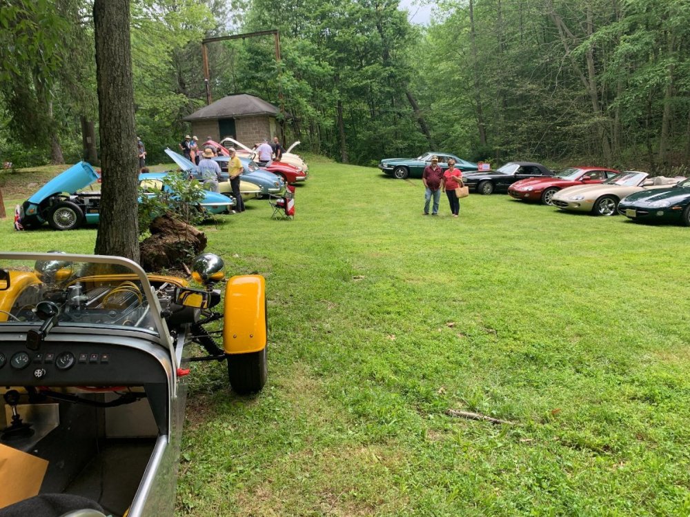

The little bumblebee garnered a moderate amount of attention. People seemed to particularly like gawking at the engine.

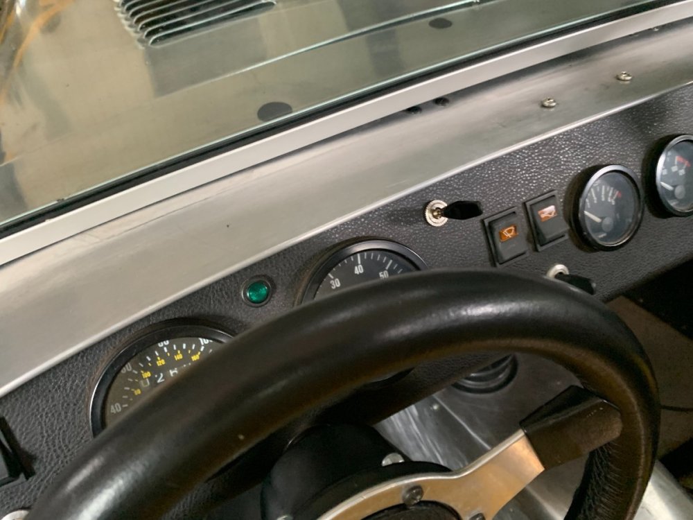

At the last gathering I attended, the horns decided to start working independently of any outward impetus, and continued blaring until they fried the relay (as I later discovered). It was mildly embarrassing to say the least. So I finally gave up on trying to make the horn button behave and installed a momentary toggle switch next to the steering wheel, where I can reach out my index finger and give it a tug. I think it looks appropriate.

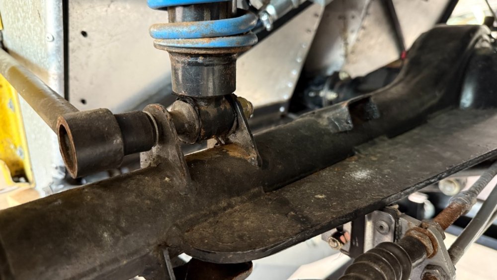

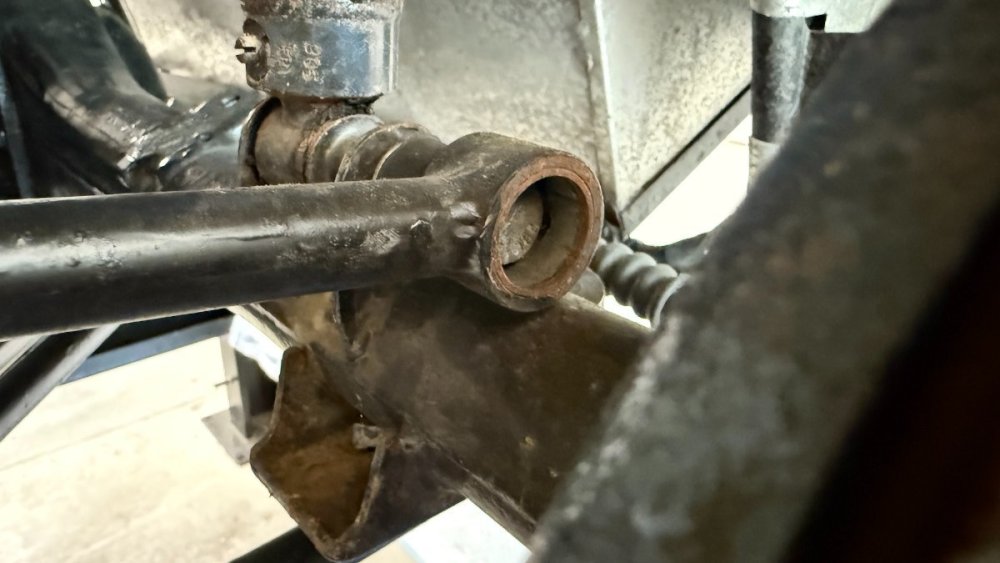

On a shakedown romp to test the refreshed connections I heard sounds in the rear that gave me the impression something was loose. So I climbed underneath with a handful of wrenches, and found this.
At first I thought the bolt had broken but it had not. There was a small washer on the outside, under the bolt head, and the suspension arm just walked itself right over it. As the pictures show it was on the brink of coming all the way off, which would have been -- exciting. I put large washers on both sides so that it can't happen again. Boy oh boy do I need to refresh the rubber bits under this car.
