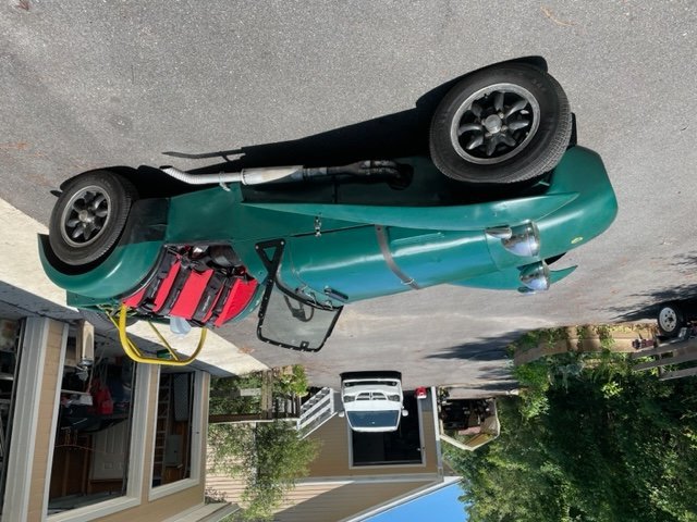

Timothy Keith-Lucas Posted May 27 Author Share Posted May 27 Yep. Beginner, but learning with your help. AWWWLLRRRIGGHT!! New paint, rough like the original. Replaced the generator with an alternator, 14.45 V at idle speed - now I can ride with my headlights on. New leather straps, new red slip covers over the 1962 upholstery. Soaked the cooling system in vinegar for 24 hours. Extended the roll bar to cover both seats. Annnndd, mysteriously, she now idles where she should. It's a gorgeous 75 degree sunny day in north Florida, and I'm going for a ride. I'm sorry, but I can't figure out how to flip the photo. I even tried flipping the file before , and it still puts it in upside down. Link to comment Share on other sites More sharing options...
