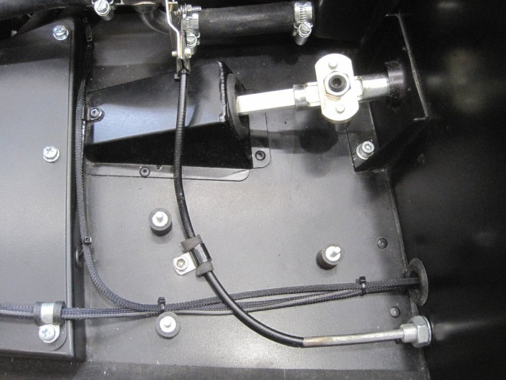

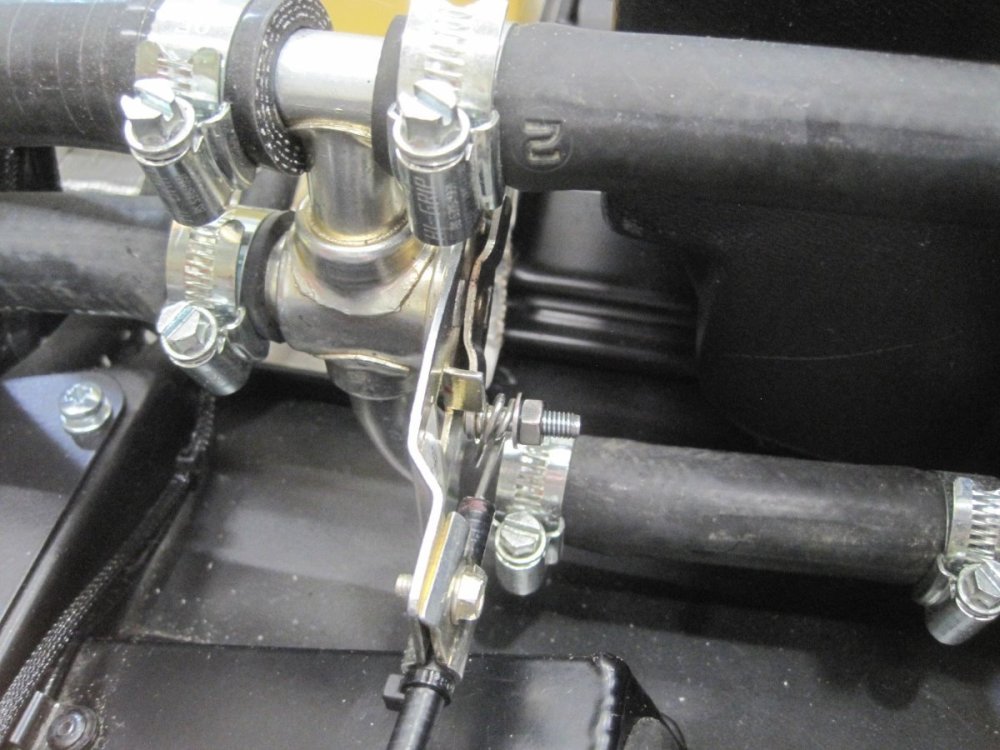

Just added photos to date to my album and updated the thread.  Here are 2 more photos of something that has us stuck and we've moved on for now.  Heater cable.  Manual is designed for RHD so shows a clip and cable wrapping around the heater.  On LHD cable is super long and no way to attach.  Leave it like this? It appears to work.large.IMG_4140.jpg.86a2b813a76df77c2abad362d3d33869.jpglarge.IMG_4142.jpg.15bb9bb775af0b857f92e24edf3f0582.jpg

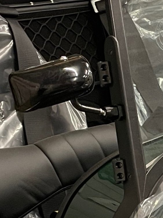

Good call on the convex.
My CF ones barely have any curve to them and I'm not particularly happy with the "upgrade"
The heater cable is the minimum acceptable length for this arrangement. The valve end should be above the control end to minimize the bends/friction.

I went with the dpr mirrors.
the non carbon ones were £45 a piece. Greg at time machines had a few of the car covers
https://parts.dpr-motorsport.com/contents/en-uk/d24.html#p85
not sure if they have any more in stock.
I didn't realize DPR mirrors came with their nuts ready to attach. I thought I had to buy their adapters and spa mirror separately!  Thanks for helping me figure that out!
Sorry - don't follow.  Are you saying that the way I have it is correct?  If not, please clarify.  Thanks!
No, loop over to reach the valve, not under.
Oh - so keep valve per the instructions and loop the cable. Gotcha!  Thanks!
Nothing against Budlite's mod. Many ways to do anything well.
