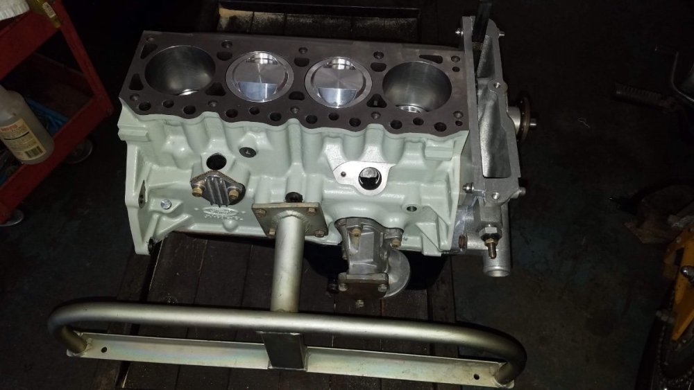

EdWills Posted July 11, 2024 Posted July 11, 2024 Hi Tem. On my Lotus factory built 1969 Lotus Seven Series 3 (originally painted in the really great looking metallic blue as on your car), the 2737E pre-uprated head, block, bell-housing and rear axle were all semi gloss or flat black. The 116E gearbox case and tail shaft were what may be described as 'Brunswick Green'. In a Lotus Seven Portfolio booklet that I have, a gent in the U.K. rebuilt a 1965 Series 2 Seven, and in his research he found that the engine block and head were originally 'Lotus Grey', the bell-housing was black, and the gearbox and tail shaft were Brunswick Green. Cheers, W. 1
