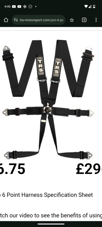

So far TRS is front runner at this moment for just easy bolt in solution

Thank you. I see many TRS on there too. None with right base plates.
I learned yesterday that almost every manufacturer can modify a model to your fit if you don't see it offered in a model with right baseplates or lengths etc.
Currently waiting on a quote for a TRS with right base plates, colors and lengths.
