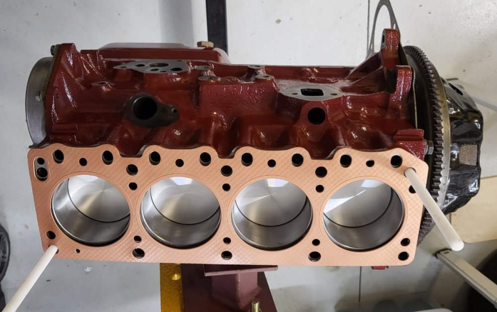

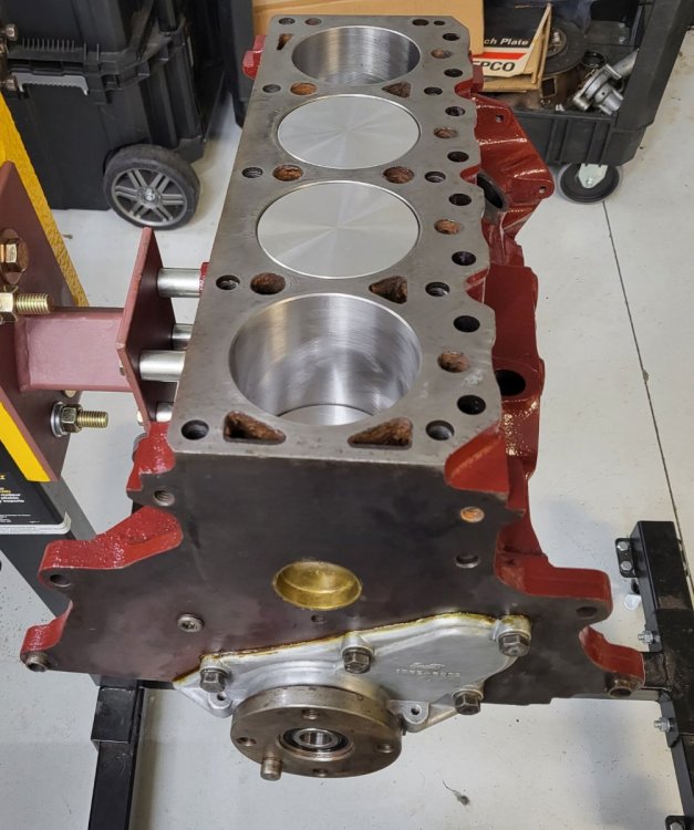

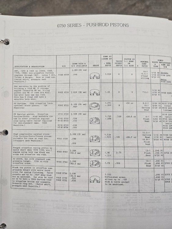

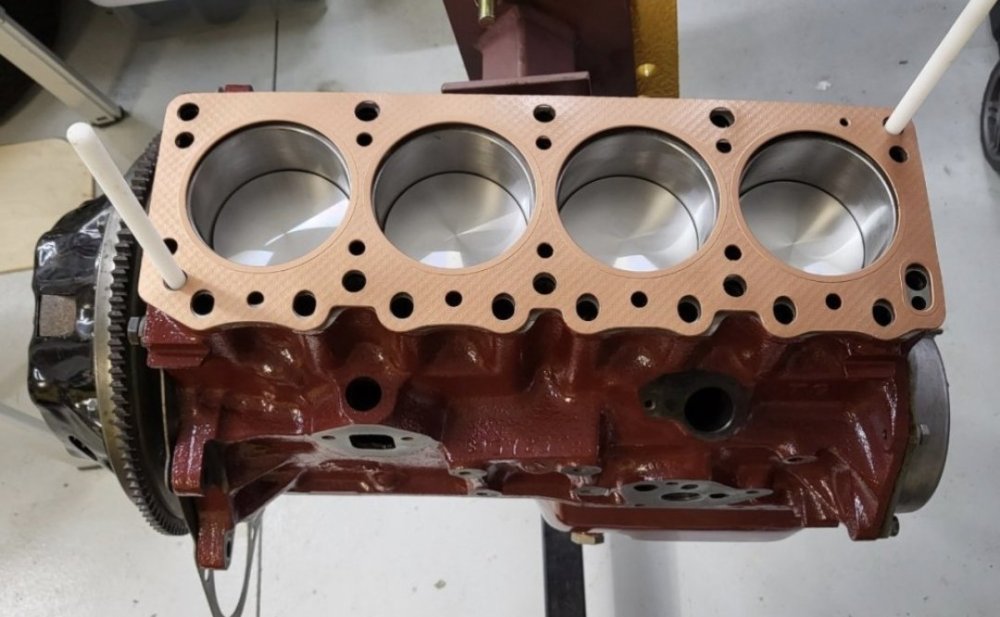

TEM Posted July 24, 2024 Author Posted July 24, 2024 Measured the all the bits and there is indeed a potential 0.03" interference between the spark plugs and pistons. It was interesting to learn that the threads start at different locations on both the spark plugs and the head. So, you get a very random orientation of the electrode. The 0.03" interference can be obtained by mixing and matching the plugs and holes to get an electrode into the most disadvantaged position. I had two 9/16" spacers of different thicknesses and the thicker one eliminated the interference, giving 0.005" of clearance. I was wondering how this could have happened if the spark plugs are correct. I have noted in many documents a reference to flat top pistons on these early Sevens and the few picture I could find seem to show a flat type of piston. But, if you look at my pictures, my pistons have a "D" shape protrusion on the top. Is it possible these pistons were replaced with "taller" pistons? There are very few picture out there to go by.
MV8 Posted July 24, 2024 Posted July 24, 2024 There are often many variables on performance replacement pistons including crown height from the top ring groove (most engines don't run zero deck height) and shape, domed and dished, valve relief notches for high lift and overlap cams, etc. Indexing the plug is not normally for critical clearance. If you use washers, I suggest making them all the same thickness based on worst case. Otherwise, anybody that changes the plugs should have a great memory. I would use the clay to see where the problem is with each piston at tdc or slowly turn a sacrificial plug in to score the piston, cover the deck openings to oil and coolant jacket, then use a ball or tree shaped, bastard cut carbide mill bit in a drill to dress the scored area, apply a little clay and recheck. A dremel works too. The pressed clay can be cut in half with a razor and one half removed to reveal the clearance. Fit the longest plug with the deepest seat, worst tip index, on the highest piston (i.e. worst case), make that fit and have .050" clearance, then duplicate that cavity on the others before checking actual clearance. Minor differences in the cavity size and depth are not critical to compression ratio. Radius the edges to blend into the piston without sharp edges. Ditto on ARP. Rolled thread studs are best or cap screws and washers to spread the load (heads are smaller) can substitute for oem head bolts (though some come original with socket head cap screws). Studs should be tight enough in the block that combined with red loctite, won't rotated when the nut and washer is torqued, but ideally, the studs would be finger tight in the block, not torqued to a head bolt spec.

TEM Posted July 24, 2024 Author Posted July 24, 2024 I understand that there are a lot of replacement piston profiles out there, my question was what was original? I have found very few non-original parts on this car so different pistons would be worth noting. Were the pistons changed or did someone over skim the block and head? No problems, just knowledge. Yes, I plan to use the same size spacer on all plugs.
