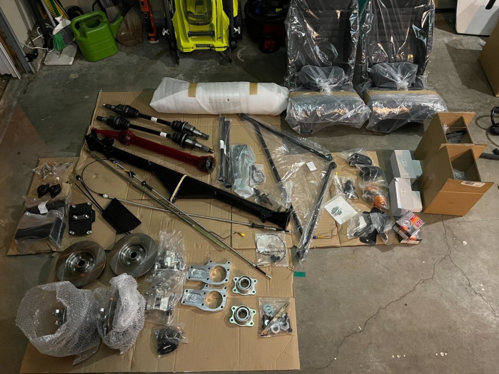

Kit delivery day! Just like Christmas, but with more crates and cardboard boxes.
After getting enough of the boxes unpacked, I spread out all the parts on the floor of the garage. This was mostly for fun, but also to get acquainted with all the parts in person. Feels a little like meeting a celebrity; I've seen these parts so much in pictures from other builds, but now they are here!
Tomorrow I hope to shelve and store the parts and maybe add one to the chassis :D

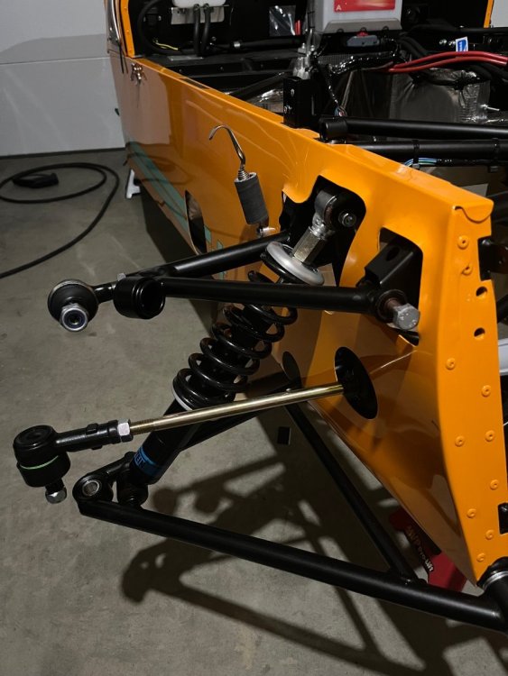

First day of building update. Not news, but the front end bolt placement is really as bad as everyone says it is. Fun tip, the Caterham Car boxes are a good size to support the lower arms.IMG_1177.thumb.jpeg.6a72a17fa36d3b111013c1aeaccea14c.jpegIMG_1176.thumb.jpeg.ace756f317e7b541d056a53e7a4d9a45.jpeg
Well, I made my first (known) mistake. I missed the wide track bushes on the upright install on the first side because I didn’t know the SV was automatically a wide track. Had to rent a puller as I got the force mate really far on there. Paused my front end progress, so I took the time to install the heater. Picture update with them  corrected!

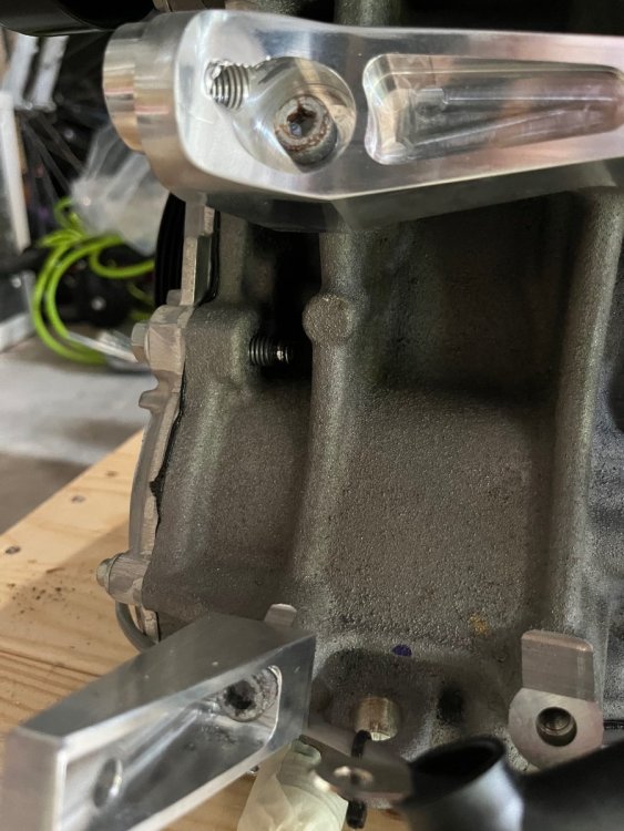

And… first big concern of the build. After removing the starter, I could see rust on the flywheel teeth. With the bell housing off, it’s on every tooth. How much of a concern is this for the car?IMG_1200.thumb.jpeg.1c9c1f042d77d11ebff1443bbfc85c7b.jpeg
 Secondary, there are two fitting bolts and one alternator bolt that have lots of rust. Thinking about swapping them. Are they grounding fasteners or something?

Don’t have insights on fly wheel rust for operation. Since my car was new in June I have been tackling some surface rust issues.  My coil cover bolts looked similar to your alternator. I replaced them.

 The really odd thing is that everything is brand new. And just those three bolts have rust. I’ll get over it and buy some replacement bolts.

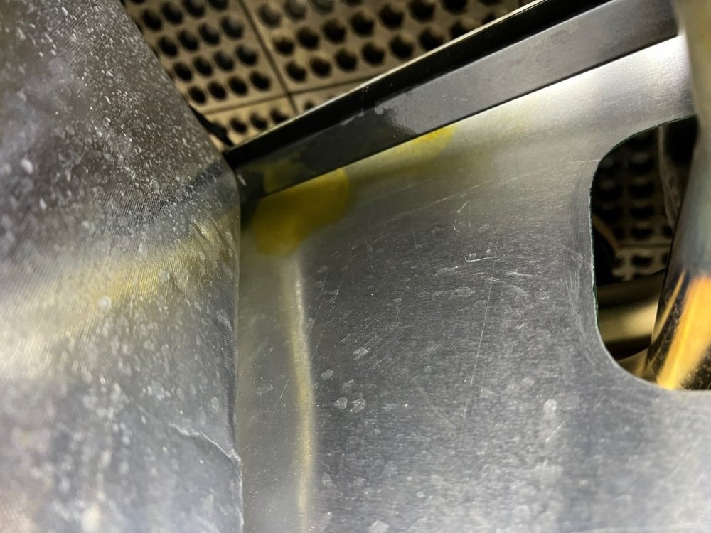

It looks like you also received the no cost rust option.  I'm pretty sure Caterham views this as added character.  As per the photo below, my engine came with rust on the clutch, pressure plate, and a portion of the flywheel (look closely at the bottom of the photo.)
My 2021 order came with a new motor dated 2017.  A 420 would be fresher but these just don't sell that fast.  I too had some funny rust I wasn't expecting... After a few miles and rainstorms it seemed to matter less...

Most non-oem mfg parts or replacement parts do not offer any rust protection or if painted, not the highest quality. Socket head screws are normally black oxide coated which is not much better than bare. Those look bare. I'd use a bench grinder with a wire wheel to clean up the fasteners and flywheel teeth, then rustoleum rattle can satin clear most everything (including the pressure plate). Potential overspray is not an issue and the paint fills the metal surface so dirt clean up is easier.
If I pre-treat, metal prep sold at Home Depot in gallons is mixed 2 or 3 parts water to prep (phosphorus) in a universal pump bottle. May take a couple light sprays over a couple days for the rust to go away. I let it dry and spray.

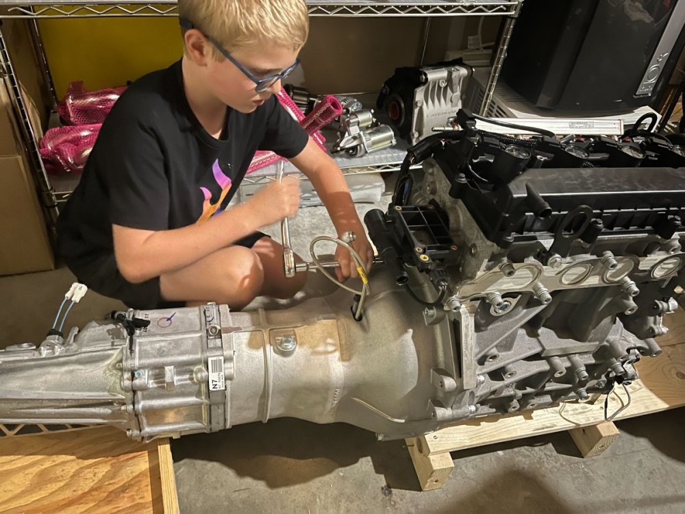

I like the child labor. Sorry I cant offer much technical expertise. But my 420R was just completed (factory built as I dont have the space). Happy to poke around and take any photos of how mine was put together (60% sure its correct).
