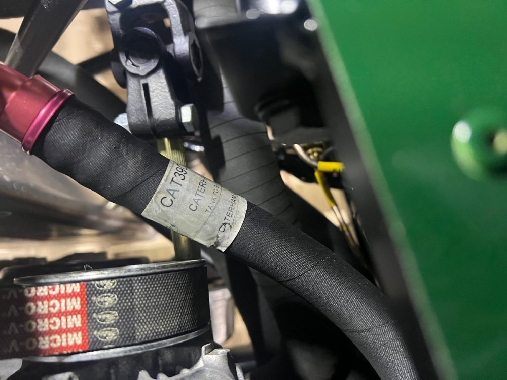

CBuff Posted November 4, 2024 Share Posted November 4, 2024 I just noticed today that my oil supply line (from base of dry sump tank) was just barely touching my alternator pulley. Some pulling and moving and added some zip ties to it cleared before after my radiator fan plug runs around the passenger side and thru the bracket. It’s running along the radiator but hasn’t seemed to cause any issues. It did unplug Itself in the beginning since the wires were zip tied tight to the cross brace and had no slack between chassis and the radiator (which moves slightly on the rubber mounts). I created some slack and zip tied the connector together 1 Link to comment Share on other sites More sharing options...

JohnCh Posted November 5, 2024 Share Posted November 5, 2024 @CBuff if the wires are under enough tension that a zip tie is required to keep the connector together, I'd be concerned a wire to pin connection could fail over time or a pin could back out of the connector. Running the wire from the driver's side frees up a lot slack in the wiring loom. Link to comment Share on other sites More sharing options...
CBuff Posted November 5, 2024 Share Posted November 5, 2024 Yes. I had the same concern. I clipped some of the zip ties and created “some “ slack. Not a ton but some. Maybe a winter project to flip it. Nice to know there is a relative easy solution. Interesting that caterham wouldn’t do this from the factory. But that seems par for the course with caterham. Link to comment Share on other sites More sharing options...
