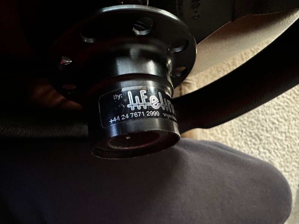

32eachtime Posted October 25, 2024 Posted October 25, 2024 I need help finding the correct Lifeline quick release steering wheel adapter for my 2006 Caterham 7. I’m setting up an alternate wheel from the Momo. The Lifeline quick release adapter that’s on the car with the Momo wheel has no numbers for reference. The current adapter is a 3 hole version. Thoughts on this please. Thanks for your help! John
JohnCh Posted October 25, 2024 Posted October 25, 2024 I'd ping Lifeline USA to confirm that their current 3-hole adapter will still fit your setup. Their phone number is in the upper right corner of the page: https://www.lifeline-fire.com/lifelineformulacarweld-onquickreleasesteeringadapter.aspx
MV8 Posted October 25, 2024 Posted October 25, 2024 Ditto. It sounds like you need a momo six hole "touring weld-on" adapter and have the three hole "formula weld-on". I expect the only difference is the hub pattern with the same weld-on shaft for both.

32eachtime Posted October 28, 2024 Author Posted October 28, 2024 On 10/25/2024 at 11:42 AM, JohnCh said: I'd ping Lifeline USA to confirm that their current 3-hole adapter will still fit your setup. Their phone number is in the upper right corner of the page: https://www.lifeline-fire.com/lifelineformulacarweld-onquickreleasesteeringadapter.aspx Called Lifeline this morning, had a great and informative conversation with them and the unit is on the way already! Thanks for the help! John 1
32eachtime Posted November 9, 2024 Author Posted November 9, 2024 So I did contact Lifeline…easy to discuss and had the proper quick release adapter in 4 days. Awesome service! Thanks for the advice! 1
