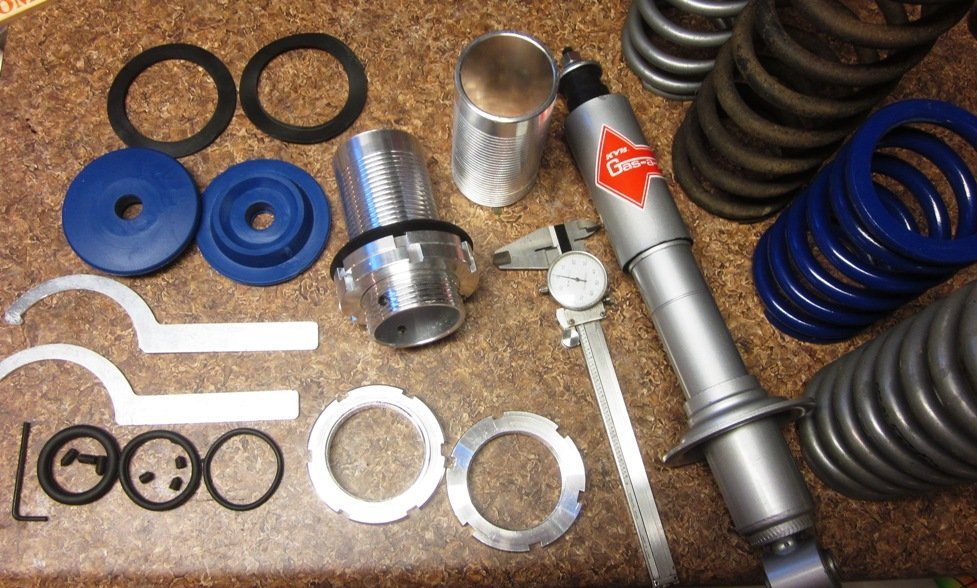

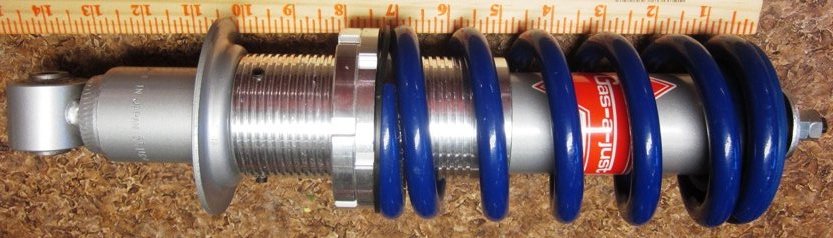

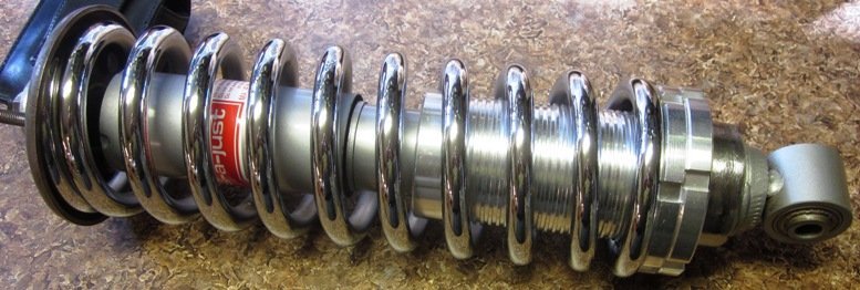

MV8 Posted March 6, 2025 Posted March 6, 2025 Here is another: https://www.speedwaymotors.com/Bilstein-B4-BOA-0000187-Small-Body-Steel-Coilover-Kit,6871.html?utm_medium=CSEGoogle&utm_source=CSE&utm_campaign=CSEGOOGLE&gad_source=5&gclid=EAIaIQobChMIzOehs7b1iwMVZoFaBR1TJjGXEAQYAiABEgL0E_D_BwE Besides the damper body od, the internal step in the sleeve id versus the metal ring or shoulder on the body will need to be assessed and possibly a simple ring made to increase the body register. A non-adjustable option is to machine a 3/8-1/2 inch thick or so shim seat for a little more clearance. Can be made from aluminum or hard plastic like uhmw rod stock.
Reiver Posted March 6, 2025 Author Posted March 6, 2025 MV8, those should work fine as the measurements match the present Billsteins I have.
MV8 Posted March 7, 2025 Posted March 7, 2025 FWIW, if there is any confusion about fitting, let me know. I adapted a universal coilover kit for a honda to sptifire dampers with a fabbed adapter to use standard springs. Included springs but I just wanted the seats as the springs were far too stiff and short.
