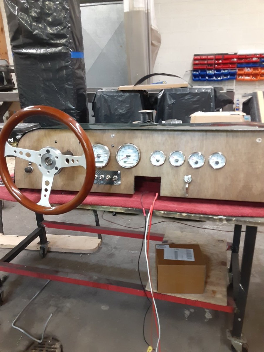

Alex-Ks1 Posted August 1, 2025 Posted August 1, 2025 for what it's worth . When I built my 7 ,service was #1 with me , . I built the dash assembly off the car, all the electrical was with 4 disconnect plugs ,1 bolt for steering , 6 ,1/4 inch pop rivets ,3 on each side holding it to the body . It was even painted before I installed it If I ever have to pull the engine ,trans, take off the dash, 10 minutes . Then unbolt the engine and if comes out with out lifting the car .Every bolt is easy to get to and no ultra tight fitting
